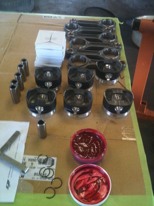

I doubt ill make your power levels but i should make the top 5 in the USA (for now) and top 10 in the world:
CP .020 coated pistons
Crower rods
OEM crank
OEM main caps
TMS v2 race head
BC 272 cams
COMP oiless GT43 74/79 .96 a/r
KSR FFIM
KSR 90MM TB
mishimoto R-line IC
3" IC piping
tial 50MM BOV
tial 46MM WG
3.5" exhaust through BIC catback
RC 1200
dual walbro 400
10 AN lines
LIPP dual 6 AN rail
E85
supported by:
crawler R154
DM 3.5 in. Driveshaft w/ 1350 U-Joints
Weir diff
SPEC twin disk SS trim
so on Friday when Serious HP dyno's my car im thinking (and hoping) to take the #2 spot behind tony until you and Steven finish which pushes me to #4 or 5 if you count North America as a whole...this is of course assuming Nate and DLT havent changed setups.

One thing that is going to limit the power you make is the size of your injectors if you plan on making 1000hp plus on e85 your going to need bigger injectors plus you'll need to add or upgrade your fuel pumps. Also I hope your are running larger wrist pins the standard .150 pins are rated at 750hp at the flywheel according to cp. I look forward to seeing your dyno sheet just don't get in a rush to make big power it usually doesn't end well. Good luck

I hate to say it but it looks like you have the standard pins. I think cp is being conservative with there ratings but I wouldn't push more than 750rwhp on a regular basis with those pins severals guys have destroyed there motors with the standard pins at the 850rwhp level and others have run up to 800rwhp with no problems I guess it's just a judgement call on how far you are willing to push limits.

This is the part number 866-2250-20CP3C for the ones I'm running cp rates them 1100 hp at the flywheel. I Had my motor completely built with the standard pins and had to take it back apart
just to change the pins luckily it wasn't in the car yet. I was on the fence about changing them but I have so much money tide up in the engine I would hate to break a pin. you'll probably be ok just don't push it to far. Let us know how you do on dyno day.

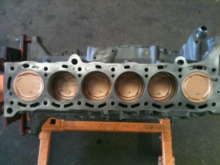

din904;1992904 said:
This is the part number 866-2250-20CP3C. you'll probably be ok just don't push it to far. Let us know how you do on dyno day.
Are you .020 over as well? If so then it should be the exact same for me. I'm not sure if the coating will matter also. I will be changing them later this year so i will just have them de-tune to around 750 whp. Thank you for mentioning them you literally just saved my engine most likely.

Yes my piston are .020 over. Size or coating does not matter same pin for all of them including cp 2jzgte pistons. Just be carful at the track running high boost and launching hard and reving high that's where you experience high loads I won't mention detonation that shouldn't happen with a good tune. I hope everything turns out well for you!
