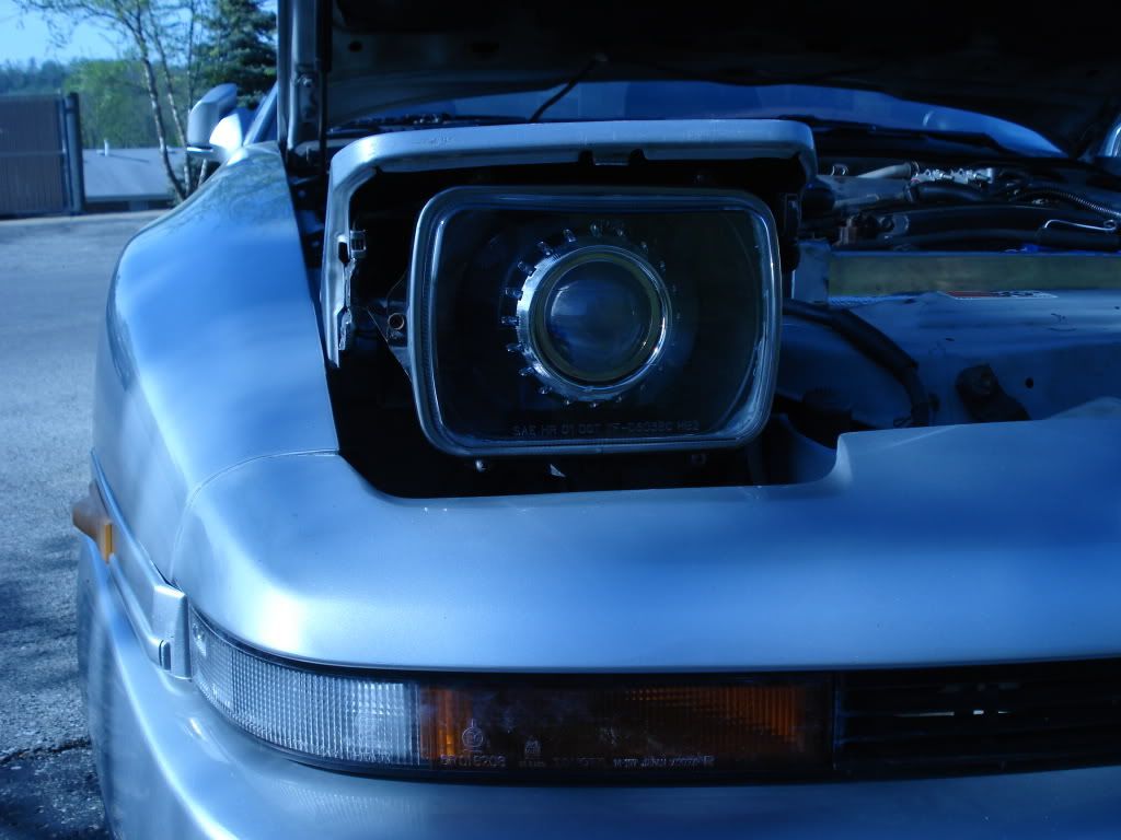

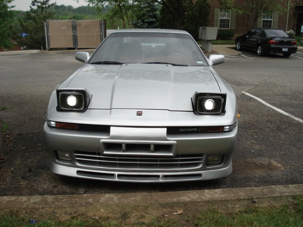

what is the big box glare right in the dead center of every picture about 3 feet in height right on the slope of the cutoff? I thought it was your camera but every camera shot has it so it is an issue with the light pattern being ass.

You need to do a custom True HID Housing retroFit. Been running this set up for almost 2yrs. This is how mine turned out.

super.secret.supra.club;1578158 said:
squirrel finder. it helps to illuminate road signs. a lot of people cover that because it looks better but i need it since its a daily/nightly driver.

Thanks poodles. Squirrel finders were not made into every projector housing. I don't have the specifics on which ones do and which ones don't but if you google "squirrel finders" you'll find a lot of up close photos of how they cover them up and even make the cut off straight instead of having a slope

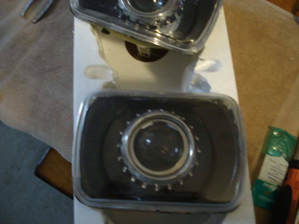

Sorry I dont have a wright up. Its a custom set up I did myself. I used Pilot H4 Housings , TSX clear lens Projectors, Lexus Shroud,Mitsu ballast & D2s bulbs. I researched HID Planet & this forum on how to do this.
