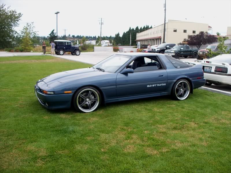

Turbo replaced...No leaks (so far), and most importantly, no smoke !!! Yessssssss
Snapped a quick pic... Sitting in the yard while his parking spot was being graded for new pea gravel in his new space... He was rewarded for his patience...lol

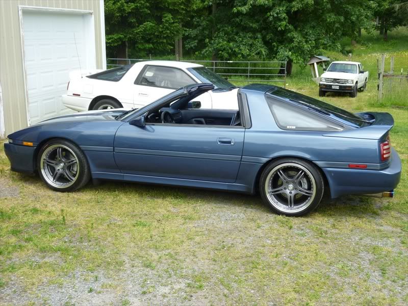

Custom decals made by a friend in NY that makes reproduction decals for vehicles as a hobby. He wanted to do something "Original but not original" for a Supra, I decided to be a guinea pig...
I'll roll with them for a while, I kinda like them. Looks real good in person...

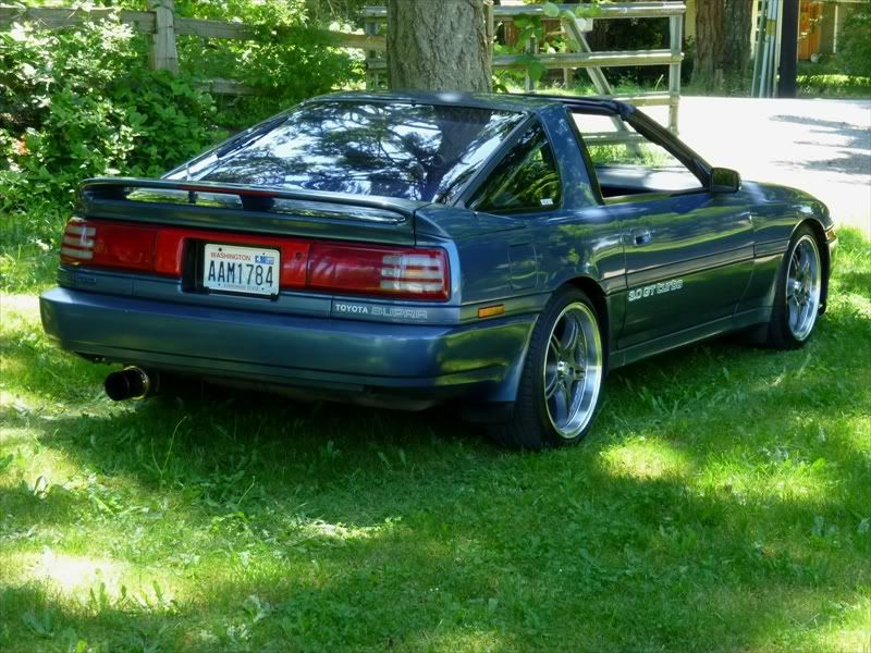

bluemkiii;1731107 said:
great job on the car so far, looks gorgeous! Did you end up getting different springs for the front?
Thanks a ton !!!
I did switch back to the H&R's after the DropZone flop.
Got an idea from a friend that works at an Audi dealership. On the Quattro cars, the have a strut tower "stiffener" that runs on the underside between the upper strut bushing and bottom of the body mount. We fabbed up a pair with the same dimensions to bolt up to the Supra bolt openings, and it gave me about 1/4" raise in the front... Took care of the rubbing and the rake all at the same time !!!

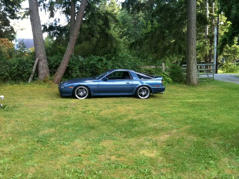

dmp316;1731125 said:
Nice choice with the wheels. What kind are those? Loving the car man good job.
Sent from my SAMSUNG-SGH-I897 using Tapatalk
Thanks Much !!!
They are ADR Battle Exe's 18x8.5 +35 w/225-40's in front, 18x9.5 +35 w/255-35's out back...

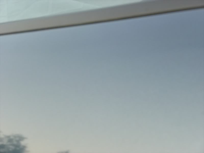

Headin back from work the other day, I heard a big CRACK while driving down the road. I looked around to see what was up, I saw nothing. I took a quick look out my driver mirror, and saw this..... UGH....
Big nasty ding right under the window molding on my door... I was pissed, as you might think...
Back in the days when I was in the auto glass biz, we called on a company called Same Day Scratch & Dent to fix some bo-bo's We'd have when knives broke and stuff. Sure enough, the guy who was doing this for us 10+ years ago was still doing it !!!
A couple hours and a couple hundred bucks later, this is what it looked like...
You really have to look hard to see it, Cameron did a fantastic job !!! He also fixed a couple other small dings I had for no charge !!! I talked to my Insurance Company and they are going to kick back a little of the repair charge to me. To them it's like getting a rock chip repair on your windshield, up to a certain amount they cover...
