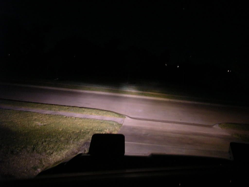

Poodles;1488753 said:
Terrible pic but you get the idea:
I used the ones with the shields and moving bulbs to switch beams.
Keep in mind I don't have anything against chinese made stuff (hell, a LOT of stuff is made there) it's just these low quality kits that are everywhere.
What setup is that? E-codes with shielded HID bulbs?
If its HID what brand?
How is the light output while driving? I would rewire my headlights but if im going to go threw the trouble im going to do it right once with a good upgrade of bulb and housings.
Hella E-code with the bixenon H$'s that move the bulb back and forth with a shield.
They rocked until a bulb burned out, the controller went dead, and then the ballasts died.
I'm working on something far better...
Nope, the scattering with the E-codes and HID's was less than a normal DOT halogen lense. Now if you put those HID's in a DOT housing they'd be terrible.
