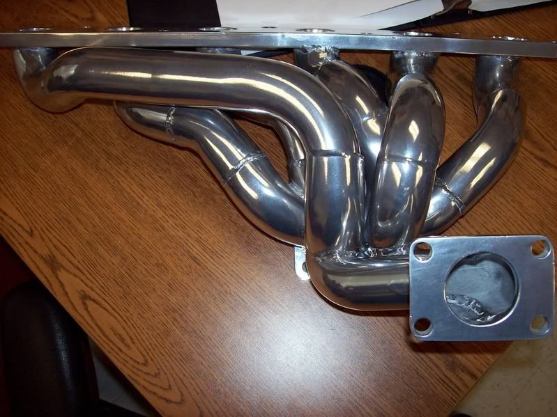

MA70_Powa;1156133 said:Looks very similar to my manifold - I believe you can get an HKS 40mm/50mm wastegate - or a knock-off on eBay, which is what I did (was a dud, so I got a different one)
Or get the flange changed to suit whatever wastegate you want
OR what I ended up doing was getting an adapter plate made up to bolt the new wastegate to the manifold without changing the flange.
Just a few ideas![]()
empera;1156147 said:thats the hks ewg, i believe its 40mm or 44mm...i would def. use a diff. one tho.
empera;1156191 said:n/m man, i've actually good and bad experience with ebay wastegates maybe brian has told u. I'm using a 44mm real tial and its great...steady boost. Maybe you should look into the same. Maybe you can even use something like this...
http://www.extremepsi.com/store/customer/product.php?productid=18909&cat=446&page=1
or weld on a new flange.
BuiltMK3;1156188 said:Yea, i was thinking about going the ebay route but i hate to put the life of my motor on some piece of shit knock-off wastegate. It looks like HKS makes an adapter to go from there 4 bolt flange to a v-band. Is that what you got?
I think $800 dollars for a wastegate is pretty crazy, although my motor cost $3500 so i guess it's not a bad investment.
IJ.;1156517 said::love: my Tial v44 best/most stable gate I've ever used.
