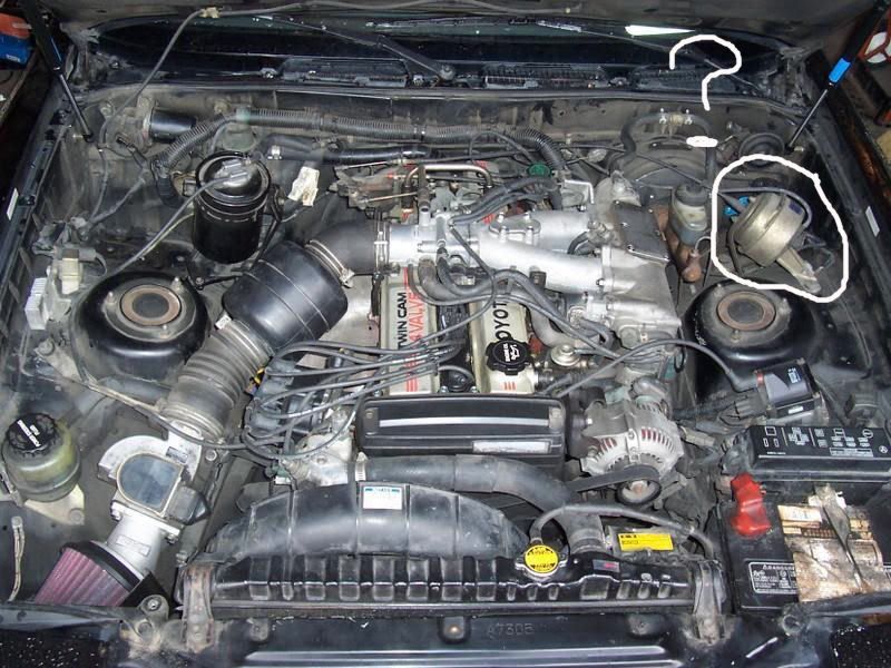

zachm611;1163331 said:that looks like cruise control to me but im not sure...you should be fine plugging it though i dont know if thats the reason its stalling.

Figit090;1167819 said:that is the cruise control actuator. if you notice it's throttle cable goes right up to the throttle arm thingy. basically it takes over and tugs the throttle in place of your gas pedal's throttle cable.
