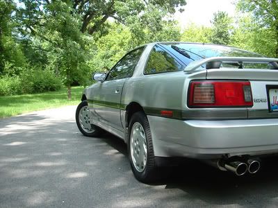

Here are pics of the exhaust on my car:
I am confused. What exhaust is on your car? The HKS Sport 60mm?

That is the HKS Turbo 75mm.
The other poster said that he thought that they ONLY came in 3" [75mm] and that either way, "the thing still sucks", as if it didn't matter to them if it was the 60mm or 75mm - it still sucks. I'm just saying that it doesn't suck, and aside from eventual corrosion in salty/humid areas [Florida near the water or places where it snows and they salt the roads], it's a wonderful cat-back.
