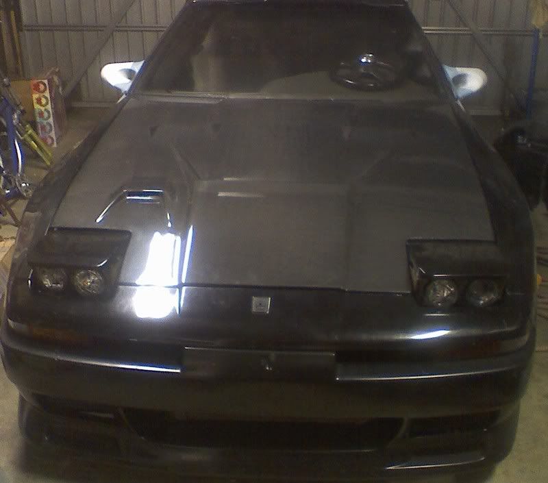

NocturnalKitty;912900 said:
dennis? are u talking about the pic posted by the op? that pic was actually taken at a socal meet back in june of 2002. i remember talking to the owner at that meet. don't remember the owner's name but i'm pretty sure it wasn't dennis. i remember his name starting w/an "a".
The black mkiii with the NSX lights belongs to Survyor22 and that pic is fairly recent, not from 2002.
