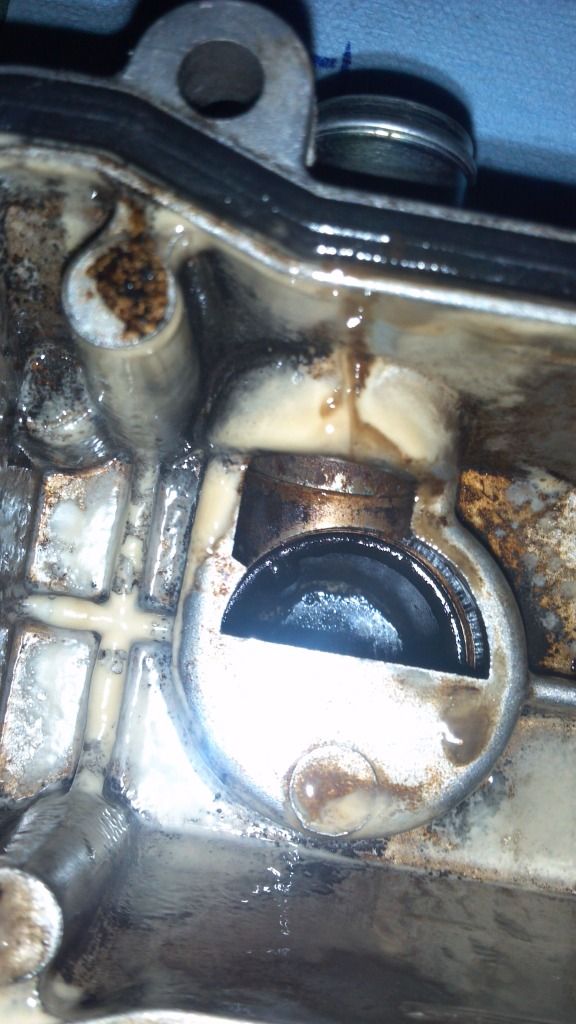

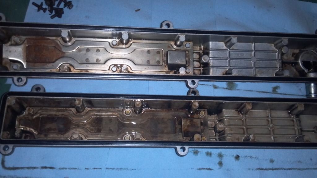

The valve covers, top one is the one I cleaned, the bottom is the other before I cleaned it.
the intake side valve cover, close up

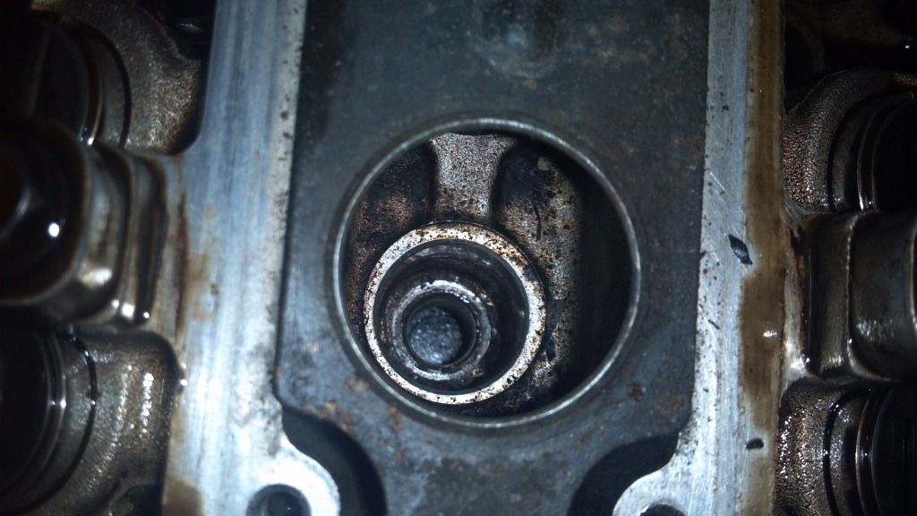

Can tell coolant has been here lol

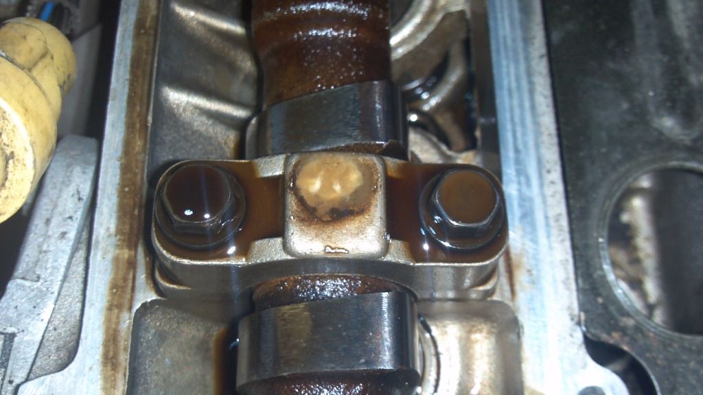

Looking into the plug hole, pretty grimy

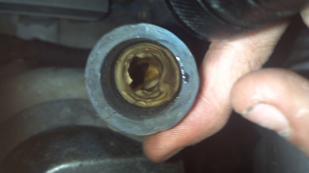

The oil return line, It was pretty clogged up, I pulled it and flushed it out with a water hose.

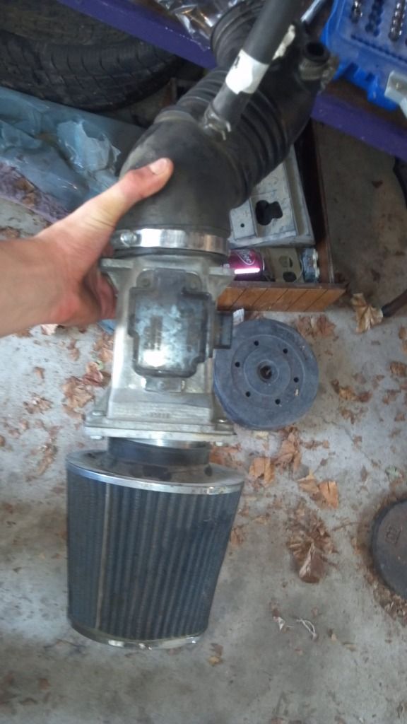

Yeah, I've seen people running without ANYTHING in front of the turbo, no hose, filter, screen, etc... What was your set up?

how would foreign objects make it past the honey comb metal stuff in the maf? maybe pull your air filter off and see if the maf is all banged up.

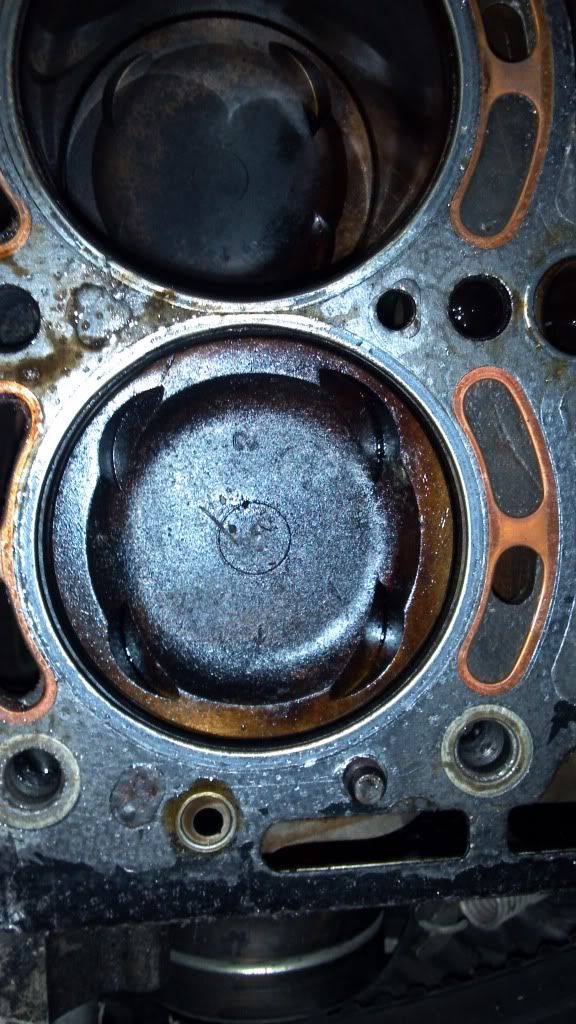

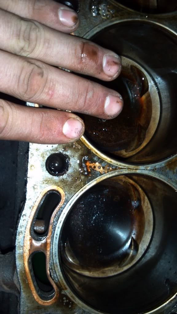

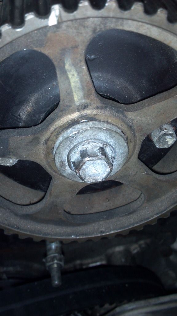

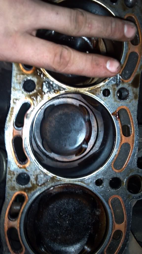

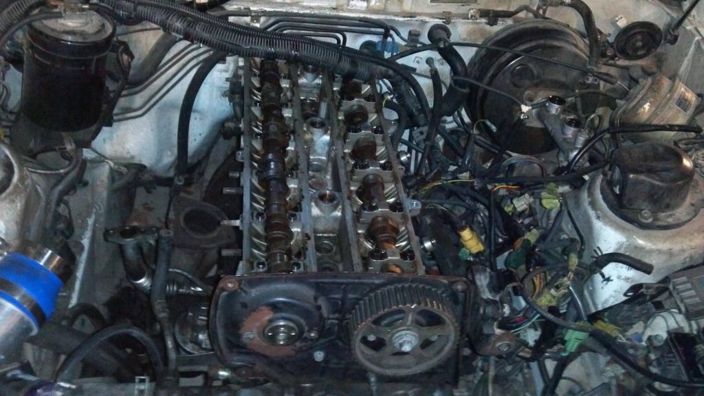

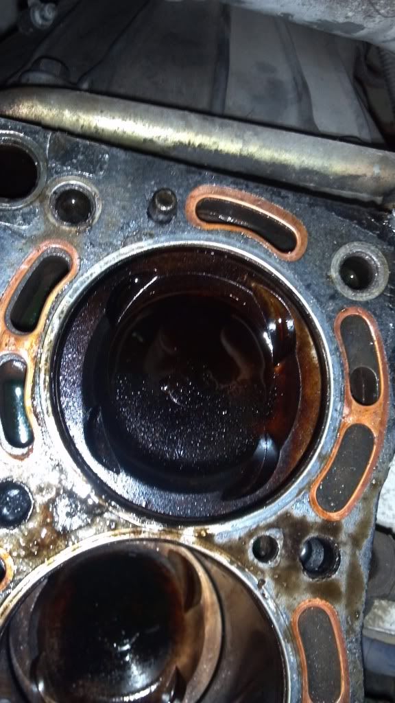

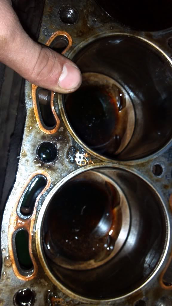

Update :
Been working on it, slowly gettin shit taken off, and I'm taking the headbolts off right now. I'm typing this as a break from taking them out, my back is hurting from leaning over the damn engine. But some pictures are coming! :D
Damn bolt rounded out, gotta get that fucker fixed -_-
The head's coming off!

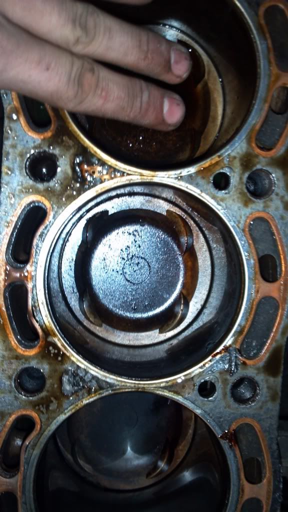

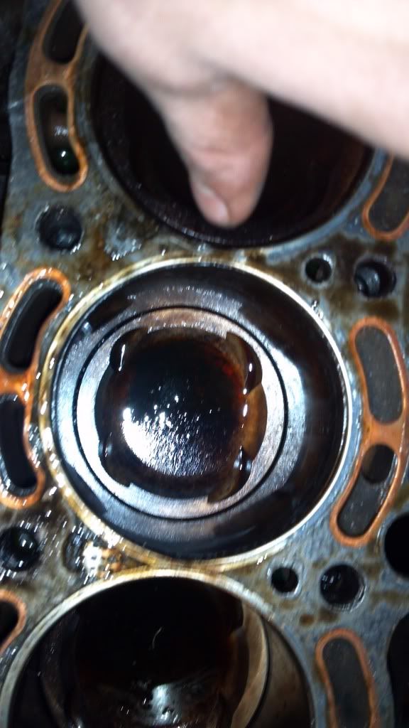

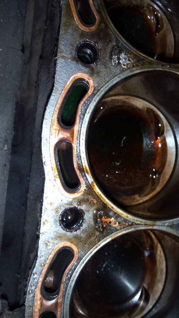

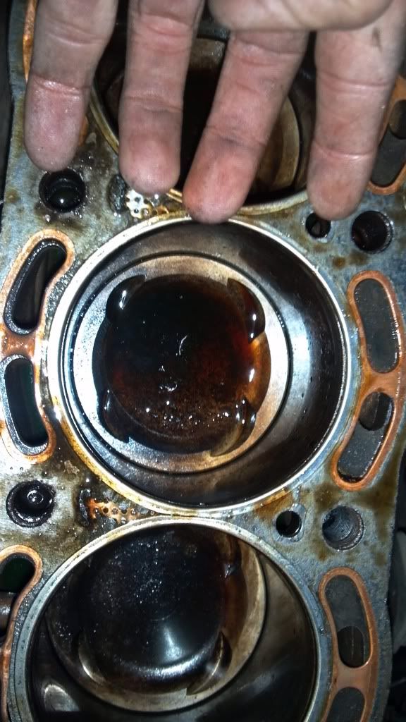

Finally got er off ;) and in these pictures, the Head gasket is on. I think it may have been torqued incorrectly because some of the head bolts were a lot tougher to break loose than the others, but I honestly don't know.
Cylinder 1
Cylinder 2
Cylinder 3
Cylinder 4
Cylinder 5
Cylinder 6
Where I think may have caused problems :

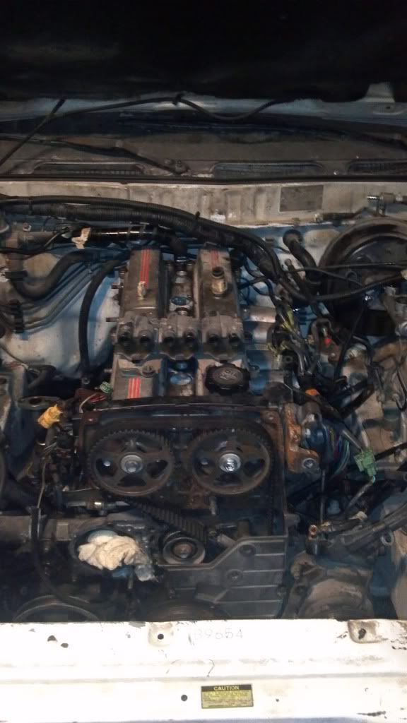

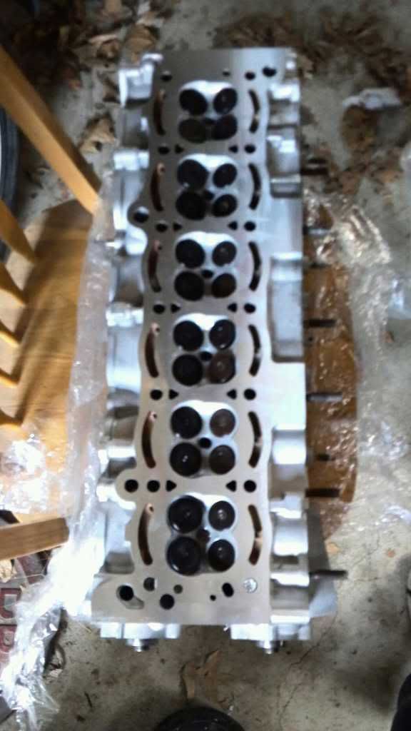

Well it's been a while since I've posted any updates. I just recently got the head back from the shop, the 29th of March actually lol.

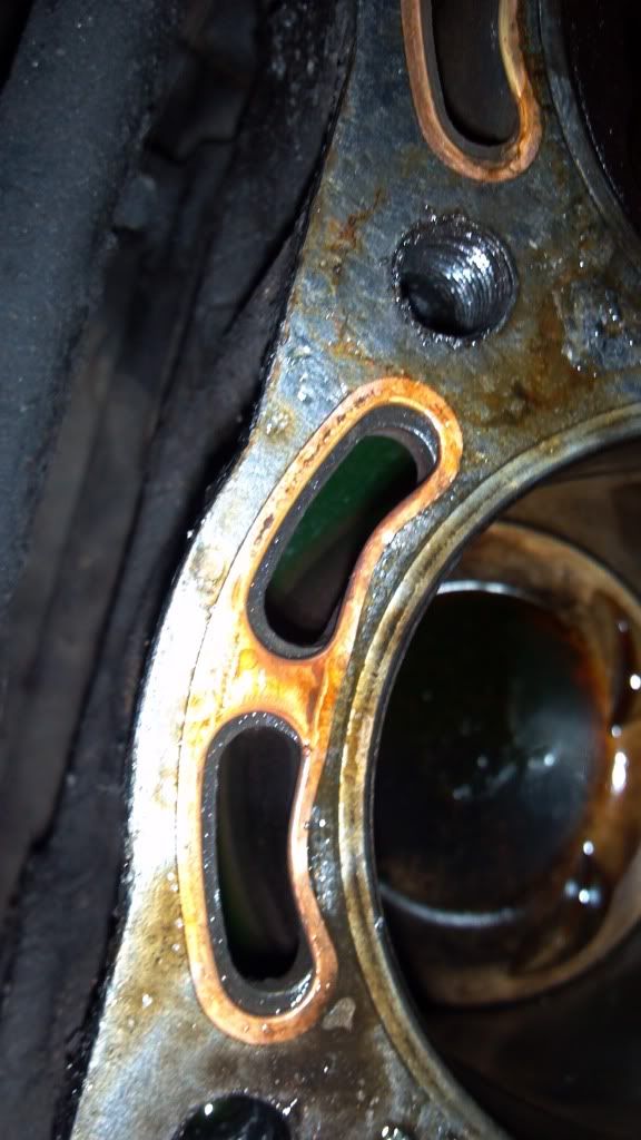

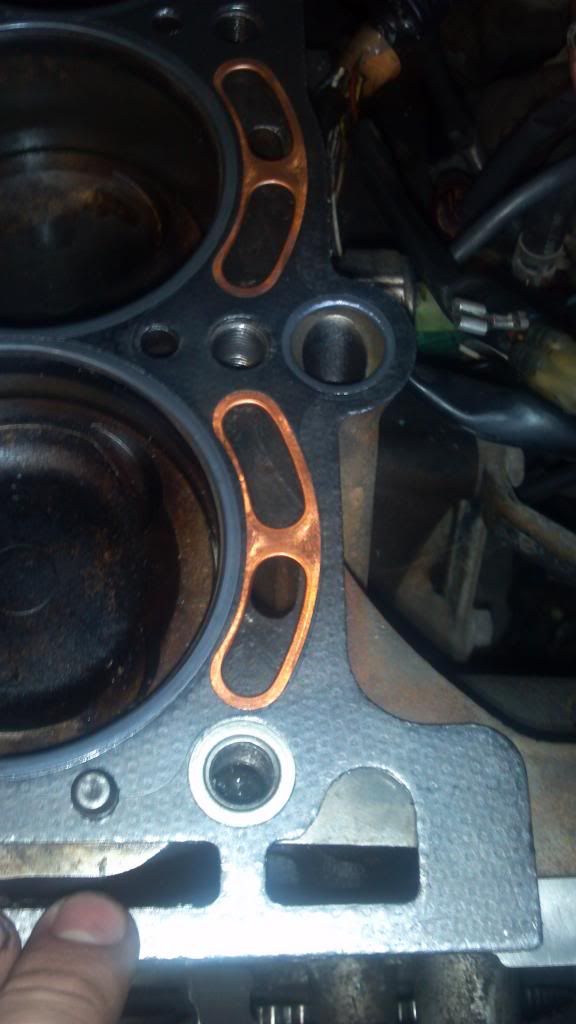

I have been putting the cam gears and everything back together and was about to put the head on when I noticed something. The gasket doesn't seem to line up right.
You can see where the coolant lines, i think that's what they are, the gasket is different than the block. Is that normal, or did I get a wrong gasket?
Here's my head though, nice and shiny!
And cleaning out the threads in the head!

Orion ZyGarian;1867329 said:
It's more than likely that turbo was run without a filter for a while (or at least long enough to suck birds and small children in), then they got the filter later
As it turns out, I was doing a little looking and the accordian pipe had cracked and some of it sucked through.

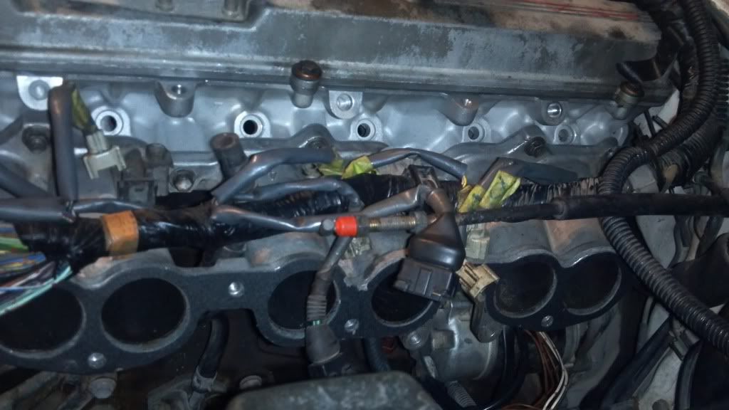

I'm slowly making progress!

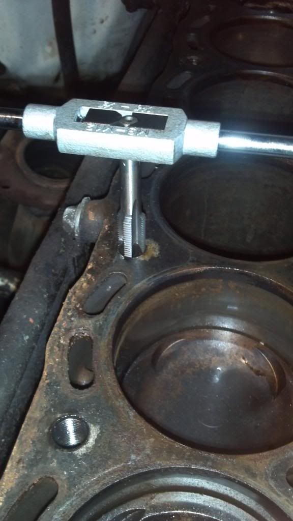

I got my intake on, but do I need to put the rtv sealant on the gaskets too? Also starting to get my wiring put in place a little bit

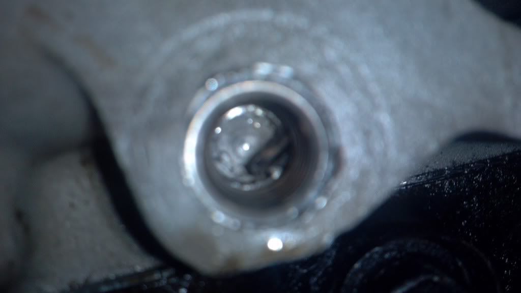

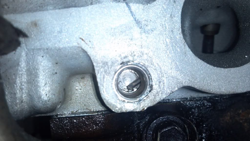

Also, I got my helicoils in, but I'm worried about trying to get the lil tip out, I'm afraid I'm going to miss it and punch a hole through the head into a coolant/oil line. Any suggestions?

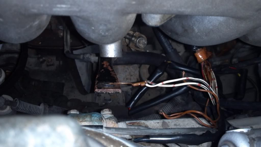

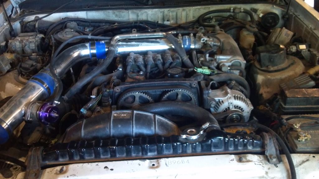

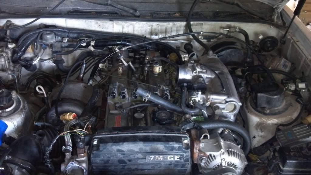

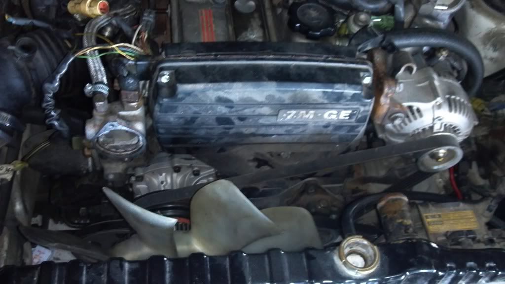

Some updated pictures, I have gotten a little more progress made since pics.

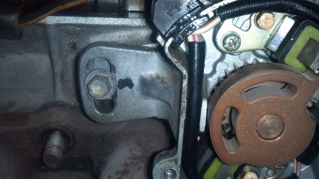

What size is the bolt that is needed to go in the bracket support hole here? I seem to have lost the bolt that came out of it -___-
Since the pictures I have gotten the plug wiring ran, throttle body installed, and beginning to place the hardlines for the ISCV and the other hardline that goes across the top. I'm just wanting to make sure 100% that I don't hook up anything wrong so that I don't mess anything up after I've come so far.
So far things I have left to do :
New rad hose at bottom of radiator.
Reinstall Charcoal Canister - Although I have been considering the EGR delete block off plates from suprastore.
Turbo support bracket - I seem to have lost mine, if anyone has an extra that I could buy, that'd be great.
Hook up vacuum lines/lines that go to the accordion pipe.
Bolt exhaust to down pipe
Tighten bolt on AC pulley - what's the best way to move the pulley over enough to tighten the belt up?
Also considering a new BOV setup, as a friend of mine was looking at it and told me it's a pretty ghetto setup. I'll get some pictures of it, but I'm almost tempted to just leave it be if I can get it to be reliable, because I leave for school in 2 weeks and am limited on time now. I'll be going to Kansas State University so I'm wanting to take it with me, but I know I'm going to be tight on cash and not sure if I can keep it running, so I might just leave it at my moms with a tarp over it until I know it's good. But I'd rather not honestly haha
