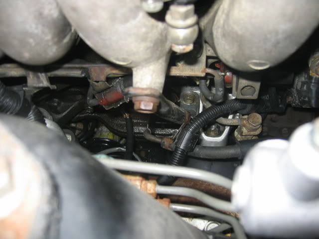

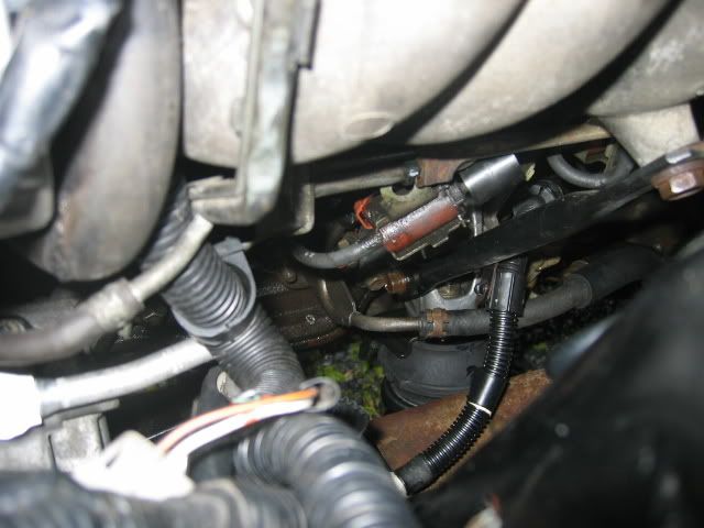

ok so i dont have an sst (maybe i do if i knew what that is:3d_frown:) but anyhow, i got a fire extinguisher and starter her up for a few seconds. i snapped some pics when i shut it off.
it hadnt ran for 48hours so all these parts were dry before i started the car. the car ran for about 5 seconds before i shut it off and i could not tell where the leak was coming from because all i could see was spraying gas!! it is somewhere in here though:
and if you cant tell, this is right under the intake manifold:

Aspec;1023386 said:
Like the man said, run the fuel pump with a jumper on the diagnostic block. You don't need an SST. Just a jumper that will fit...a paper clip will work...might need to flatten the ends a little. This will show you the leak.
From your picture, I would suspect the hose that connects the hard line from FPR to the J-tube (center of your pic). Here is a breakdown of the fuel lines for reference. Good luck.
