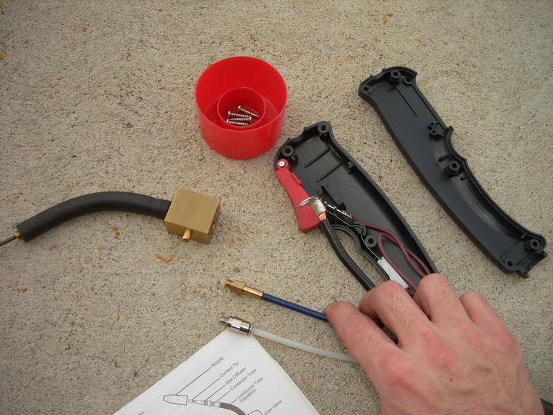

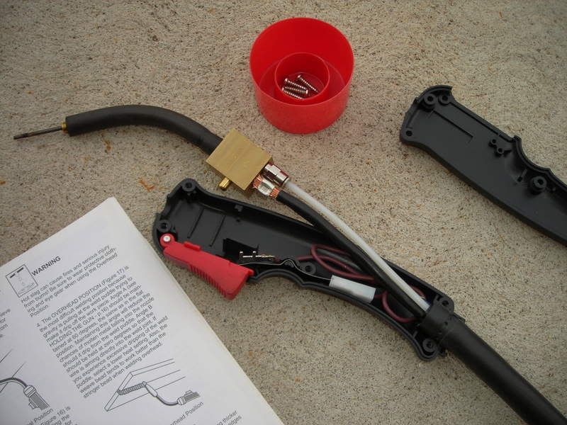

Dismantle the torch:
Remove gas feed, then the liner connection.
It's the blue one.

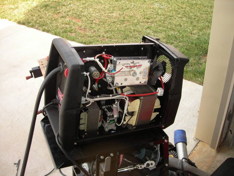

Okay, there are (2) screws and (2) "Bolts" that hold the liner tensioner... but what you don't see are the (2) nuts that are on the other end of the bolts.
Guess what... you need to take the entire cover off. :rofl:
Got the liner out, I just need to get the replacement.

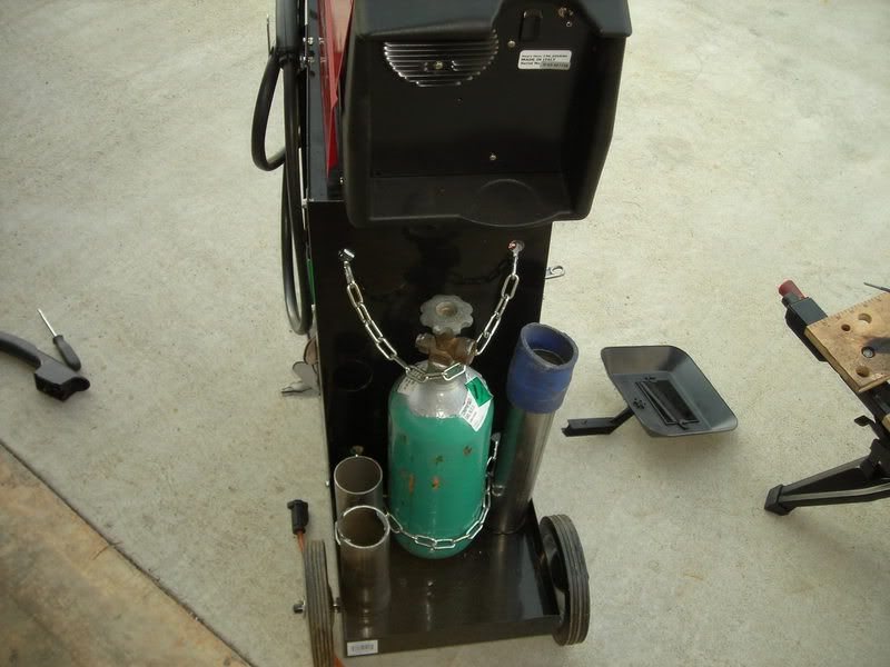

Here's my new 20lbs tank, and regulator (not pictured)
Now I can really MIG.
