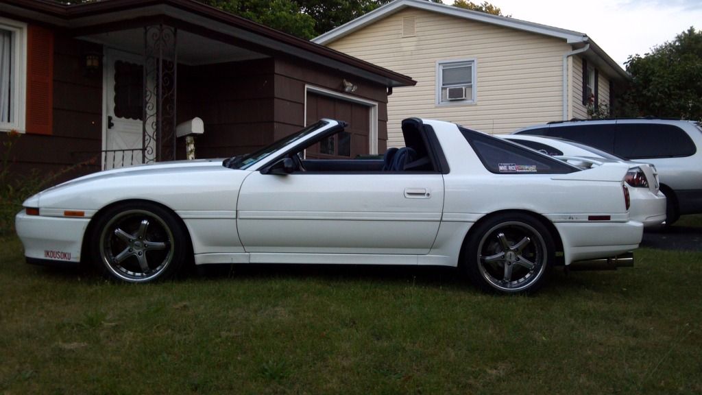

i had to roll all the fenders. i was running 18x8 + 40 before with no issues. i had 225-40's on there. if i had to do it again, i'd do 18x8.5 +25 or +35.
jony89
Oct 20, 2013
159
LongBeach
any pics of that setup?
