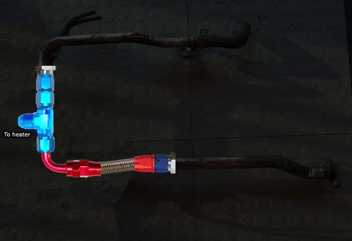

Dustin, I put some remaining Stinger Roadkill (Dynamat type product) on the head shield for my stock twins when I put that back on. I had initially cut the shield in half, since getting that thing in/out is a ROYAL pain in the ass. Basically used the Stinger as a "tape" of sorts. Expected it to melt, being tar-based. It's held up pretty well to the heat, you might try wrapping the hose in something like that.
Alternatively, re-make the down pipe to keep it further away from the heater hose.
ifyouaint1sturlast
Banned Scammer - I'm whitemike.
Jun 14, 2011
480
Fort Myers/Cape Coral - Florida

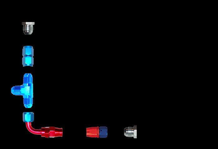

Like so:
Although, I was considering just welding the fitting to the flange coming off the water pump itself..
None of this is final, I haven't decided what to do yet. I don't want to run the GE pipe because I'd like to retain the oil cooler on the other side of the block.
