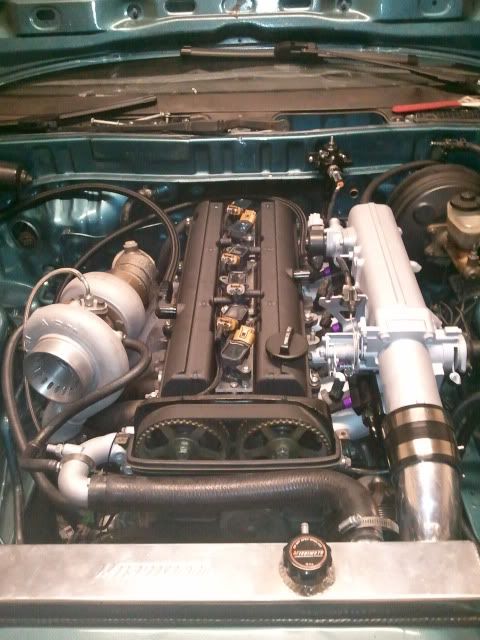

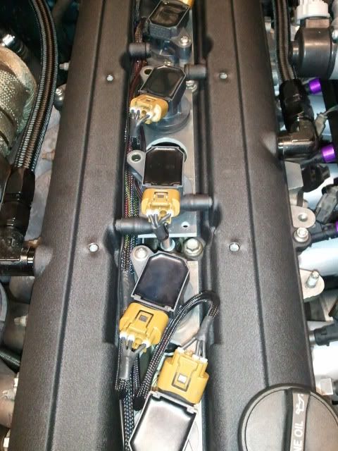

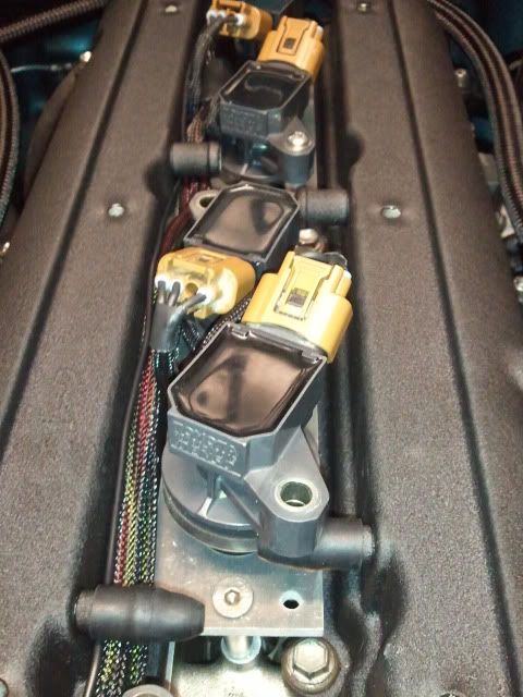

Got the hardware to mount the coils to the brackets. I also got my proefi back. Harness needs to have a couple miscellaneous connectors installed like the boost selenoid and water temp for the gauge. Going to finish that tonight and put the harness in the car so i can mount the proefi. Also ordered the AN fittings for my water neck and turbo so they will have nylon braided hose to that. Albert has put the machining on the BBK on hold because of working on some other 2j or something like that...hes really ADD with projects

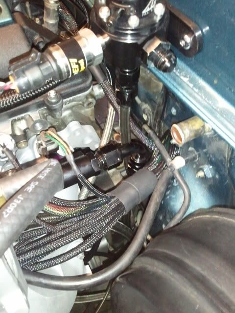

Its a heater valve off of a 4 Runner

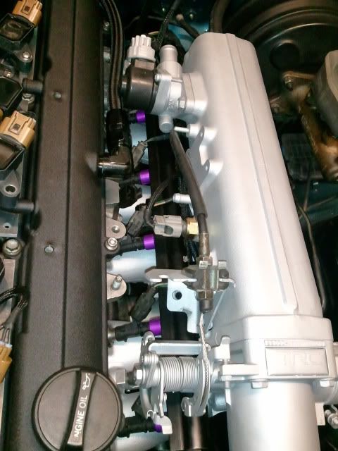

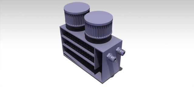

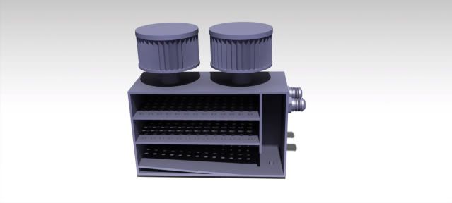

Well here are some more pics. Got the harness in and it measured out all good. The proefi will be placed in the stock ecu location and I can have a working glove box again! Im pretty excited about that. As for the #3 coil im going to trim the port and put then put the cap on it, this will let me fit the coil in the proper way so that I am not stretching the harness. Going to order the new water gauge I want tonight. Also drew up some dimensions for a catch can. Im going to got saturday and get the pieces from our local metal shop. Looking at making on that is 8.5x5x3.5 inches to fit where the ABS unit used to be. There will bee steel wool between the drilled plates. What do you guys think of this kind of design? Any flaws?
