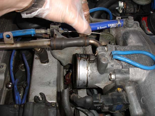

Step 2 - Squeeze the metal clip connecting the PCV system to the throttle body and work it back down the pipe so it doesn't hold the rubber hose on to the metal tube

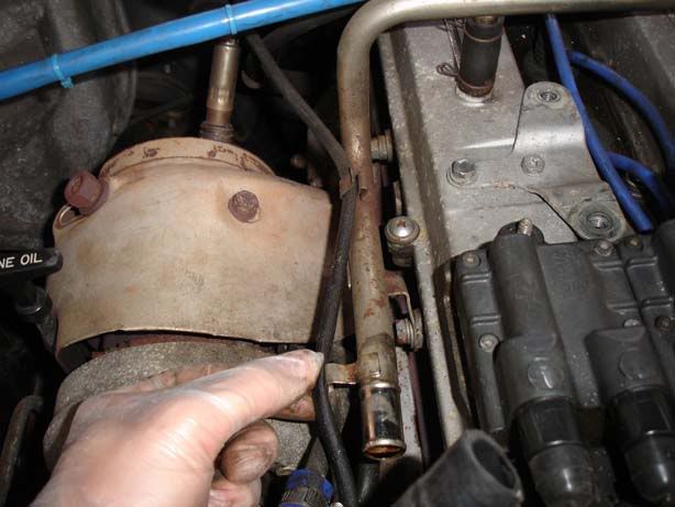

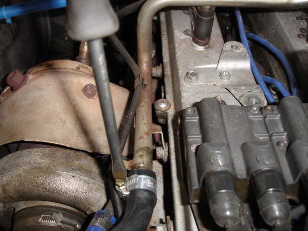

Step 3 - Undo the jubilee clip at the other end of this pipe that connects to the accordion hose

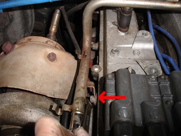

Step 4 - Pull back the metal clips that hold the wiring for the lambda sensor in place and move the wire clear of the pipework
Step 5 - Use a spanner to undo the 12mm bolt holding the bracket for the PCV pipe in place. Be careful not to drop the bolt, undo the last bit with your fingers

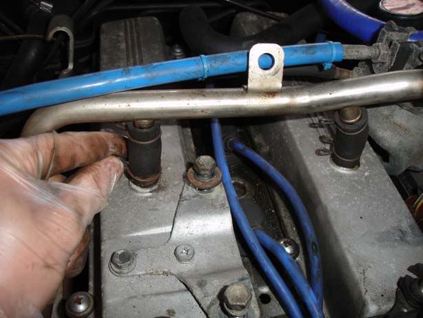

Step 6 - Retract the metal spring clips up the rubber hose for both the cam cover breathers. You want to pull the rubber hose away with the pipework rather than leaving them connected to the cam covers

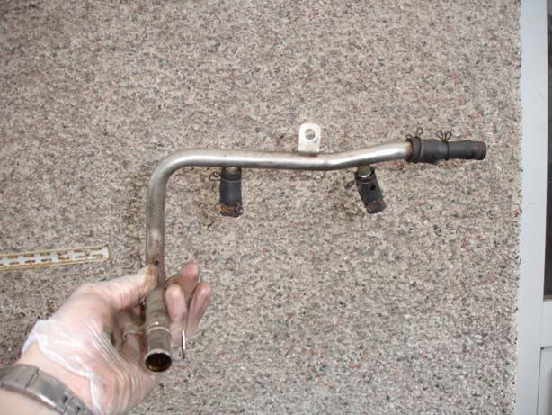

Step 7 - Pull the pipework free from the vehicle
