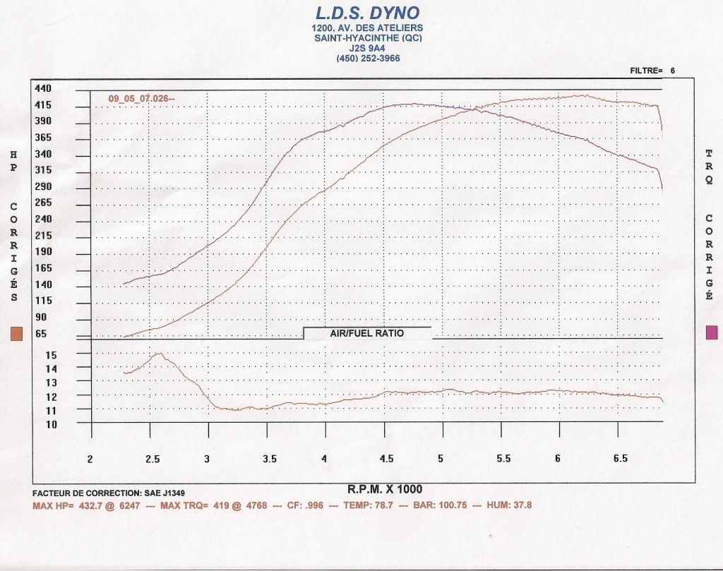

i have a gt3076r with .63 hot side on 1jz , it's a torque monster,but i want more top end power. I think .63 it's too small for top end power,i only does 13's and 114mph ,i'm really disappointed . If i'll try to change the hot side for .82 or 1.06 , do i waste my money and i'll be better to go with bigger turbo
other option is change for gt40r or gt35r ???a/r

I think couple of guy on this forum have 1j with gt4088r , i would like comment from they're experience . From what i read , lag is overrated , he probably hit full boost at 5000rpm?? on 1j . garrett produce very fast spolling bb turbo
i want big power 1j :evil2: and lag is not trouble if he don't have too much
for last question i live at south of montreal; you can probably read my french accent :biggrinbo :biggrinbo

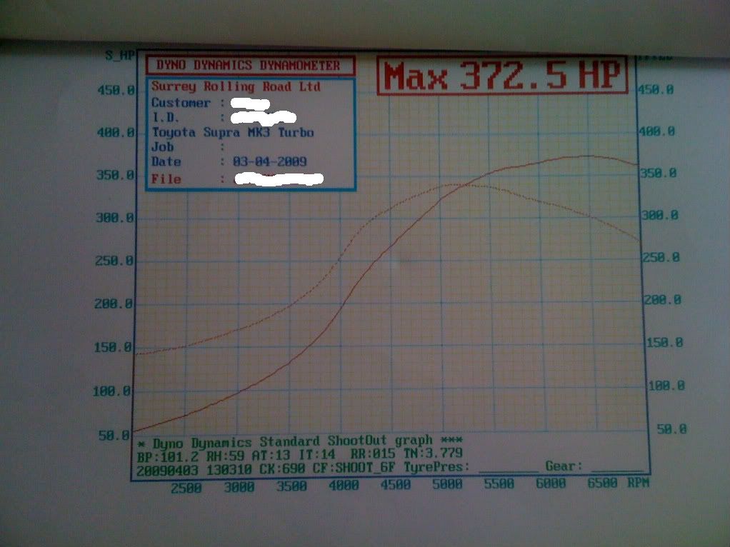

What would a 0.63 housing be like at the top end with stock cams at 1.3bar?
Thinking of swapping from a 0.82 to get quicker spool

yeah , i probably can do mid 12's with slick and more experience , but the top end power really sucks with this turbo,all the power is before 4500rpm and below that , the engine can not breathe correctly,with this kind of power , i can sell my car for buy a mustang!!

This is my dyno with a gt3076r, 0.82 housing and stock cams, 1.3bar

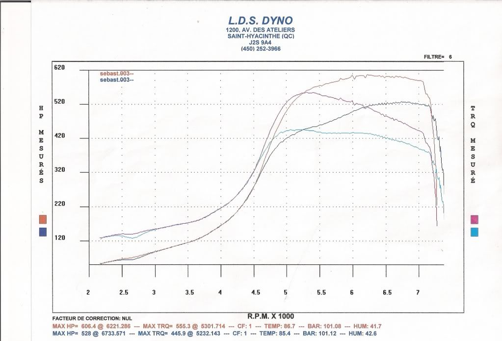

here is my number with my new setup
i mixed 10L. of c16 with 40L. of pump gaz to push at 28psi

Guyana00;1362984 said:
Nice, but the powerband seems narrow and the turbo seems a bit laggy. I think a 35 would have done well.

on the dyno sheet that look laggy, but on the road its different story,it's alot more fun than my gt30 setup.With the gt40, the engine rev faster and come in boost rapidly , i probably kill the gt30 setup from first gear to fift gear
the car is actually build for street and wenk-end drag , i understand that gt30 would be better in xcross ,but i don't do that. i have a 4.10 rear end
