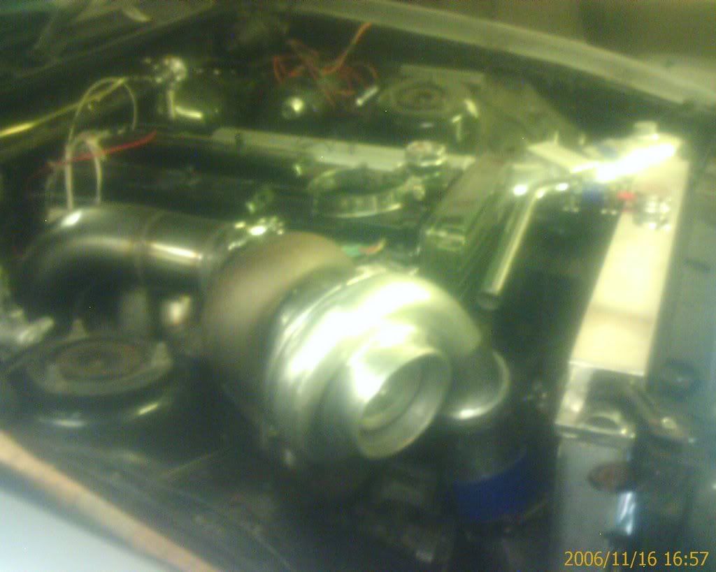

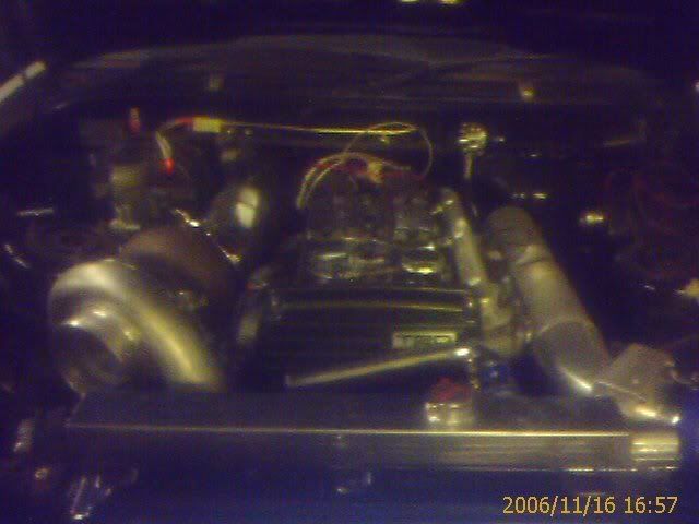

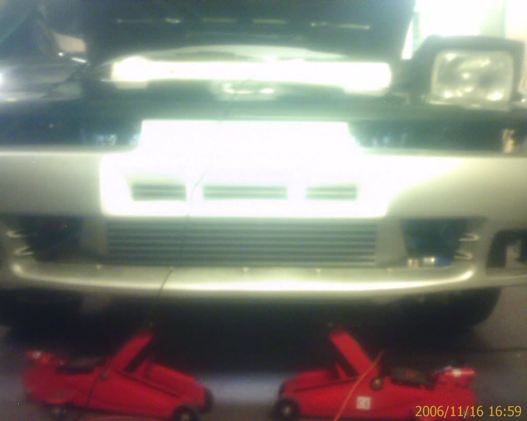

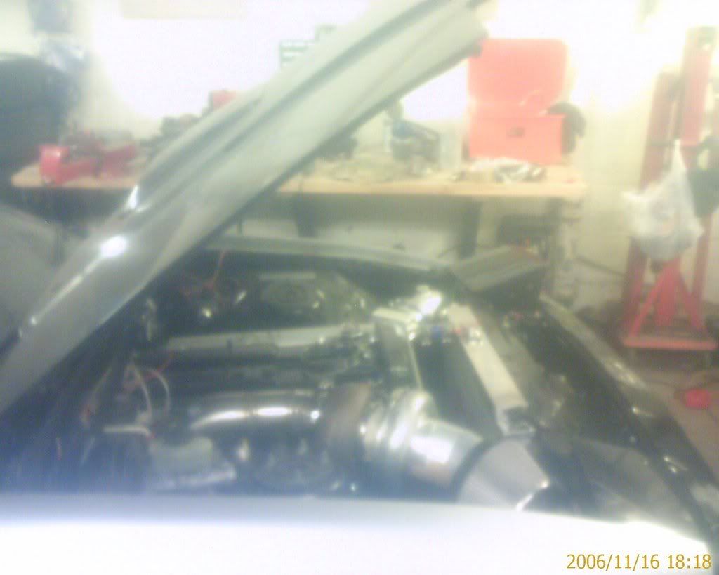

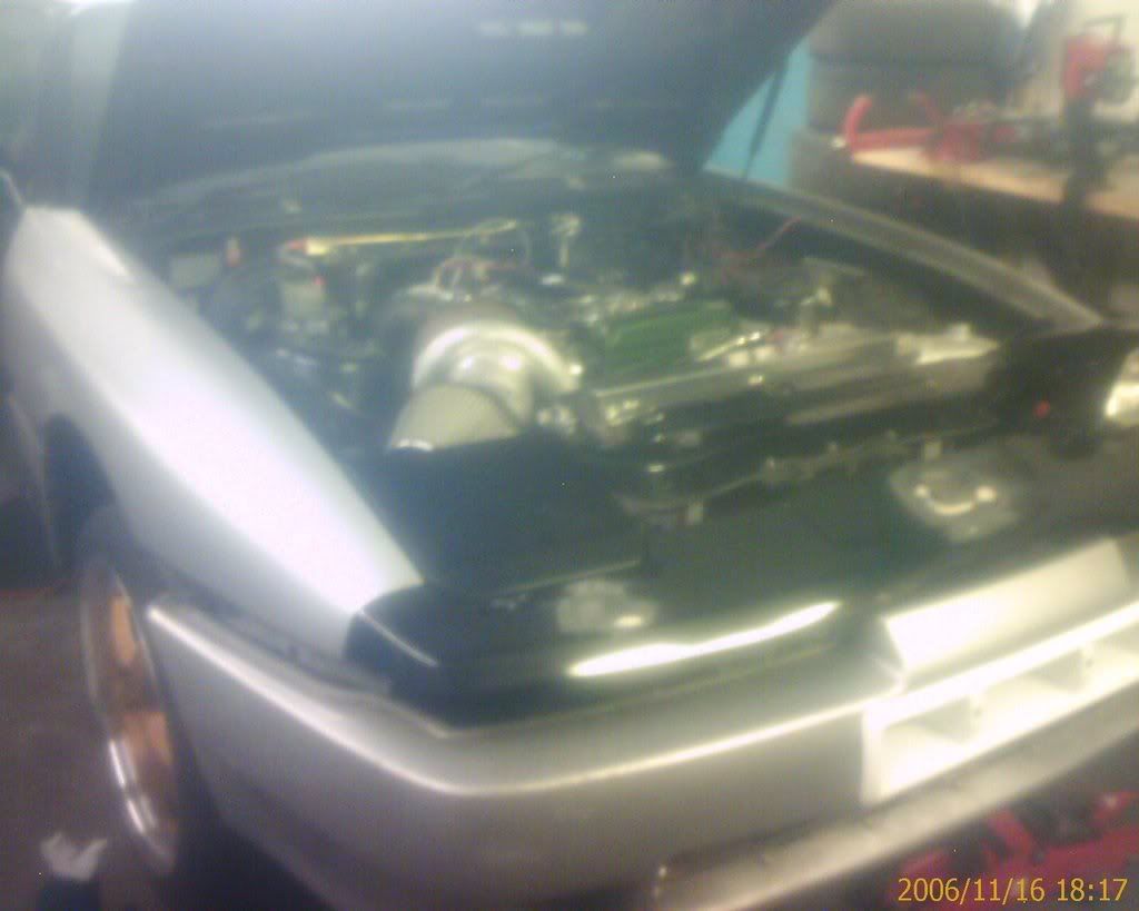

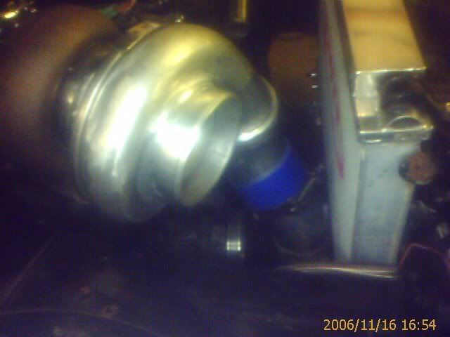

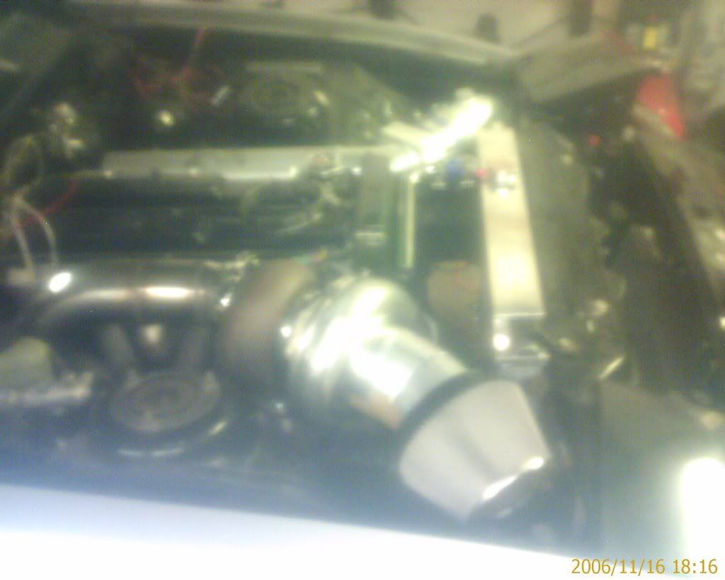

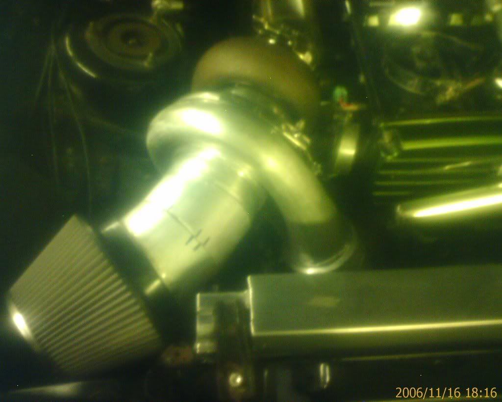

finished the intercooler pipes today only one pipe per side also fabbed up the airfilter set up at last the car is starting to look sort of complete :biglaugh:

Bondango said:
Steve, have you thought about using a Fog light instead of flashlight on the camera? lol :aigo:
Looking good as usual man, Whats the clearance like on the thermostat housing??
my phone and bad lighting my camera is all busted :(
i am not going with thethermostat housing i am making a new one up more on that soon :naughty:
steve whats the plan for the V cuts left in the bumper after removing the plastic grill?? i got my a-duct bonder in and my bomex 3 hole on this week, but im wondering what way to tackle those V bits! :icon_conf

I assume the water outlet is relocated or customized..? I can also only assume you have modfied a header to accomdate this? My header fts that turbo too :biglaugh:
Looking good bro!
Duane
NOW GET BETTER PICS MAN.
PS: What size DP you have?
Looking good bro!
Duane
duane i am going custom on the water outlet ;)as far as the header goes it is complete custom job by myself as is the downpipe all of this has been fabricated at home the down pipe is 4" :)and i have ordered a new camera for christmas;)
