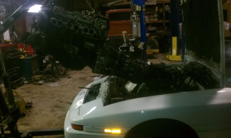

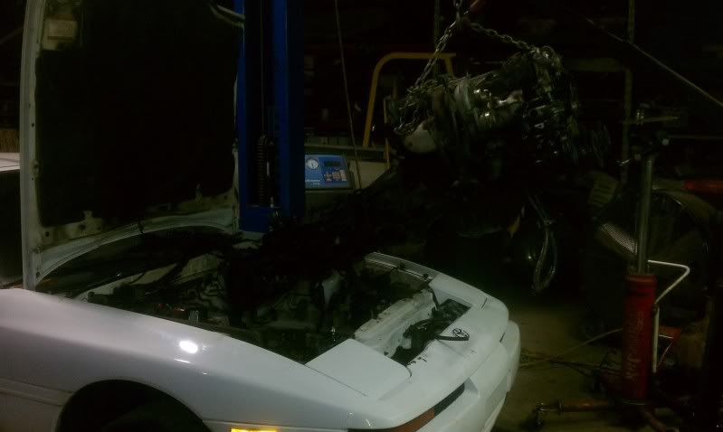

My new car
1992 Turbo Targa
I got my 92 for $1250 all stock had bhg. I had been looking forever for another soup but couldnt find one cheap enough I could afford and turbo 5spd targa, and settled on an rx7. well about 2 weeks owning the rx7 I decided to look on craigs just for fun and there it was. I couldnt believe it after about 2 years of looking, i finally quit and there it was. So I gathered up the money and the trailer and got it, not the rx7 is sitting in pieces while I work on the soup instead
Well new car = TURD! Oh well pretty much everything I buy is a TURD. Glad I got the know how, hook ups, and all the utilities to do it.
Original intentions were to pull the motor freshen it up if it needed it (high mileage) and fix the BHG with a little extras here and there and alot alot alot of cleaning, painting and whatever else needed to be replaced. But its turning out to be a complete engine build.

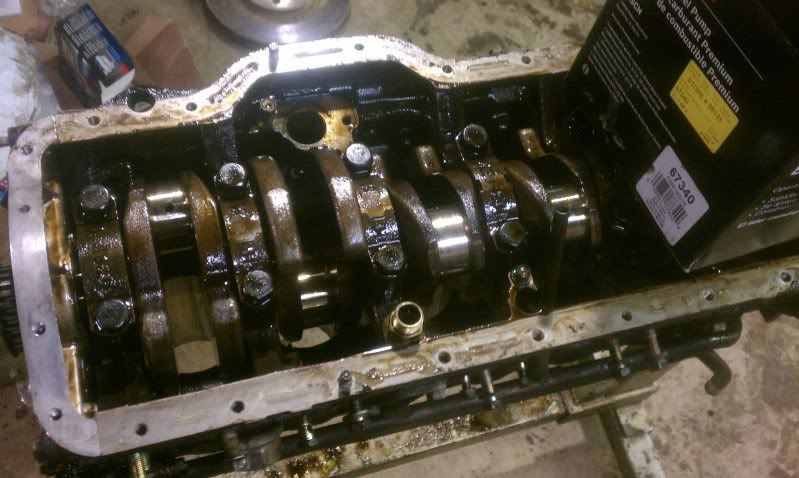

IT had a slight rattle above 2800 rpm that was dependant on load and it would quit above a certain rpm. I just figured it needed a valve lash. Boy was I wrong when I drained the oil.
This is a slight rattle. not even that noticeable.
Thank GOD for forged cranks, and thank TOYOTA for using them. I can just get away with a first size under cut crank and oversized bearings, if this was a cast crank, it would be a total crank replacement.
So New bearings and crank going to machine shop, rods resized also.
