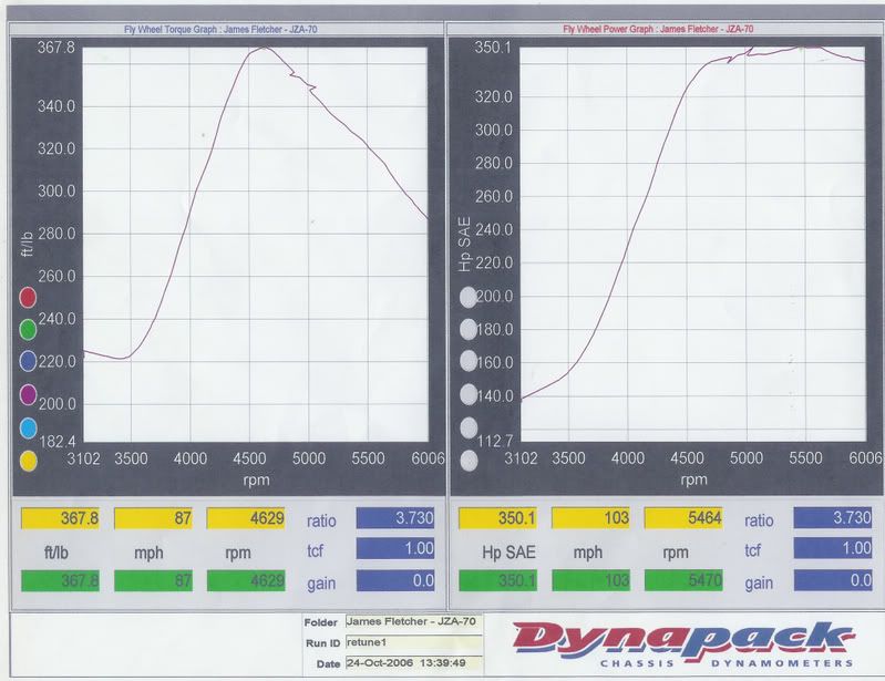

I was also under the impression that my TD06-20G would do 400-450 hp but am being told by the dyno shop that it is maxed at 360. Newest dyno sheet is in the photo bucket.
http://s89.photobucket.com/albums/k204/JCFsupraman/JCFs Blue Mica Metallic Turbo/
With my mods I am told that I should be putting down 400 easy. All I want is 425 ish and 12 seconds in the 1/4 mi.
I am being told that I need the AEM and not the emanage & Profec E01 and the GT40R instead of the TD06-20G.
Do I really need to spend more to acheive my goals? Anyone with similiar set up or mods out there? Thanks

It was 450RWHP@18PSI.
I think there's something else wrong with the tuning part of it. Timing sounds way off, and also you're using an automatic, but still...
How's the compression?

Racer - Compression test was done about a year and a half ago and the car has just sat since but all was good. It ran smoothly at 1.5 bar back a couple of years ago but dyno numbers are crap compared to where they should be. Would removing the Lexus afm and the stock ECU and replacing with the AEM ems make that much of an improvement? Thanks for the link.

Ive seen this turbo on quite a few mk3's make 400 to the wheels something is wrong.A matter of fact when i get my car on the road this is the turbo im going to run.

Well we advanced the timing from 10 to 12 and it is running a lot better. And if you manually shift from 1st to 2nd to Drive it seems to run better again. So it looks like the auto tranny in Drive only is starting out in 2nd loosing 1st all together. So yeah it still is the tranny Adam. Crap.

eh, i wouldn't go advancing the timing. given your goals, you'll end up regretting that.
still the trans? not to be a jerk, but what have i been saying all along? :( hopefully now you can get the problem fixed once and for all....

Sorry if I missed it, but what were u're a/f's during that dyno?

JCF, here's your dyno for the lazy people, so you can get more responses :)

Why would I regret advancing the timing? They did it to Robbie's car too and it is running better as well and that is with the larger turbo installed too. What do you know that obviously I and perhaps they don't about not advancing it? Thanks

heh. cars always run better just before they blow up. advancing the timing is fine @ low boost levels and low power levels. but as you go up in boost level, you need to REDUCE timing (especially on pump gas) to prevent detonation.
don't forget that AFM scaling messes w/timing as well....i.e. you "lean it out" via SAFC/eman/etc. you are INCREASING timing.
