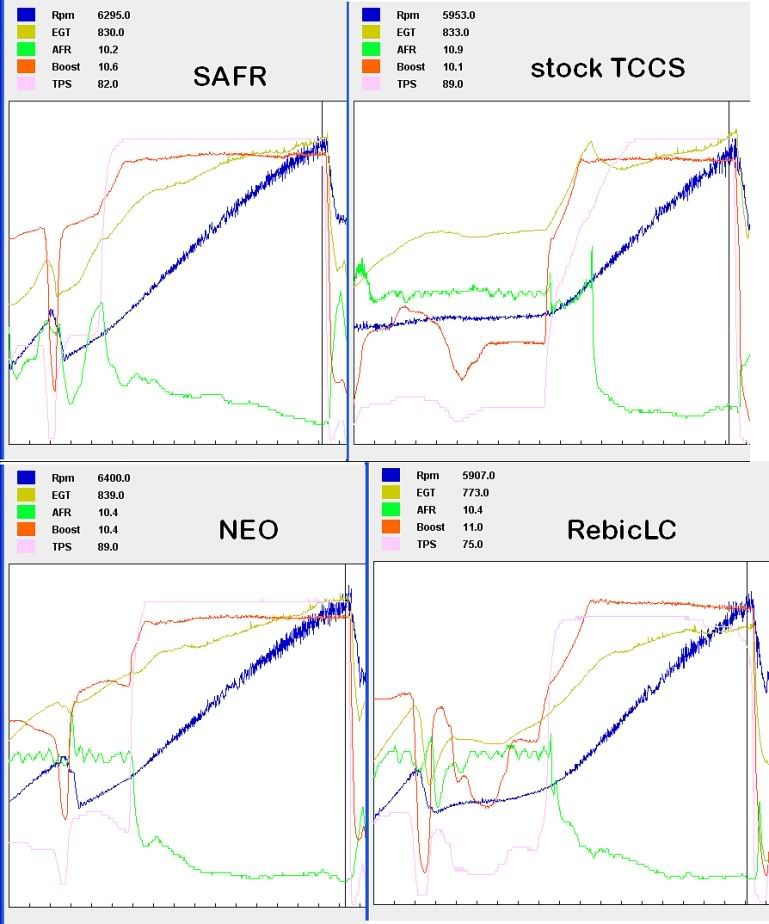

Something I saw when tuning with the Rebic as opposed to stock tccs, safr & neo;
with the Rebic's ability to control injection it cools EGT at WOT -
These are all 3rd gear pulls with comparable boost level.
~830° in the others, ~770° in the Rebic

maybe the timing alteration has the cooling effect on the egt's isnms. Ive never seen this unit before but it looks cool! Does it tap in the same as the safc and neo's or how does it control fuel injection?

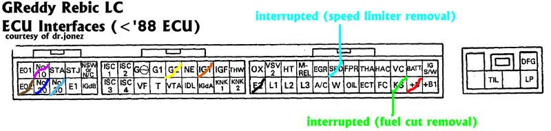

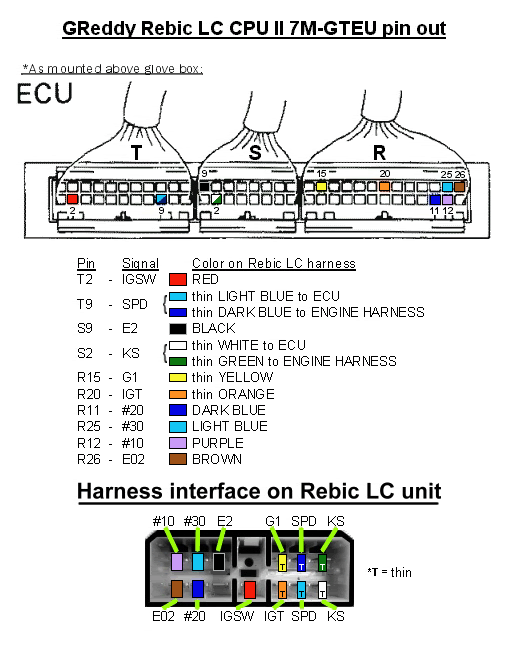

Rebic lc wiring info
Thanks to Dr Jones for this one.
And ISNMS for this one.
Hope they help out, As they took me ages to locate, As the Rebic Lc is a rare piggyback these days.

martin - that second one is mine not drjones, thanks for citing source :rolleyes:
http://www.supramania.com/forums/showthread.php?t=86795
Only two signals are severed – KS (AFM) and SPD (speed)
The other signals are only tapped
some more info:
• http://tinyurl.com/qdpjvt
• http://www.mkiiitech.com/forum/showthread.php?t=921
edit: I wanted to add, for anyone looking for a RebicLC. You shouldn't have to worry about doing any wiring. It should come with a harness that has a wedge you just connect your engine harness to and then connect the wedge to the ECU. Plug-n-Play.
like so:
