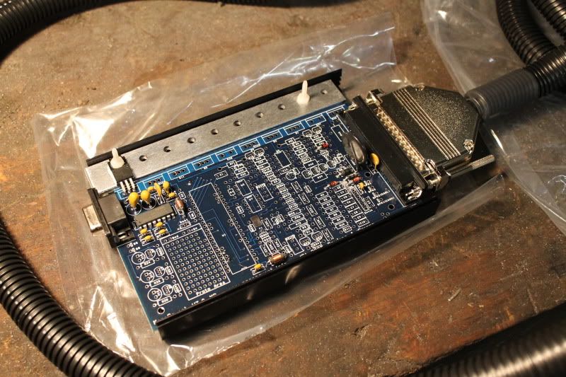

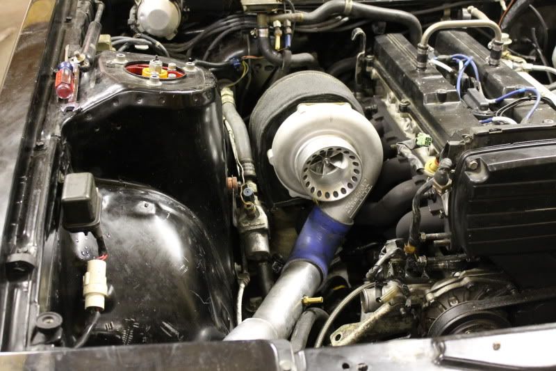

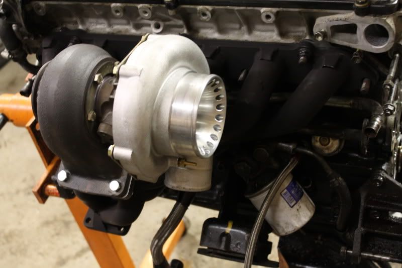

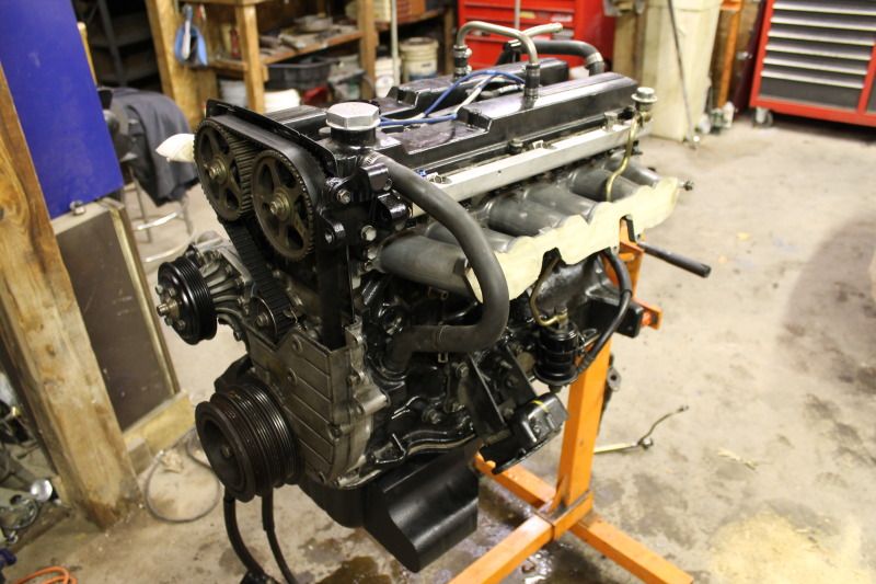

I have a Ron R FFIM, Lexus IS300 Coil Packs, Full 3in Exhaust (half Raptor Racing, half random fabbed pipes), 2.5in intercooler piping between the turbo and intercooler and 3in between the intercooler and intake manifold, PT6262 Precision Turbo, RC550 injectors, Aeromotive FPR, and a Walbro fuel pump, a Godspeed 70mm throttle body, a Godspeed mkIII radiator, Ford electric fans, 2.0mm Titan Motorsports MHG with ARP headstuds, CP pistons, Crower rods, Beach Performance oil pan, a True Trac differential with a set of 3:73 gears, a Fast Shafts one piece steel drive-shaft, an R154 with an ACT Clutch and Stock flywheel. I'm currently building a Megasquirt II setup... And that pretty well sums it up.
