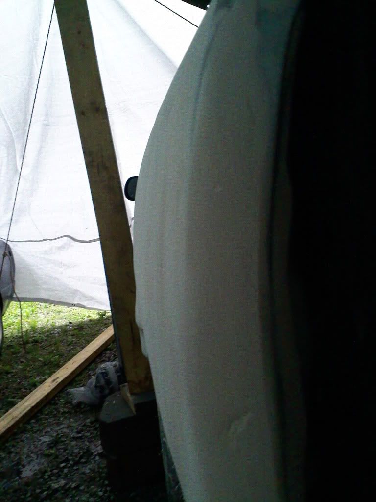

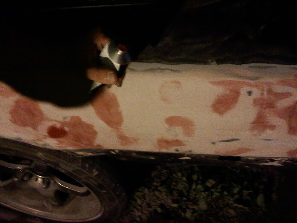

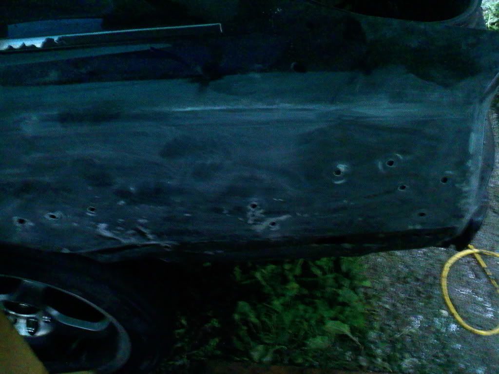

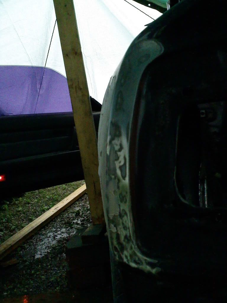

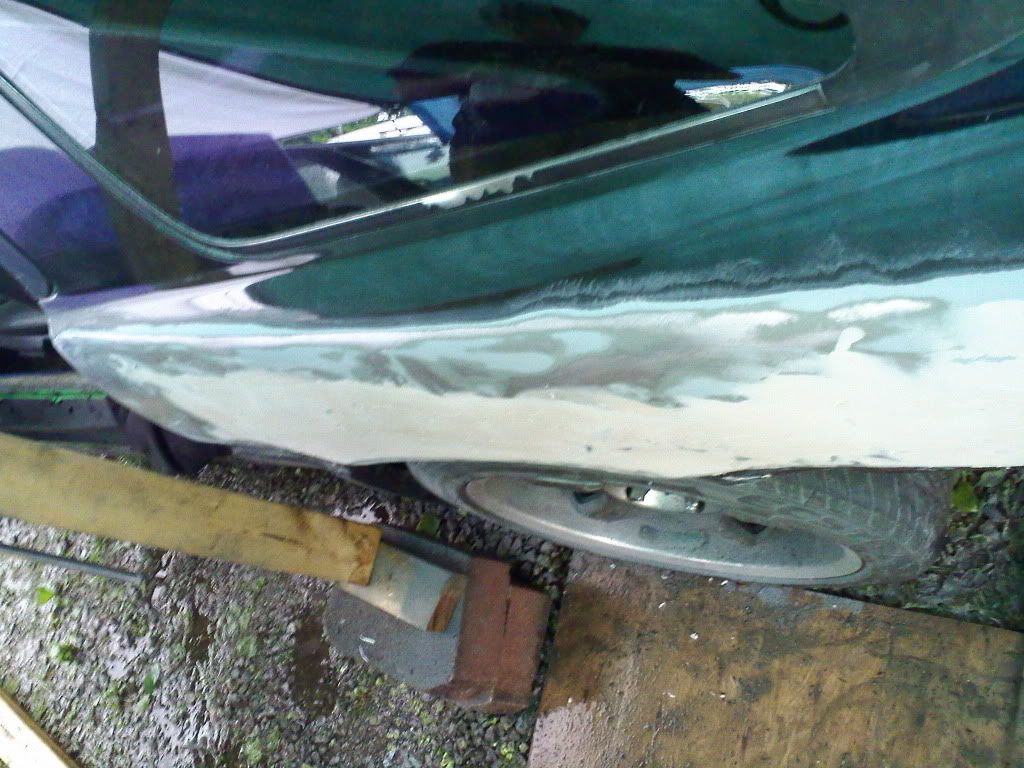

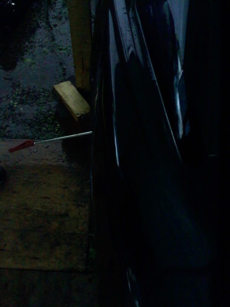

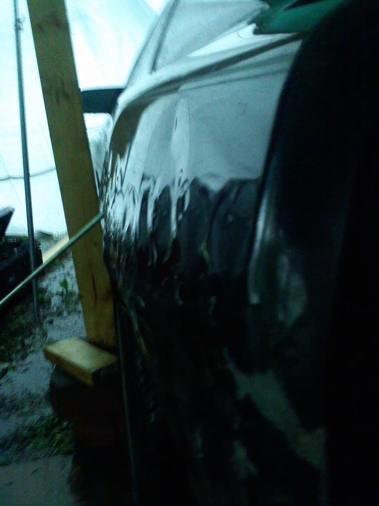

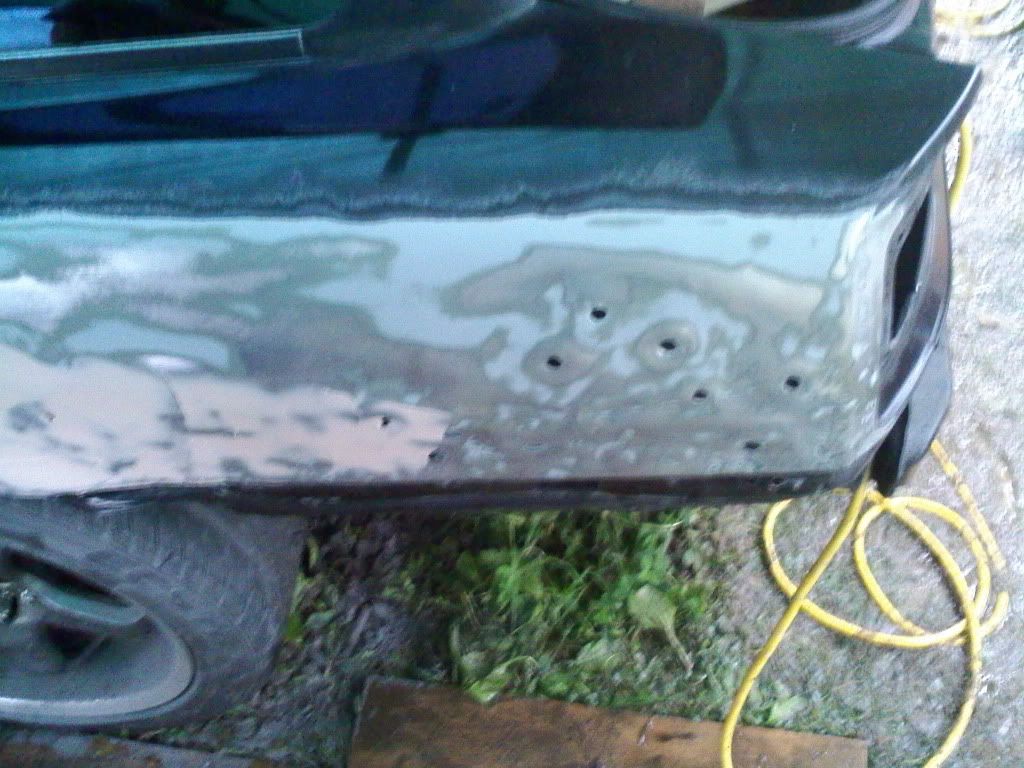

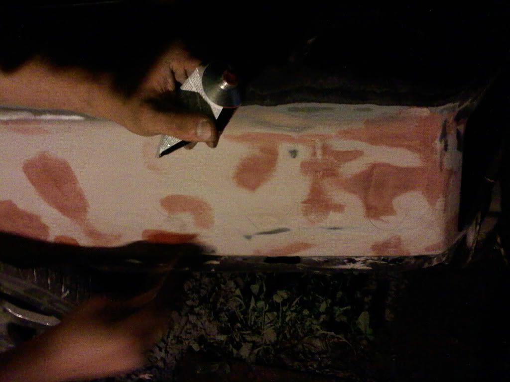

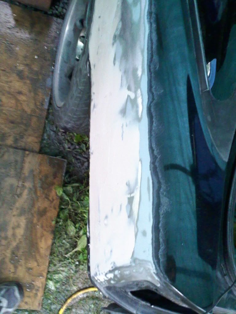

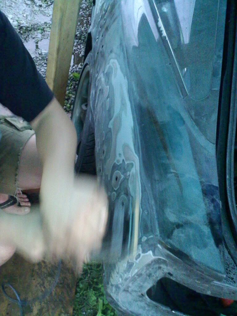

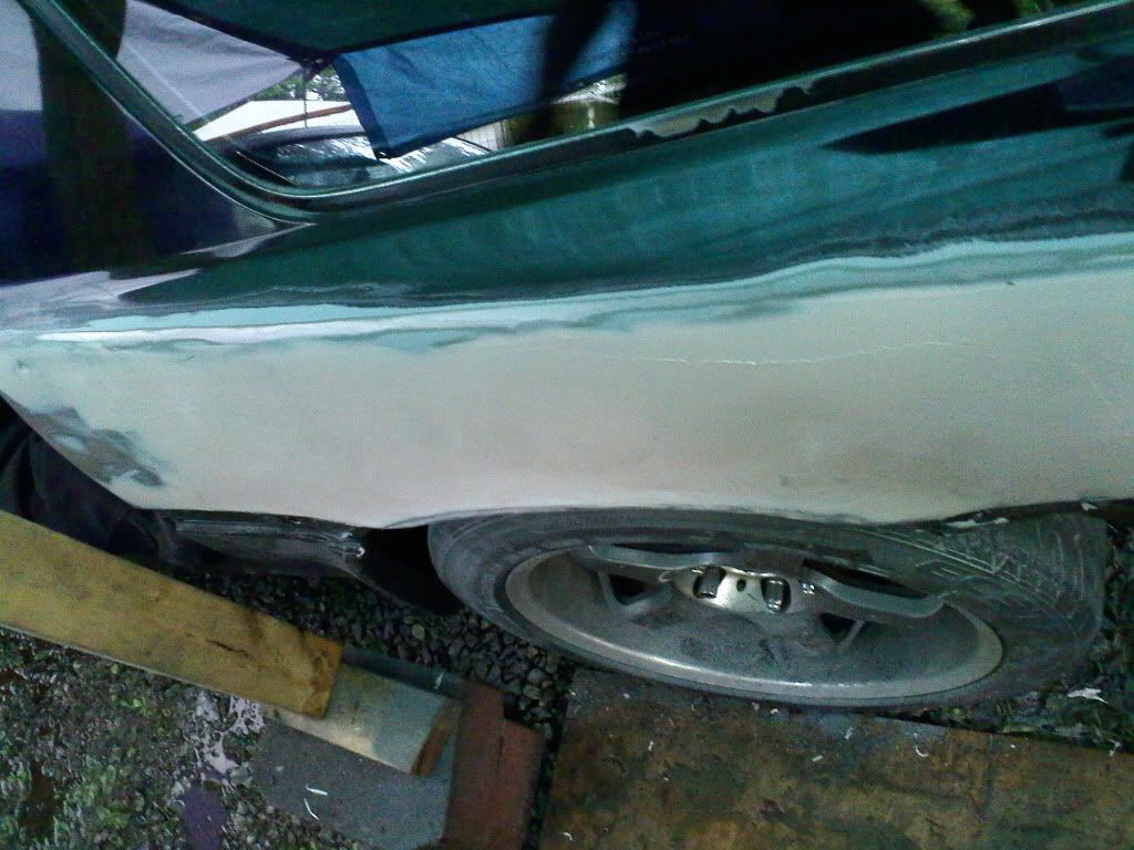

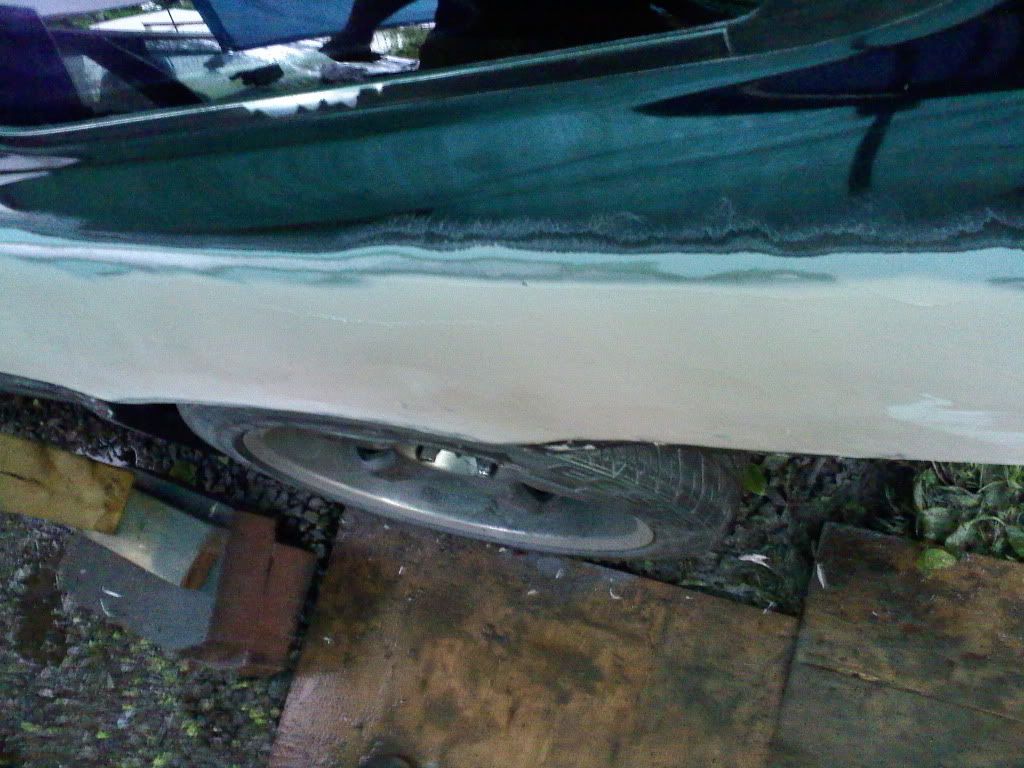

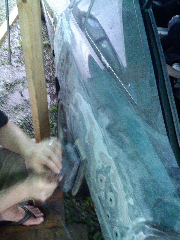

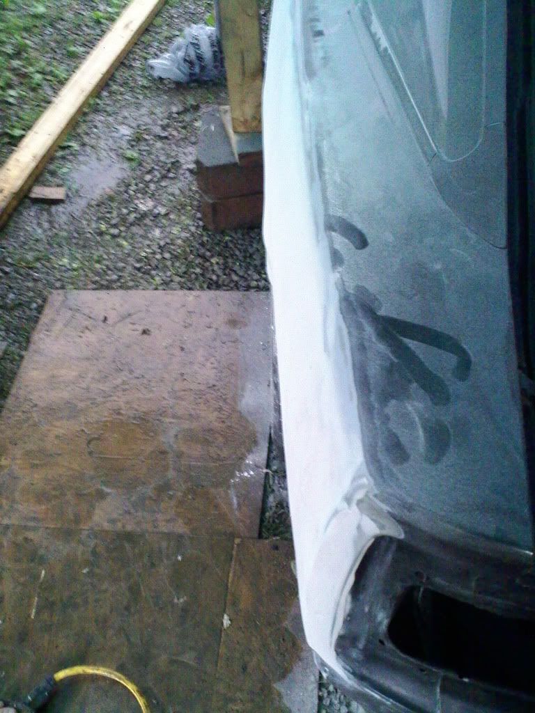

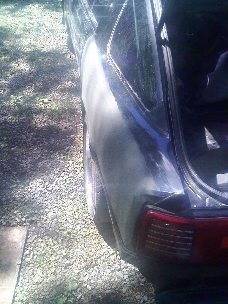

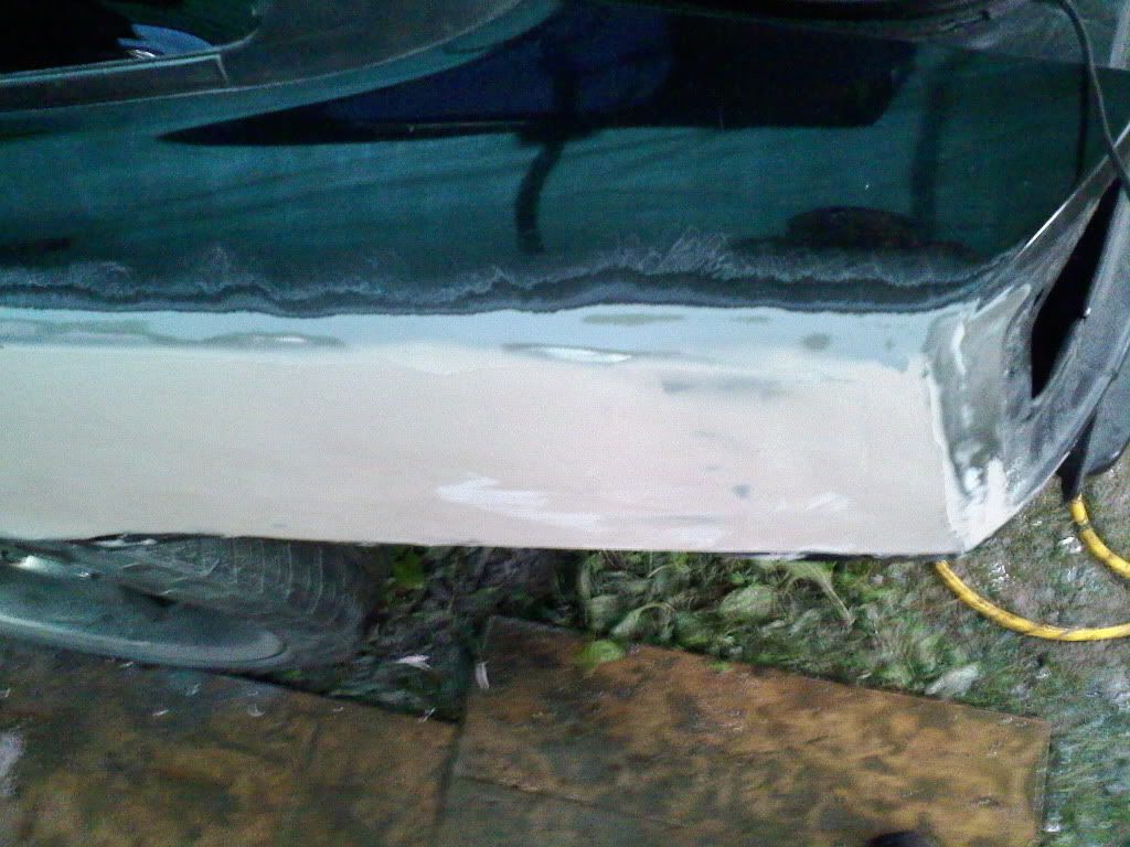

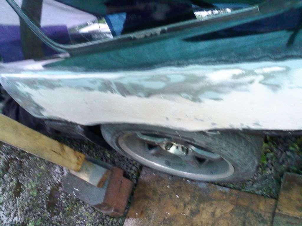

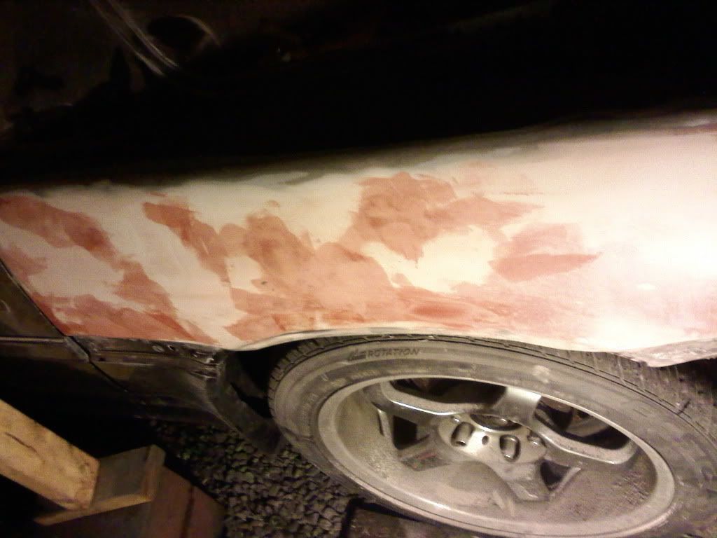

Well, during the worst flood Nashville has ever seen in history. My brother from another mother WesPatt and I worked 21+ish hours on repairing and reshaping what was left of the quarter panel.
We succeeded and I've never felt so happy with seeing Army Green self etching primer on this car in my life. I am truly amazed at how well we were able to get this thing back in shape. Wes is the one who should get all the props, I was more muscle and tearing things down as I'm about as knowledgeable on body work as I am with underwater tennis. So On to the pictures.
Remember now, this was happening and accomplished with two days of solid rain and houses floating down I24 here in Nashville. I don't have a garage and didn't drive it up to my parents to use theirs so we built basically a tent garage and it worked quiet well.
Pics:

looks like you guys got some shape back in that quarter. :)
did those puller holes get welded shut? if not, the body filler will absorb the moisture from behind and crack.
might not happen for a few years, just a lil FYI.
SupraMario
I think it was the google
3,467
The Farm
They will be when it goes to paint, the filler is just a temp fix to keep its shape and keep it from rusting.
Put a primer/sealer on the rough repair to prevent rust, not filler, filler absorbs moisture. Why would you go to the trouble of putting in all that mud, shaping and finishing because you will just have to take it all out to find the holes you drilled for the puller. IMHO there is WAY too much filler in that panel. Correct repair for that would have been to do a partial replacement the quarter panel. Would not have been difficult since the inner panels were fairly straight as indicated by the fit of the doors and hatch.
Good effort in taking on the repair yourself, but sometimes, it is just not worth it. Unlikely that this repair will be undetectable, and if so, it really hurts the value of your car. A correct repair would be undetectable and preserve the value of your car.
