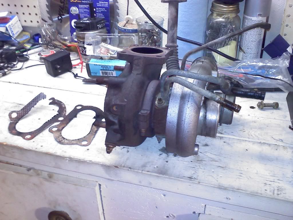

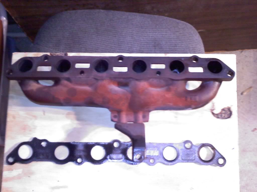

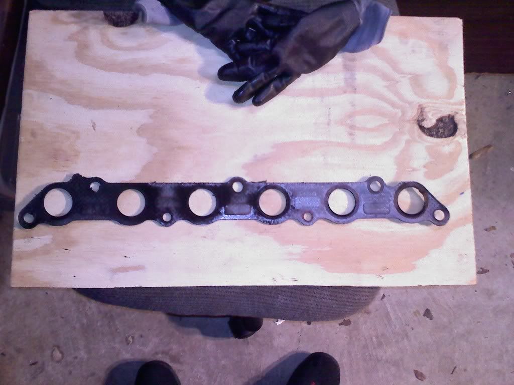

OK got everything dismantled, exhaust manifold gasket and the turbine discharge gasket were both trashed. Pics say it all....

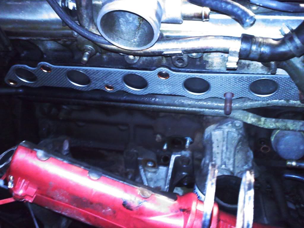

New exhaust manifold gasket --Fel Pro
So far I cant find the turbine discharge gasket anywhere... I'll call a couple more places tomorrow.

^^ I'll second that. They run about $50 retail, but they are worth their weight in gold. Won't blow out like the ones you have pictured. Should be Toyota P/N 17279-42010

Thank you everyone for your input and Toyotanos for listing the part #...you guys rock. I'll be re-assembling once I have that other gasket.

Just make sure that the head to manifold studs hold their torque. Your head looks a lot like mine did when I bought my car(blown gasket/carbon around 5&6), and I had 3 manifold nuts that would not tighten. Looks like you're missing a couple studs too.

on certain gaskets felpro sucks but not all. exhaust mani/turbi, and egr cooler gaskets suck for felpro but most of the other are ok.
the exhaust manifold studs stripping inside the head have nothing to do with the gasket used.

My car had an OEM Toyota gasket that failed from studs pulling out of the head. I was just noting what I saw in common with both of our cars(the soot around 5&6).

I've never had any problems with Fel-pro, of course my other cars were not a Supra either. All my studs appear fine and no threads are stripped. They all came off as they should and were very tight. I did have a friend of mine who is a master ASE helping me with the job, and figuring out the things I could'nt...like the hardpipe underneath the bottom of the turbo that runs to the block.
