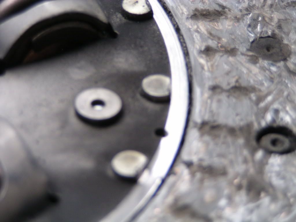

do not use a stock style clutch disc, the center rivits rub on the friction they hold the clutch from fully engaging, i'll post pictures tomorrow,

the friction disk that bolts into the fw, on the id about 1/4 inch the rivits rub

it will work but you need to have the inside of the steel friction taken to a machine shop and enlarged.

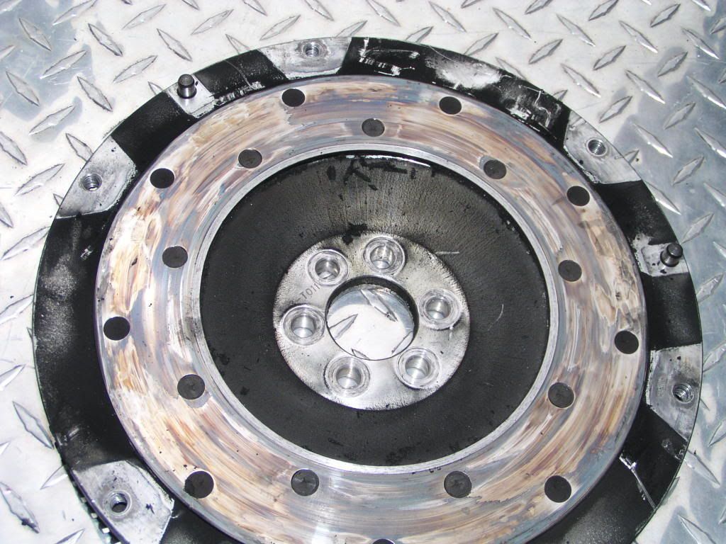

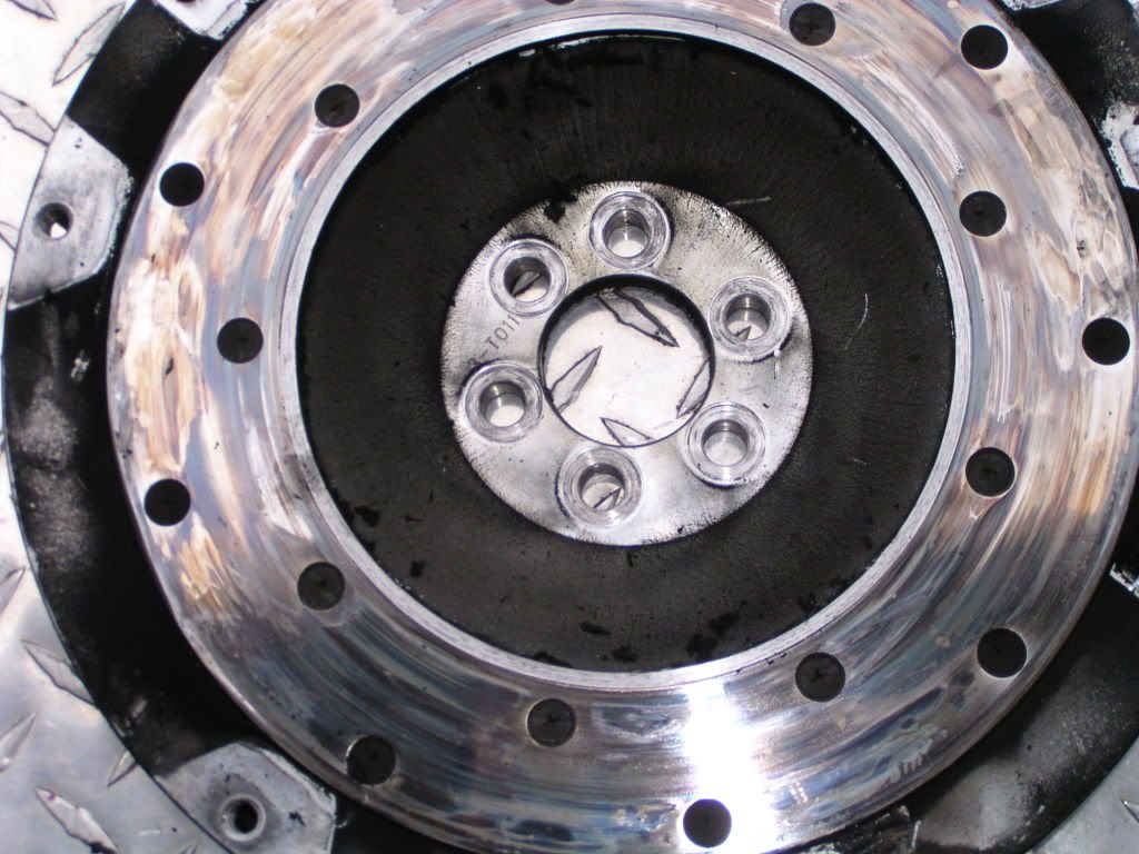

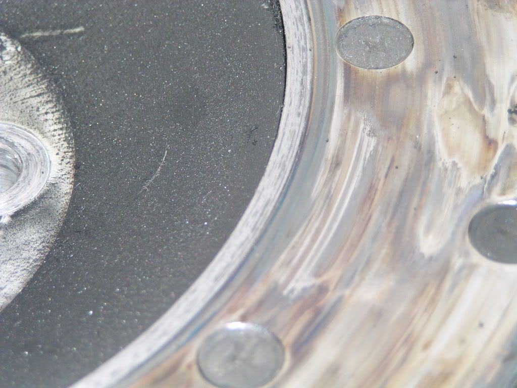

notice the ring around the center?

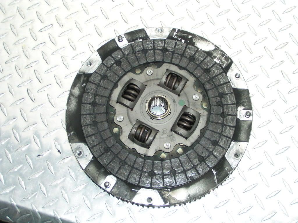

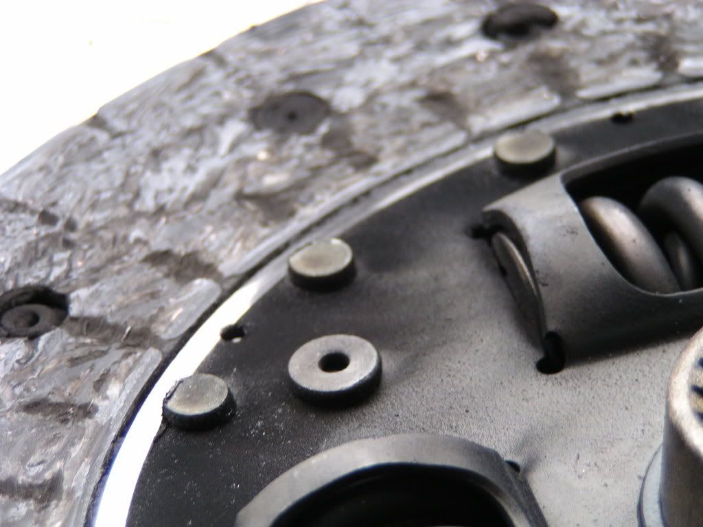

and here's the pics of the clutch with rivits..

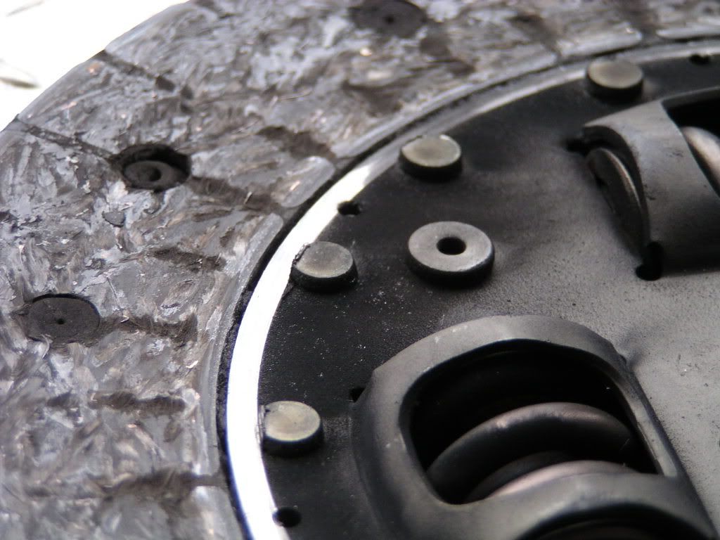

and one last of the reverse side with no rivit damage..

You're showing a pressure plate and friction disc, where is this fidanza flywheel you were talking about? Did you mean the pressure plate?

mmarkk said:
Well this looks like the same issue i had
pimptrizkit: why didn't you notice the rubbing before installing the set?
well i didn't put the ring up to the disk to check,
and when i put the clutch together i put the pressure plate and clutch disk on the tranny input and the flywheel on the motor, bolted it together and then assembled the clutch,
on start up i couldn't get it into gear and i did hearwhat i thought was the clutch disk barley touching the flywheel and PP, so i fought with getting my clutch pedle freplay right, whitch took me a few days cause i replaced the master and slave before i adjusted the clutch pedle,
after this i never had any issue with it other then i wasn't satified with the time i ran, on the 1/4 my best time was a 13.9/14 flate with a 5spd, and i have gotten 13.5's with my auto,
once i get my new pressure plate and friction into flywheel i will be having them re-balenced before it goes back into my car.

looks like it actually is hitting the friction surface, so a new friction surface would have to be machined as well...
