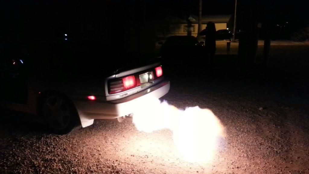

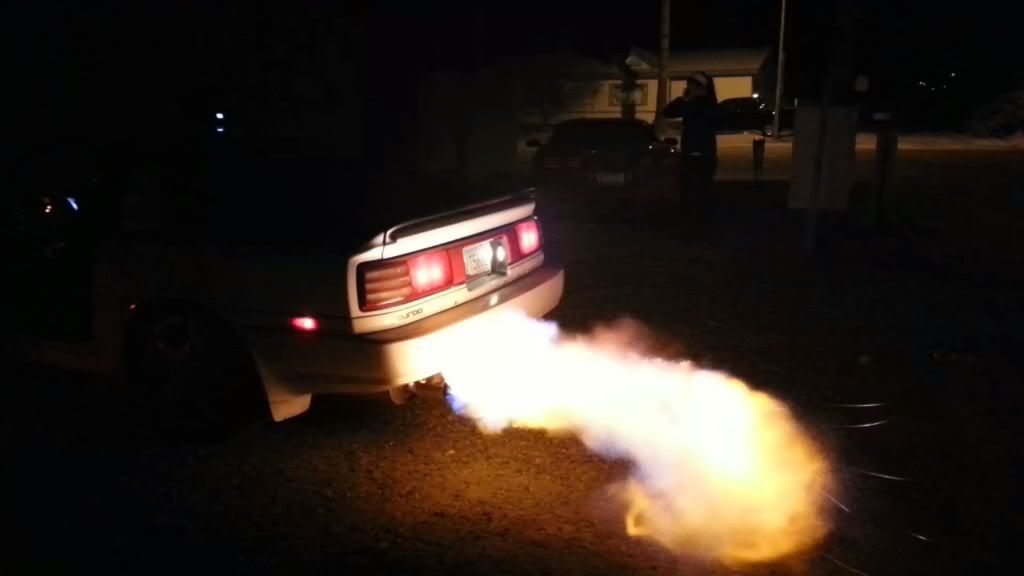

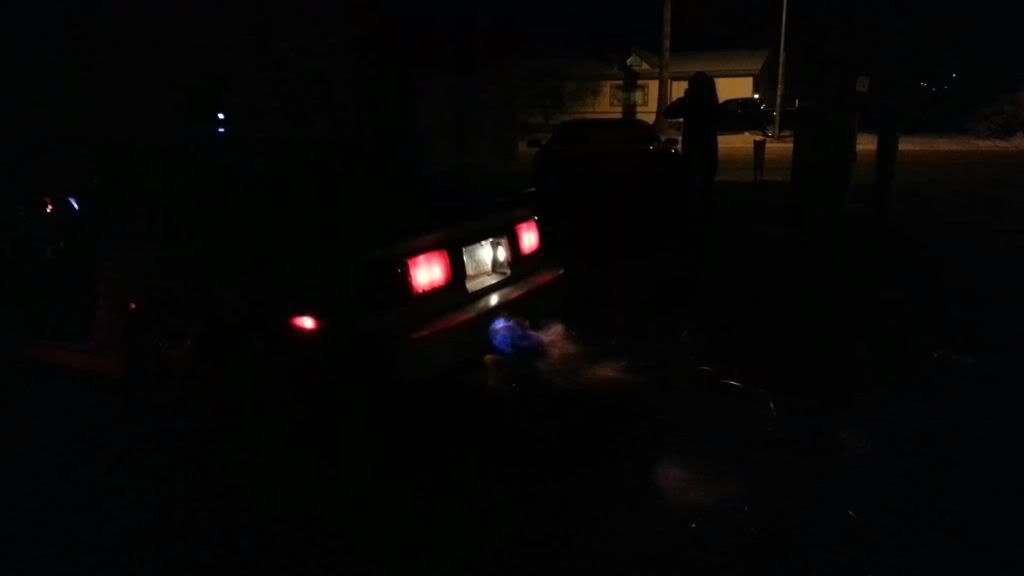

Set up the anti-lag kinda....
[Video=youtube;Gvs5FlHCxv0]https://www.youtube.com/watch?v=Gvs5FlHCxv0&feature=youtube_gdata_player[/video]
[video=youtube;a9wLlOFeF7I]https://www.youtube.com/watch?v=a9wLlOFeF7I&feature=youtube_gdata_player[/video]

maybe your fireballs burnt the turbo :sarcasm: but realistically, any escaping exhaust gases will hurt your spool, so check and retorque turbo bolts, manifold and WG
