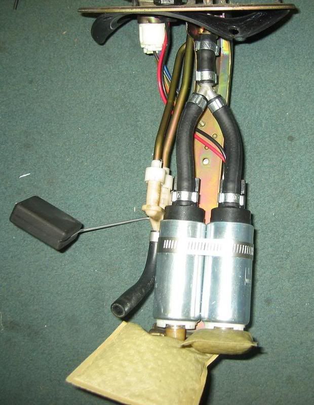

looks something like this:
I'm just about to do this myself for my 1JZ.

That's not my setup. I just took the picture from the internet. But you do need to run more power. Run something like a 10ga wire to the tank, put a 30A relay there, and activate it off the stock line running to the tank. As for hose the setup I pictured was for a WRX, and they did use the stock hose. The bracket is the stock bracket that held the OEM fuel pump in the tank.
