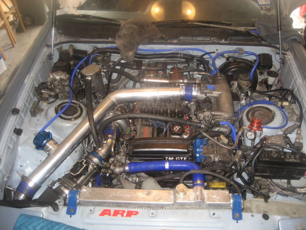

Here are some pics:
I'll post some more pics of the car when I get off work.

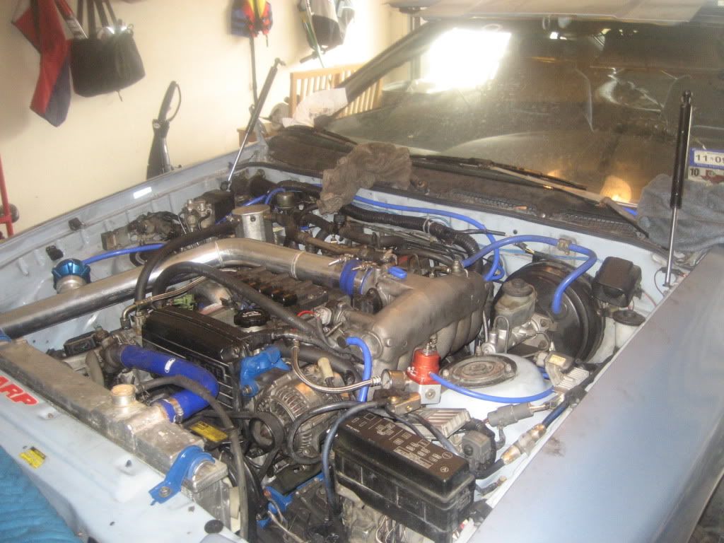

Thanks! I changed the oil this morning before work, fixed the speedo and got my wideband to work. so all is good now, and running pretty good.

One problem that I am having though is vacuum is a little low. The Gauge is reading about -18in, I don't know if it is my timing or vac leak. I have to get timing gun and check it. I looked around and double checked all of my piping and it all seems to be fine??
Also when is the earliest that I can start to tune the car? I just want to make sure that I'm not running too rich and messing anything up. Right now I'm running my Lex AFM with my 580's. I have my safr unplugged for right now.
Any suggestions guys?

On a fresh rebuild around 18 should be fine from what i've heard. You can have a driveablity tune put on it right now because you don't need to be WOT for that and it'll be in the lower rpm's since you aren't supposed to see more than 4k during break in. You having any studdering or dying problems?

Yeah it's stuttering a little bit. I have been trying to figure it out. I think there may be a leak on the intake manifold some where. Going to get a timing light tonight and time it and see where it goes.

I just found out that I have fuel leaking from my #6 injector at the rail, so I have to fix that this morning, also going to swap out my plugs too.

Well, I got my fuel problem fixed I hope. With the PTE injectors there is a lot of room for play where the top O ring goes, so I put another one on there. There is a little play but now they fit better in the rail.
Now I only have the Code 41 and now that pesky 51. I'll figure it out though.

I'm still getting this 14 code but only when I'm driving around normal. It seems like it's a vaccum leak at the manifold, but I can find one. My gauge at that point goes from -20in to -18-17in vac. But it's only when just crusing around, when in boost my car does perfectly fine. Only boosting to 10psi right now and only to 4-4.5k rpms. I've got about 700 miles on the car and will start tuning at 1k miles.
