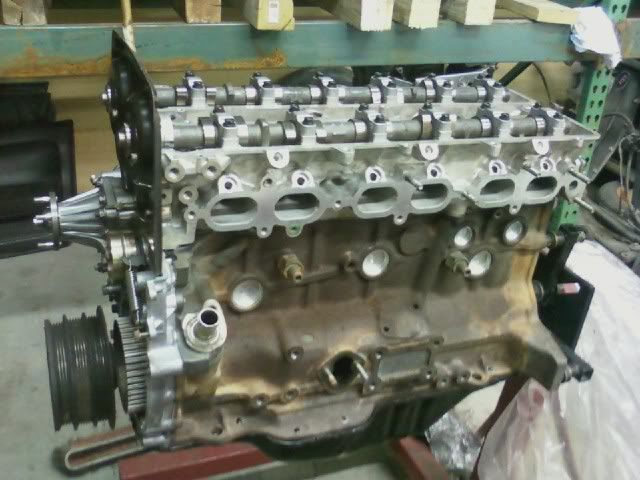

I thought I'd have them done tonight but it takes a good while to sand each one down clean..
I got about 6/10 of the plug hole walls finished with 320 sandpaper till they were clean and super flush with no burrs.
I actually feel confident that they will all seal perfectly when I'm done tho :biglaugh:

Ok, so bit of a thread resurrection, but it's on topic.
The machine shop that hottanked my block punched this one out with the rest, so I just picked up this plug from Toyota and its concave.
1) Is it suposed to be concave?
2) If it is, is it supposed to curve into the motor, or out of the motor?
As for installation...
[QUOTE="IJ.]I don't do enough to make or buy the correct tooling, what's VERY important is to get the plug in with a minimum of hits, a few small taps to centre it then 2 hits to seat it if possible (takes practice) If you use a LOT of small taps you end up peening the crush out of the cup and it will blow out as the engine heats up.[/QUOTE]
Any other tricks, or is it just a matter of getting a simple process perfect?

Meant to curve out and be staked in place, I don't replace that unless I 100% have to.
Only additional advice I can give is if a plug is even slightly suspect after you fit it pop it out bin it and try again, this job has to be 100% perfect the potential for disaster is very high if one falls out.

Damn I don't have a good pic showing the factory stake job, it's intentionally peening/mangling the material of the block that surrounds the convex plug, you can see it easily if you have a block there.
