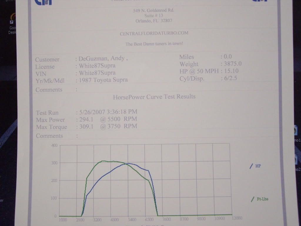

Here's mine with stock ecu @ 12psi with bpu and walbro 255 pump. I'm in love with the twins as you can see :love:
It's just as I described it.

Look at both dyno sheet and see for yourself the power curve.
Now if someone with a fully turned 1jz running a standalone can post up a dyno sheet, you will see that the timing has been tuned and lag is now only present because of the size of your backhousing. On a .68 a/r you should hit 20psi around 37-4000rpm, which is consistent with What hottscennessey said regarding quicker spool due to tunning.
