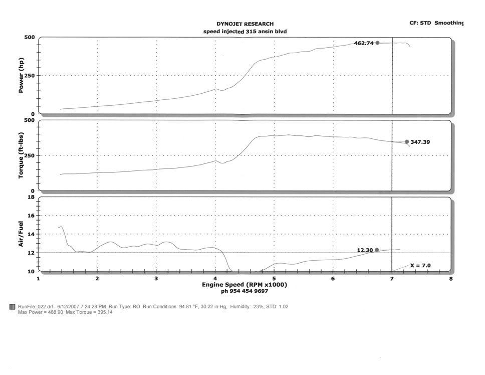

Here is my dyno sheet. If someone has a stock twin dyno sheet to compare, would help clarify my findings. Add or comment on this as you wish we can all benefit from this info and whoever else can add to this.

I dont think its that so much, I'm sure it plays a role a little bit though. But the timing map is based on load and rpm. If the ecu sees 15 psi by 3000 its going to run lower timing, but I'm sure at 0 psi its still around where it should be. No doubt you can gain some lower end from adding a few degrees while it spools, but its not going to be a drastic difference. The 1j just is gutless without boost ;)
I also think the soarer ecu is more advanced in handling timing better then the jza70 ecu. The 1j seems to run stronger under a soarer ecu. (compairing stock vs stock ecus)

This is a very nice write-up, I am glad to see someone other than me understands timing. haha. I can testify to this fact, I have a non-ball bearing GT35 on my car and thing looks just like the dyno graph above. The timing on the 1JZ is very conservative, I have a buddy in Japan that put a standalone on a BPU 1JZ Supra and just with very good tuning of A/F and timing, they gained 50rwhp! So there is a lot of power to be seen from good tuning with timing control. Imagine what type of power gains you will get if you were single turbo!

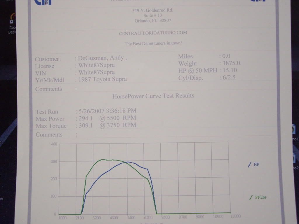

Here's mine with stock ecu @ 12psi with bpu and walbro 255 pump. I'm in love with the twins as you can see :love:
