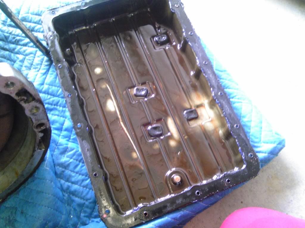

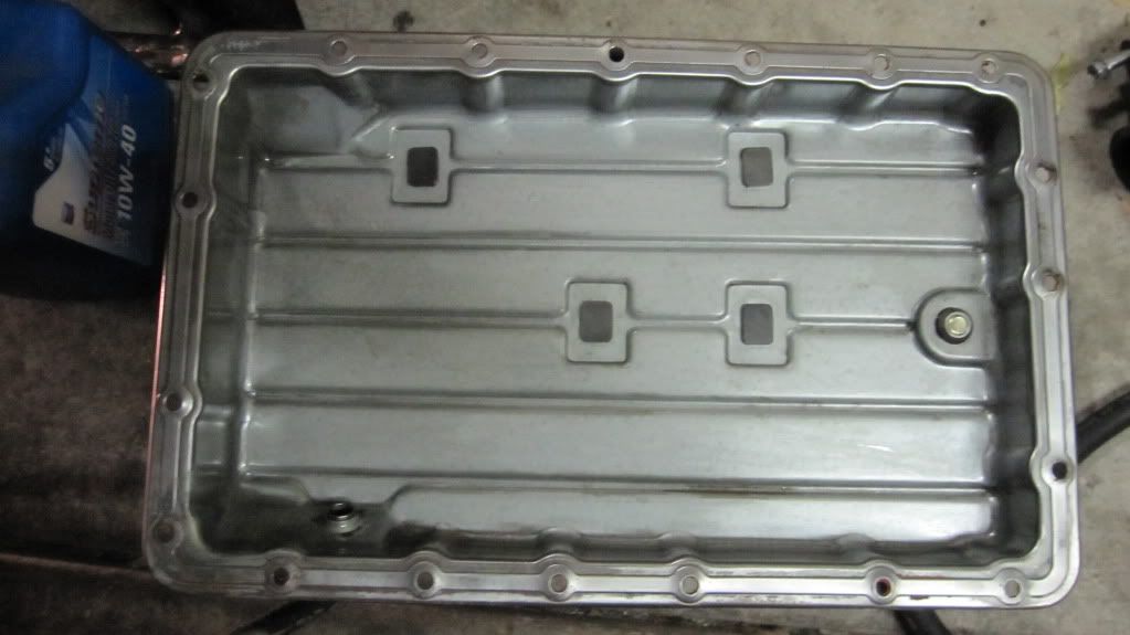

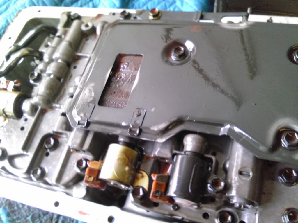

So when i was adjusting my line pressure cable it got stuck, so I was wiggling it and pushed on it and it popped off the cam lever inside the trans.. So I had to pull the pan off, Got the cable hooked back up and decided to do a new filter and pan gasket while I was in there.. Changed the filter and put it back together.. After the job was done I had nothing else to do so decided to take the old filter apart to see how dirty it was.. I was surprised to find a completely clogged filter.. I am excited to find out what the new filter will do for my trans and shifting and driving performance.. The previous owner had the transmission rebuilt in 2004, I don't know what or why but I doubt the filter has been changed since then.. So for 17.99 for the filter and gasket from autozone (duralast part number TF147) and a few quarts of ATF its totally worth it.. Anyways this thread would be worthless without pics so here they are!

Why "surprised"??
At best most of these cars will have been flushed and have never had a proper service, it's amazing any of them still work ;)
Don't forget to clean the magnets when you're in the pan, a low cost "Mod" is a Cruiser Pan and Filter Screen it add's a Qt of oil.

Thanks IJ, Yeah I cleaned the bottom of the pan and all the magnets! Nice and clean.. Im just curious if I will notice a difference in shifting at all with a not plugged filter..

Just drove the car with the new filter and fluid, It definitely goes into gear faster and has a firmer shift at WOT! Now I just need to fix the freeze plug that popped out :(
