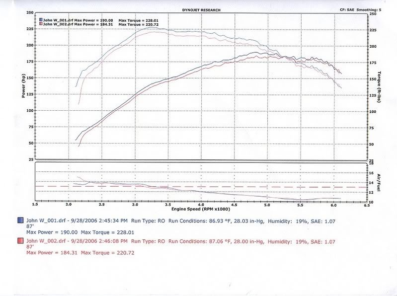

Stock USDM 7M-GTE...

Jeff Lange said:
Stock 7M-GTE will put down about 200rwhp, and is rated at 230hp at the flywheel (232hp for 89+).
Give or take a dozen or so. And that is a good point anyway. RWHP is what you really have. Not what you read in a magazine printed 18 years ago.
The markets that come with out EGR, have different programming than the US model. It is in the tune. And it does not increase the power. The US market has a different tuning strategy so power is not lost when EGR is applied.
