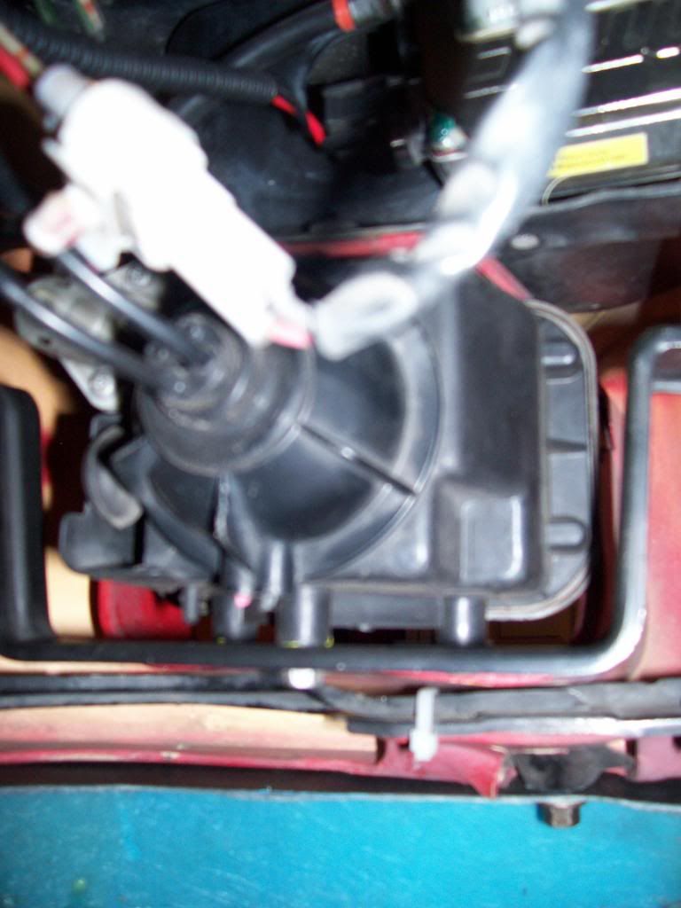

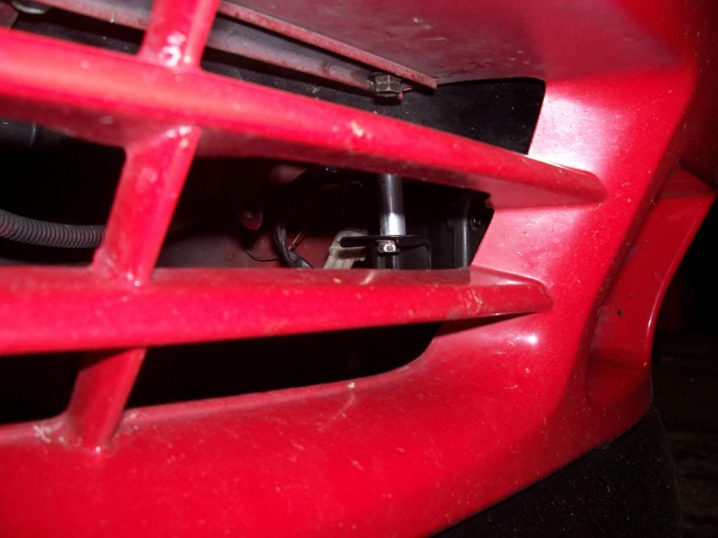

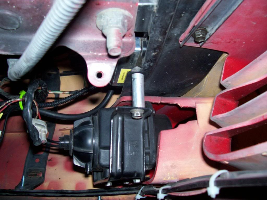

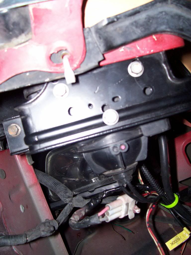

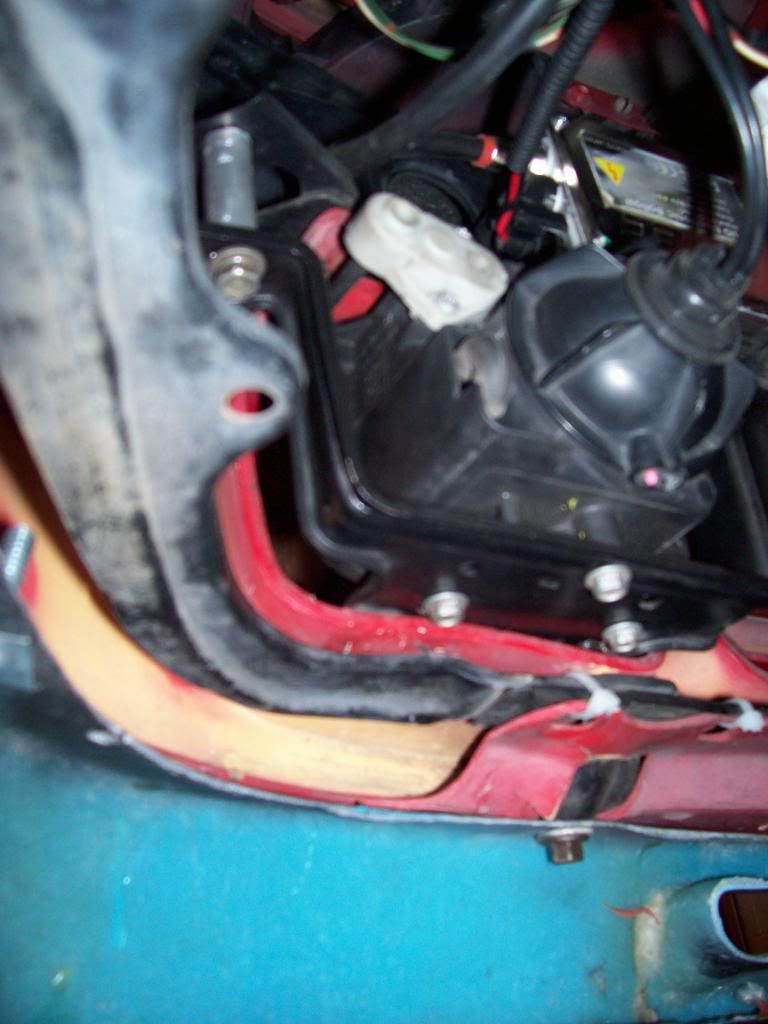

Actually it was super easy.
I switched sides.
I then turned them 180 and redrilled, Used a piece of metal tube with bolts long enough to have sit in pockets trimed off extra and repainted black.
If you need me to I can disassemble them real quick and take more pics.

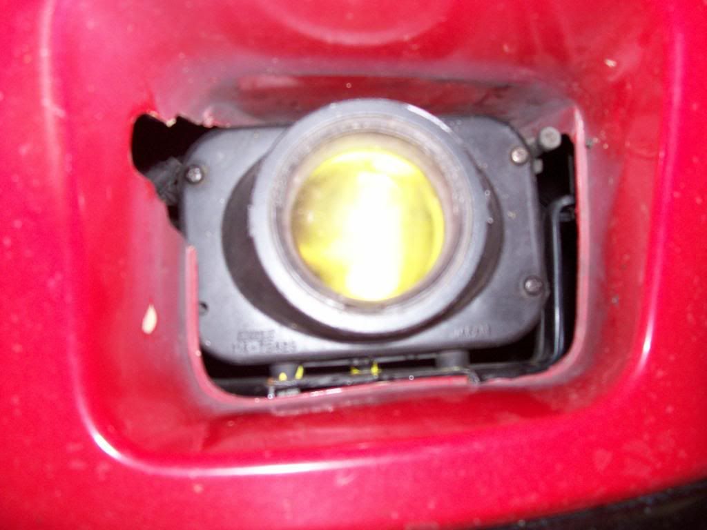

They are indeed from the es300 they are yellow projectors. I used the stock lexus brackets and switch sides r=l l=r they turned them 180 front to back and redrilled three hols to mount light too. I will take one apart tommorow and post pics.
There are two sets on Fleabay right now for under40 usd
