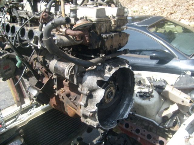

tbcmorris SM Expert Thread Derailer Mar 14, 2007 1,820 0 0 39 PRUVEN PERFORMANCE MILFORD CT Jun 20, 2009 #22 Another MkIII;1348169 said: 2nd page and HOLY CRAP! Getting red loctite tomorrow. -AM3 Click to expand... Sorry I have my settings at 40 posts per page. Unfortunetly for me those were loctited, that failure was caused by something else. But yes use loctite
tbcmorris SM Expert Thread Derailer Mar 14, 2007 1,820 0 0 39 PRUVEN PERFORMANCE MILFORD CT Jun 22, 2009 #23 heres that pic
