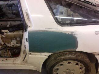

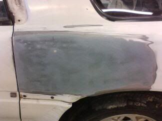

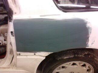

okay here is some progress for the night, i have to take more pictures, i have alot more done then this. But i haven't posted anything in awhile. Sorry if some of them are bad. Some were taken with my phone.

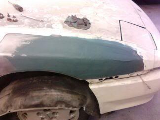

Front Fender before sanding

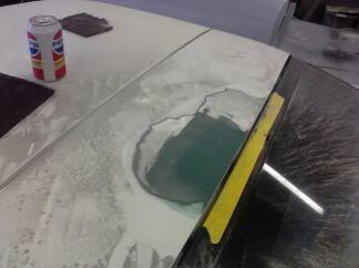

Rear quearter after first coat fiberglass
Second Coat
Above the rear hatch

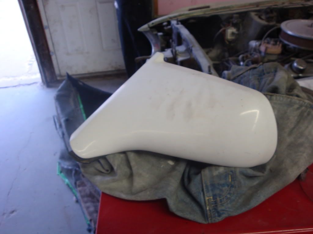

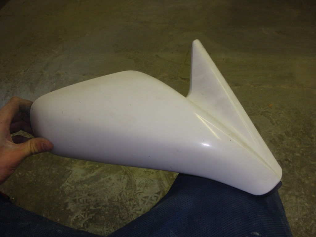

Oh and after taking mirrors off i remembered i have two different mirrors. I have the right passenger side one that looks like this
But the driver side is this
If anyone needs it or has a matching one like my passenger side ill trade doesnt matter what color. Or if you need it let me know.

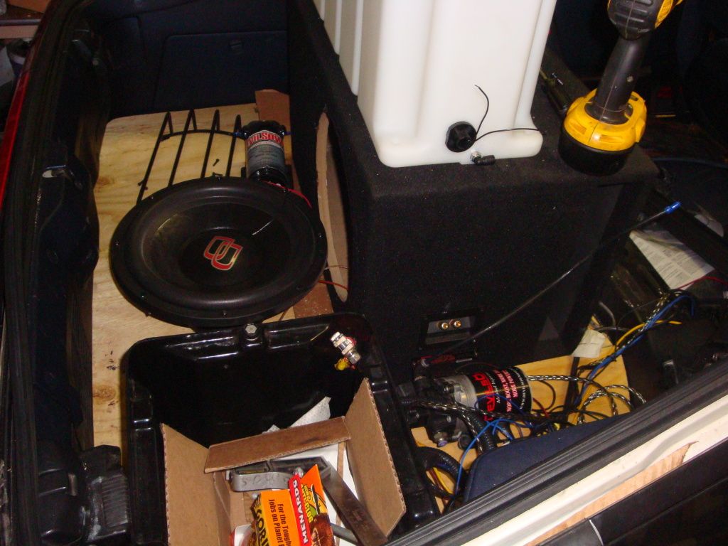

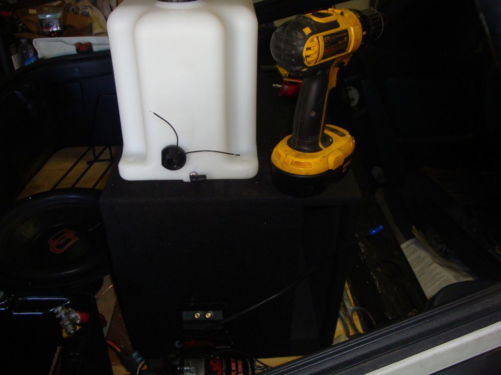

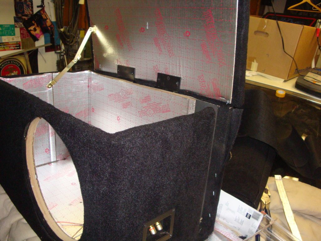

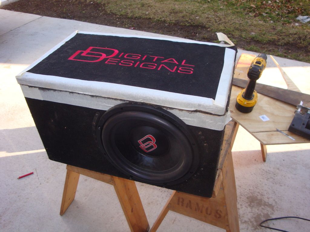

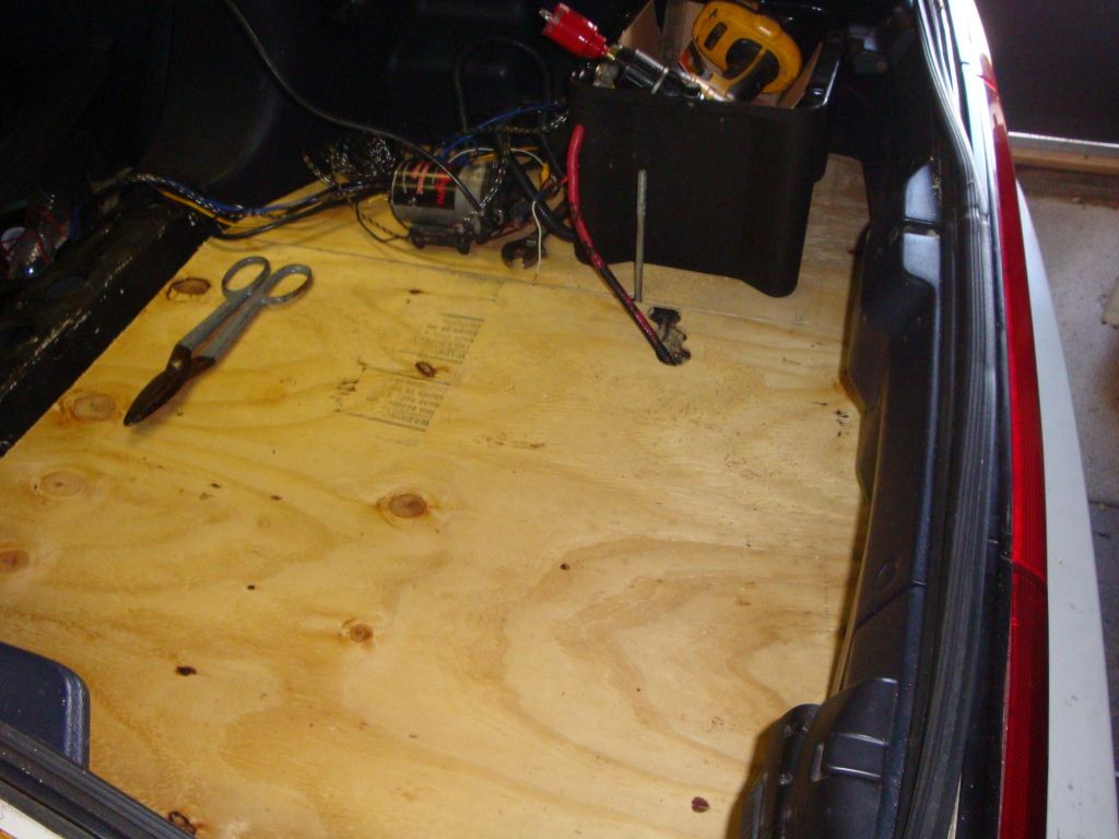

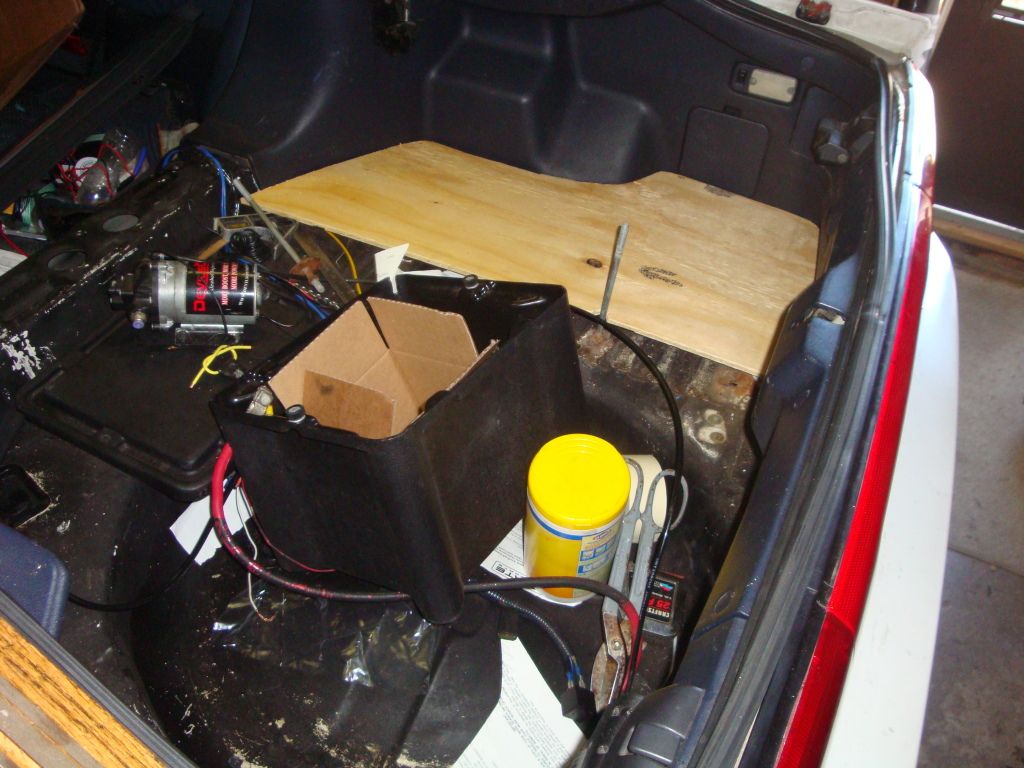

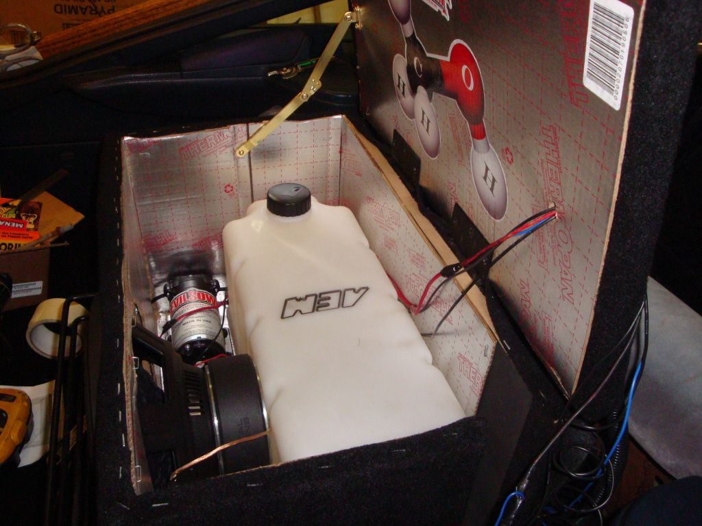

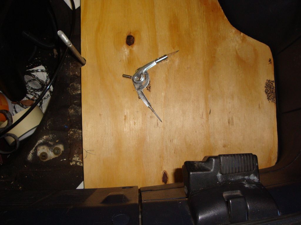

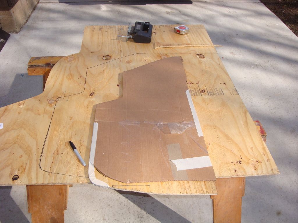

Before I started this new meth setup I needed a back trunk.

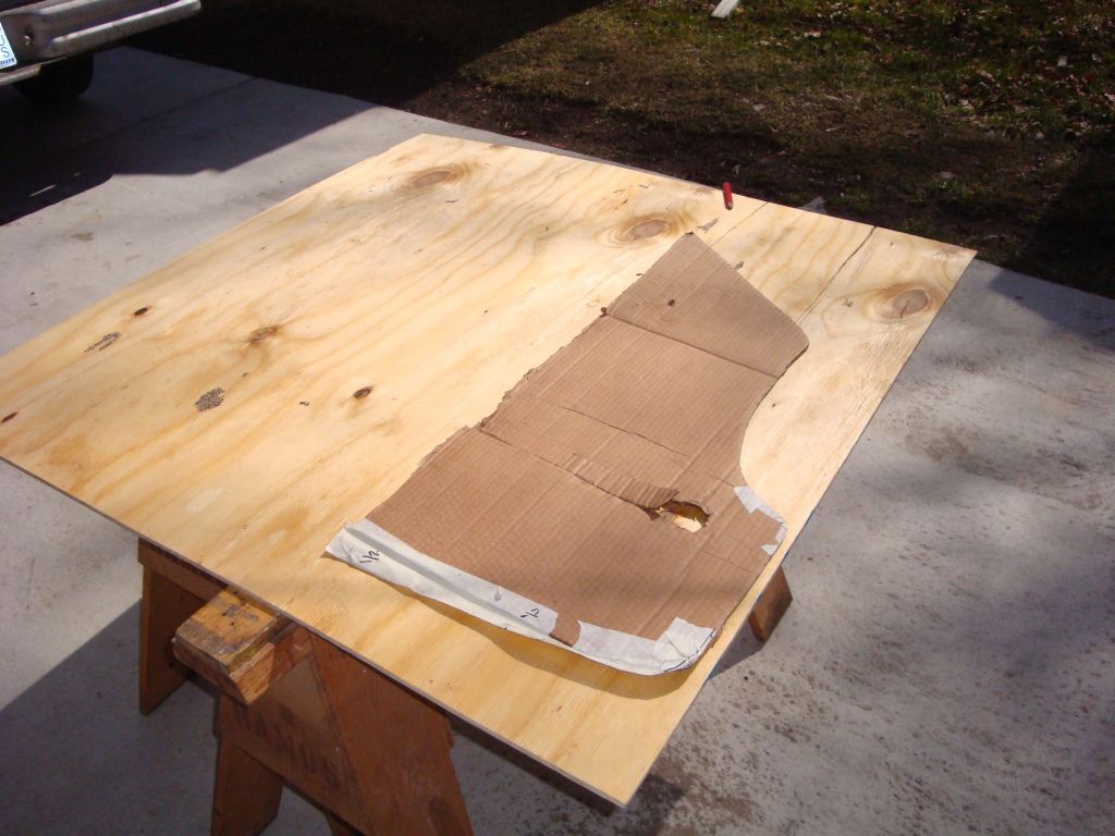

More work than I anticipated

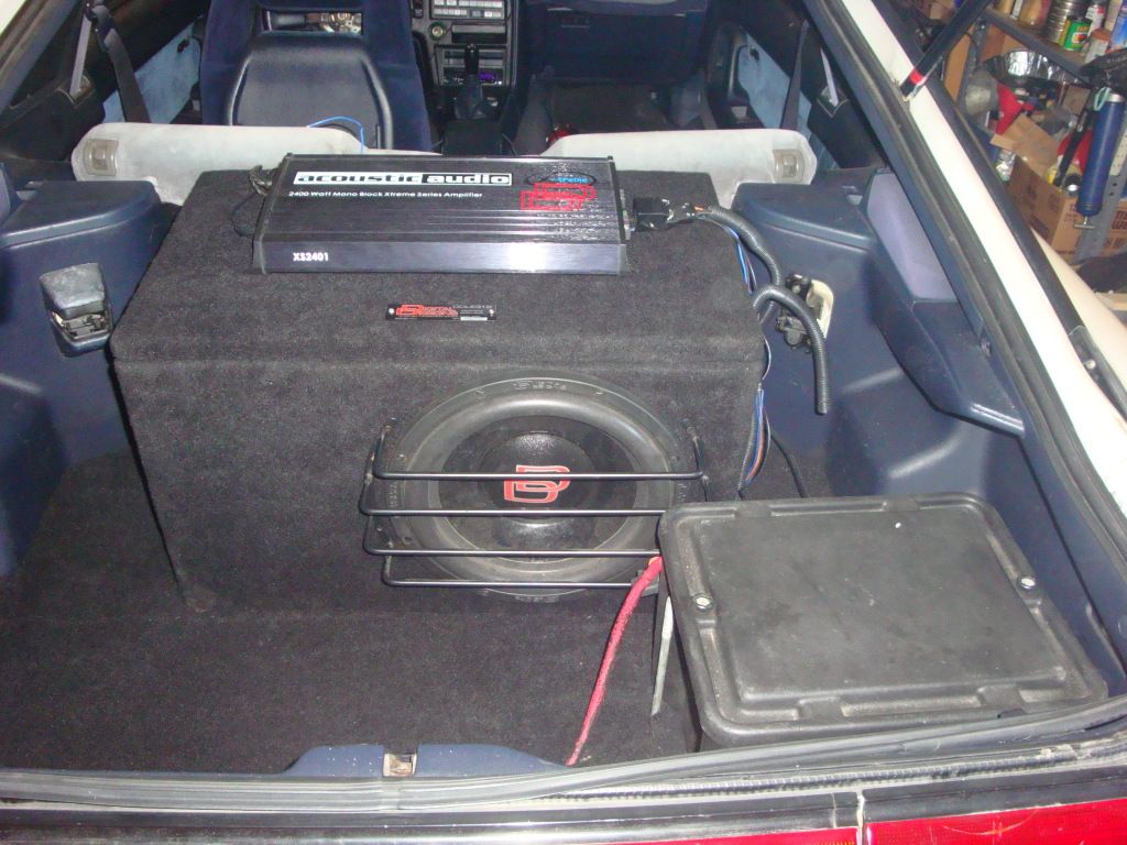

My entire plan for the vehicle is pure stealth. I thought, now how can I hide a 5 gallon meth setup?

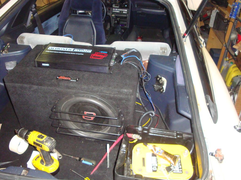

Yep, a False Sub woofer would be perfect!
You'd never suspect it! Honestly think about it!

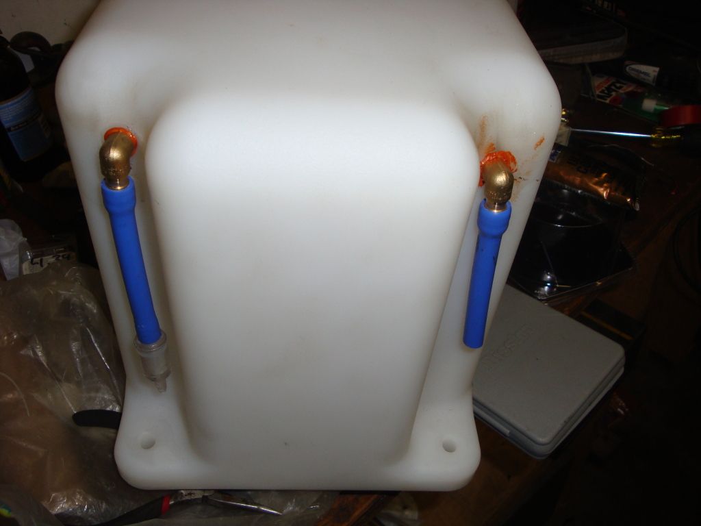

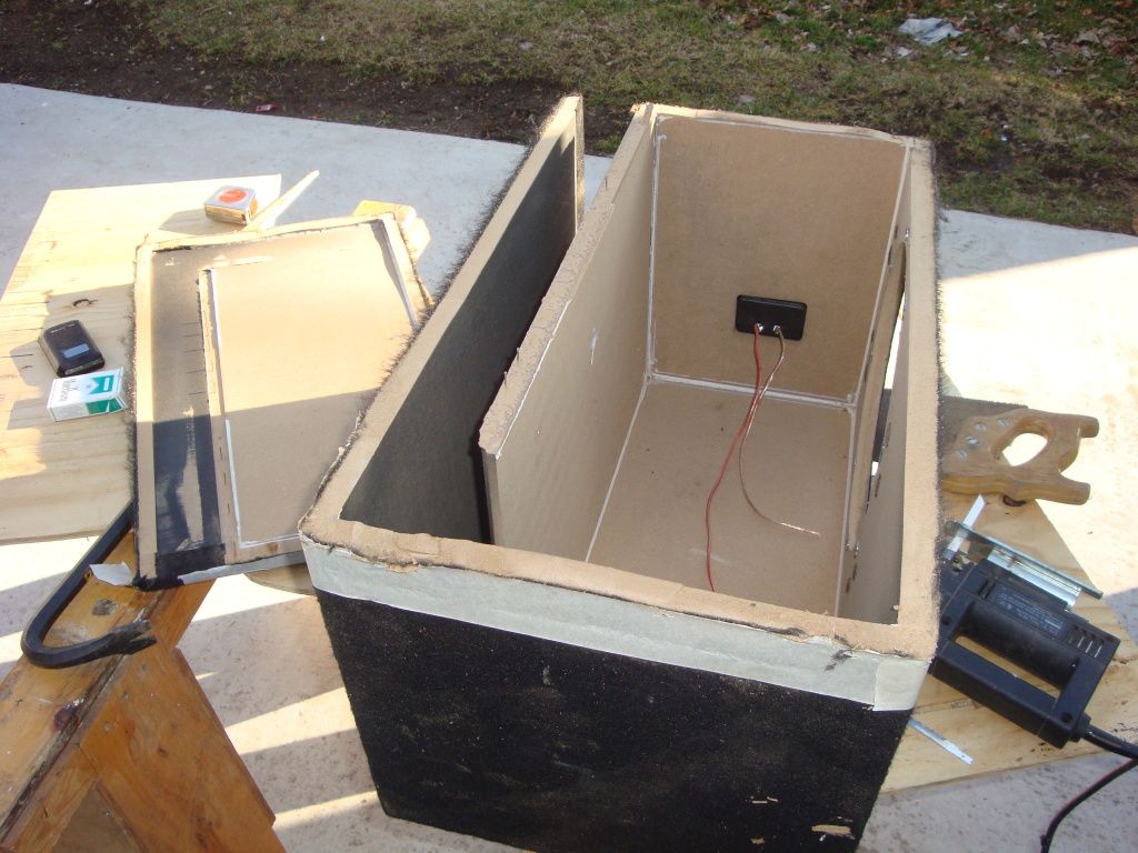

Wanted a PITA free setup, so....hinges.(internal:)
5 gallons of neat meth is dangerous; didn't want any meth to escape.
Check valves allow air in to keep tank from sucking in and caving.
Almost done, more work than it looks like..
Easy fill, box is being reconstructed to barrier tank, air passage will be through box bottom/trunk floor/ spare tire plug to outside.

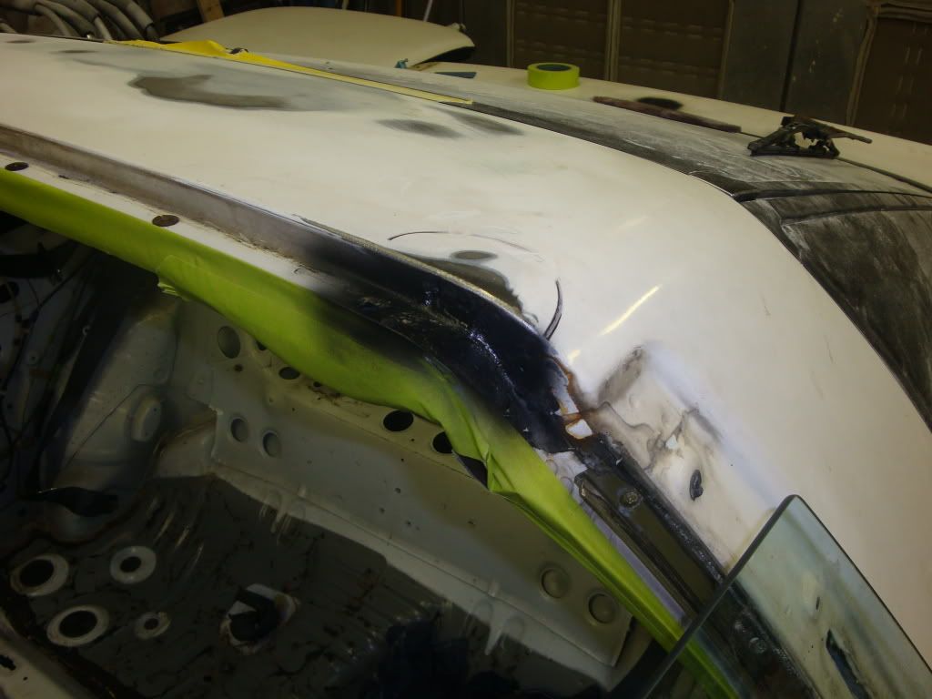

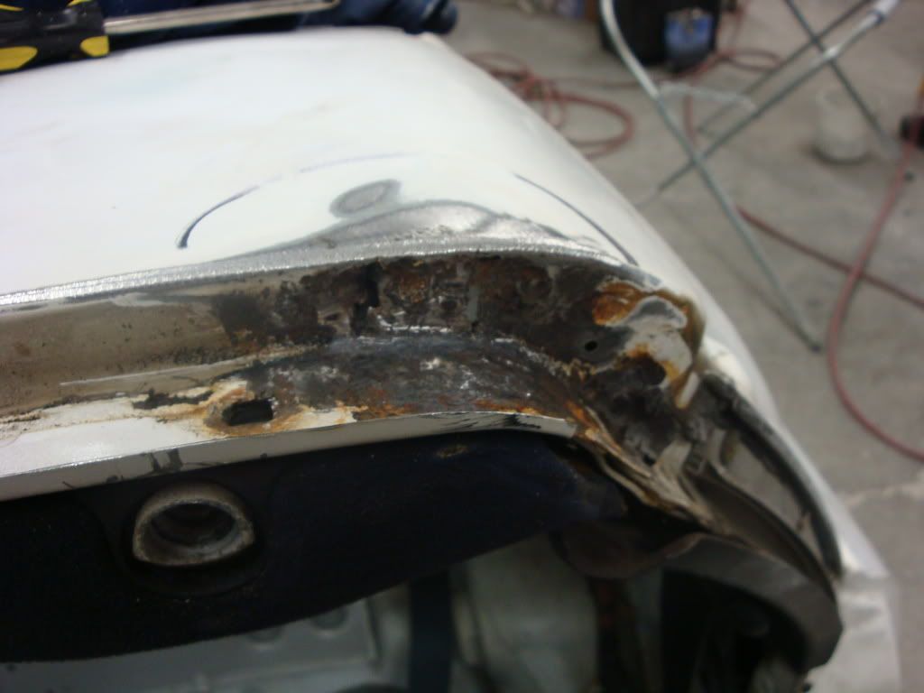

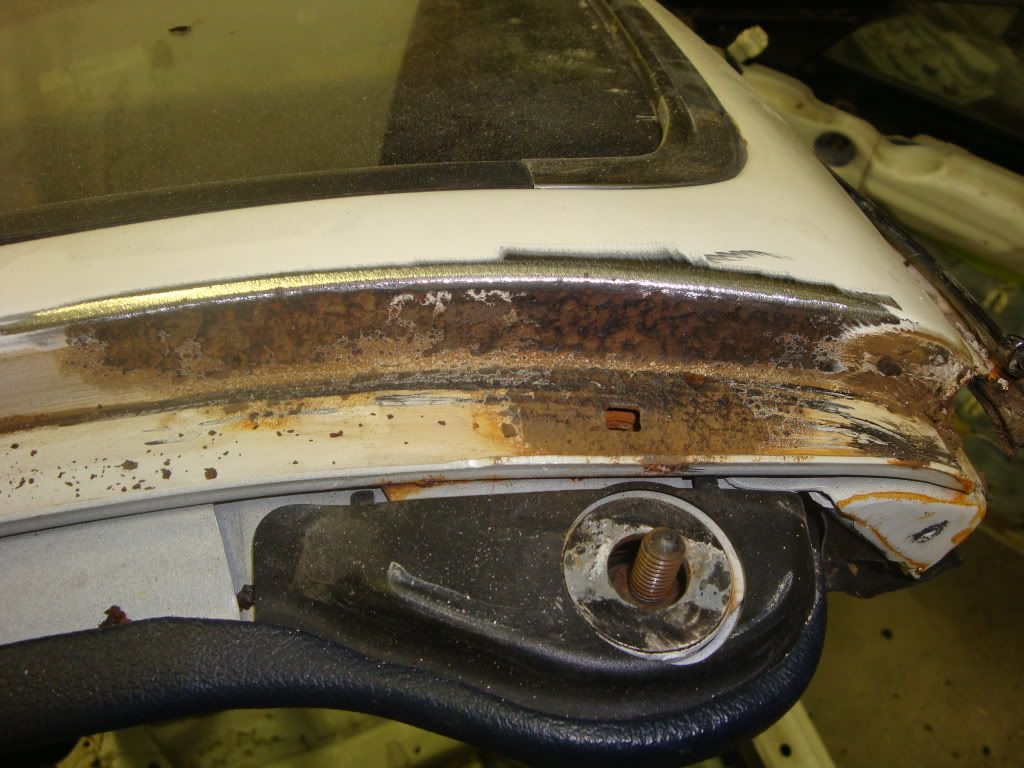

okay i know its been awhile since i posted some progress but here you guys go. Its been over a 100 degress here so havent got a whooole lot done.

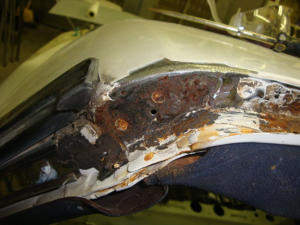

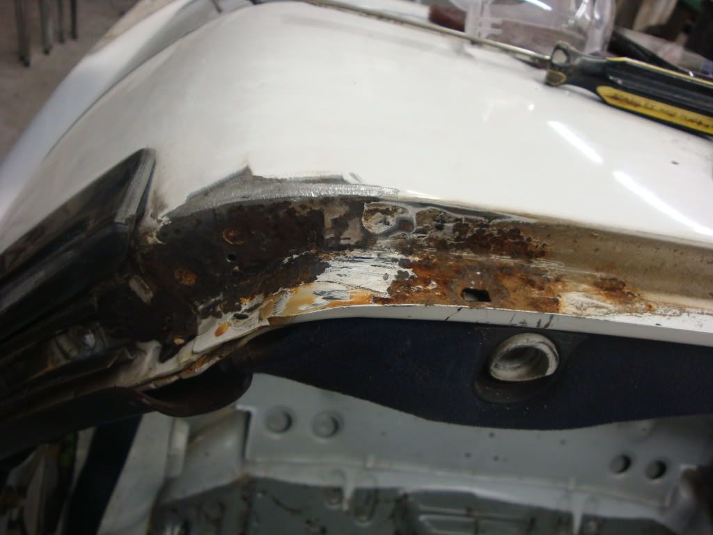

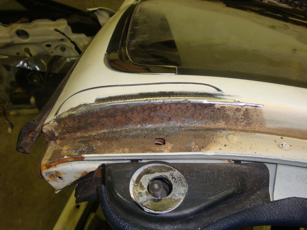

this is what it looked like after i took the targa off
after a little prep
Hopefully i can get to the shop this week. Be patient with me. lol

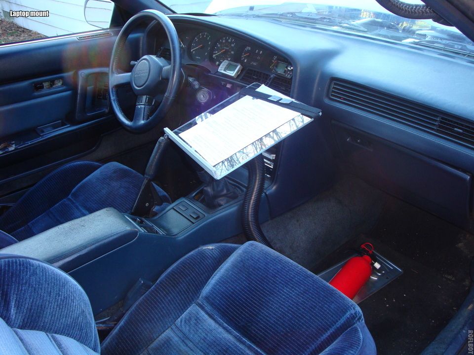

Holy shit, you weren't joking! I got meth in the supra and need the camera to make a new vid! I'm off the next 4 days so ride shotty and watch the Laptop for me! Great progress man.
Dec 31, 2010
216
IL
Took big v for a ride but he doesn't know shit about supra or how to watch gauges, glad we r goin to test drive today, ill tighten couplers. Lol
Tryin to post the vid, we didn't get but three miles and blew a coupler....

Dude, that rust around the targa is nasty! I have some bubbling up the paint on the passenger side. I'm going to end up taking everything off again and redoing it. I think I'm actually just going to grind down the paint and rust until I hit metal, then body fill/prime/paint/clear that area. I need new front window trip along the top >.<
suprakid93
Oct 10, 2011
146
Sterling IL
lol ya but big v helps a little. He screams "Holy Shit!!" and grabs the old shit bar. Thats when you know you were going fast and your car is running good haha nah jp. yea to bad we blew a coupler that day..again.. oh well as soon as you get your new one we'll test it :D
redsupra'88- thanks alot man!! and ya im just lucky to have a dad that restores cars for a living. Nothing better than a little guidance on what to do. Alooot of time though, oh well :)

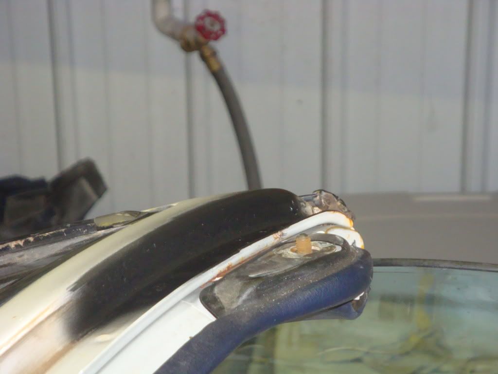

Moy- Haha what meth? its just a sub box officer ;) but yea the rear driver side was all the way through, and the metal is so thin you cant really weld any patches otherwise it will go right through. So what i did was take it all the way down to bar metal (or what was left of it) and shove fiberglass filler in it. The fiberglass will flex and not crack unlike bondo will. It holds so much better. And ya i need all new targa seals that sit on top. mine are not so good of shape :(

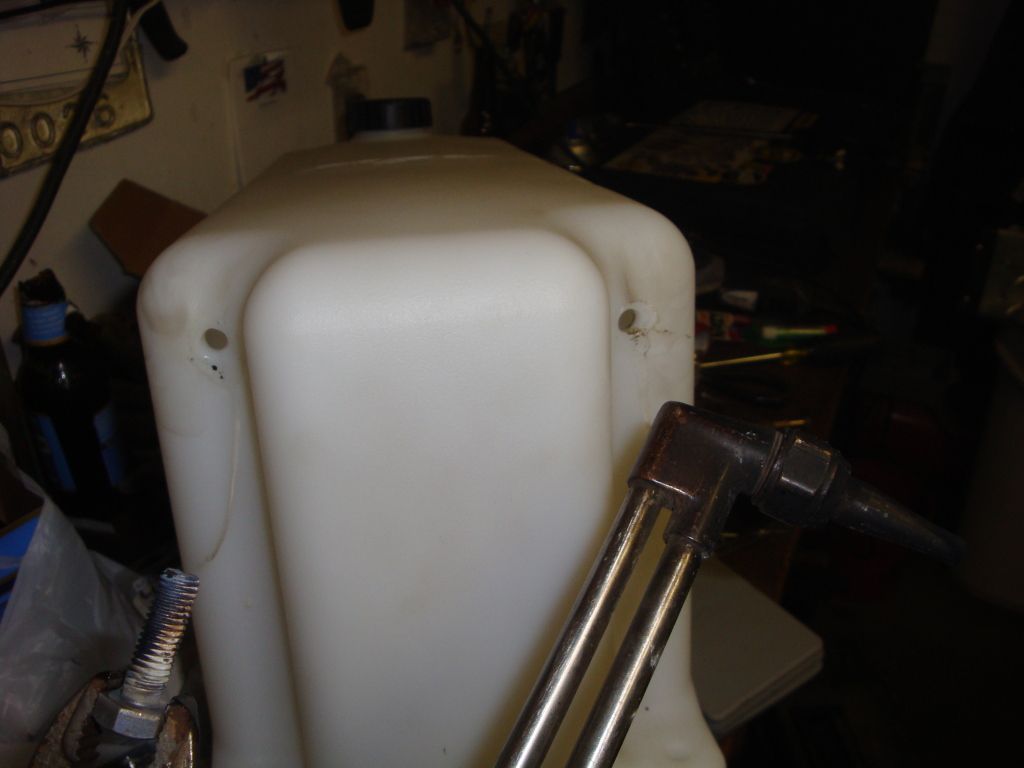

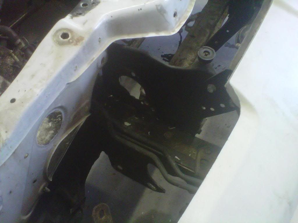

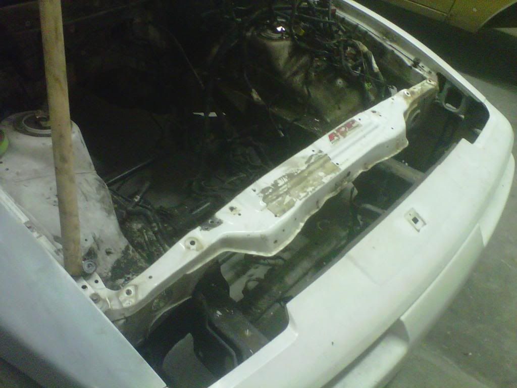

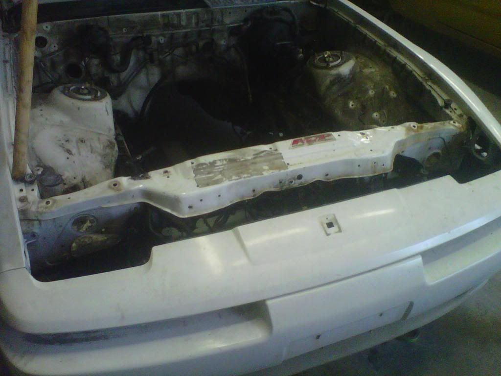

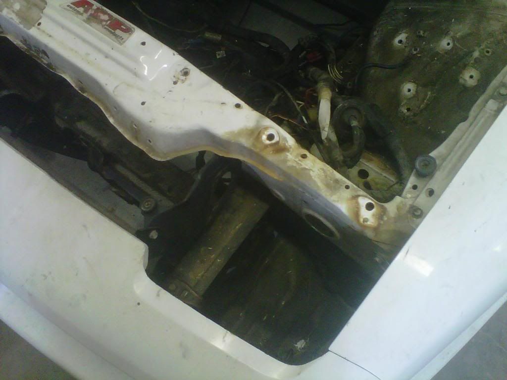

i didnt get any pictures of the body work but im getting ready to block it again for the second time. But i did get dome of the front end torn apart.
thats all for now guys. sorry going so slow..
