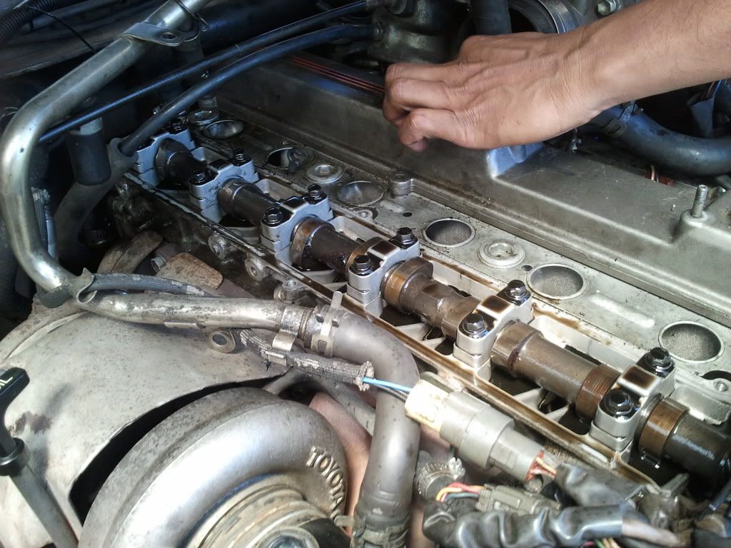

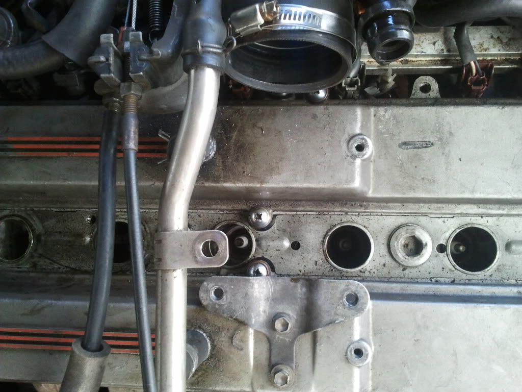

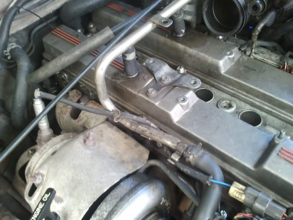

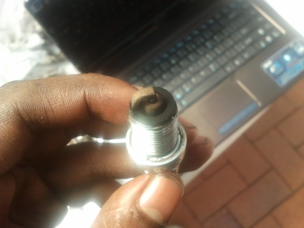

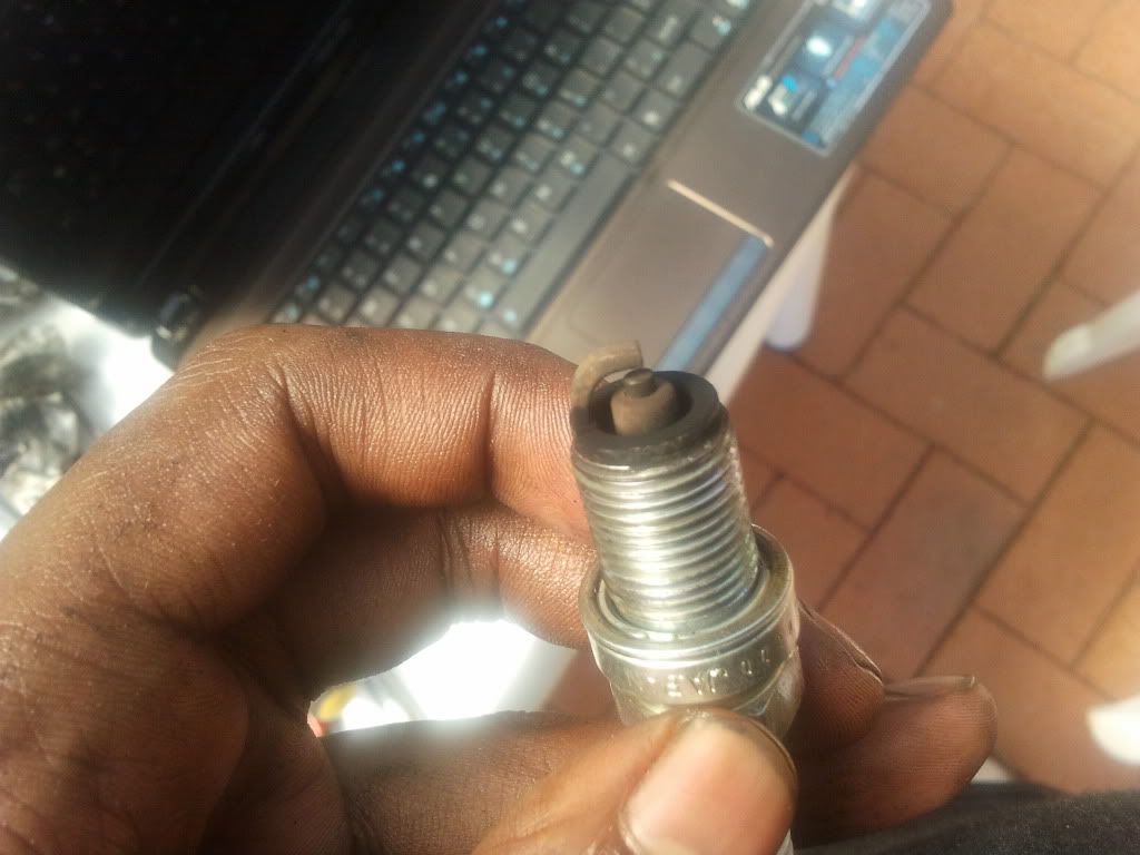

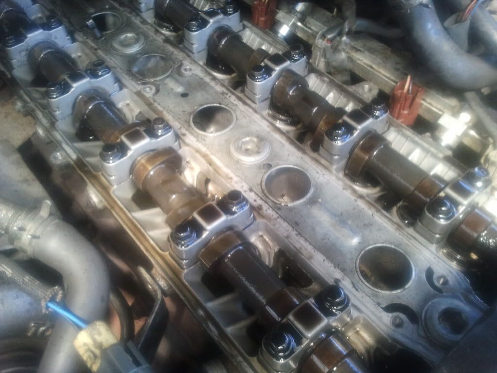

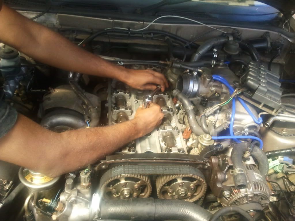

Here are some pics that was taken while I was doing the comp test and replacing my valve cover gasket(as it seemed to be leaking onto my exhaust manifold) -
Notice anything out of the ordinary? Ideas , suggestions?

Sounds like REAR "seal" (ring) on turbo COULD be it. If ONLY/MAINLY on hard DECEL after being on load... and then continuing after slow-down... that COULD be a sign your turbo is "shot". If not a full removal, check for axial play from the front after removing intake side. This can be a pretty quick way to FIND excess play and make a pretty good first assessment of the turbo's condition.
