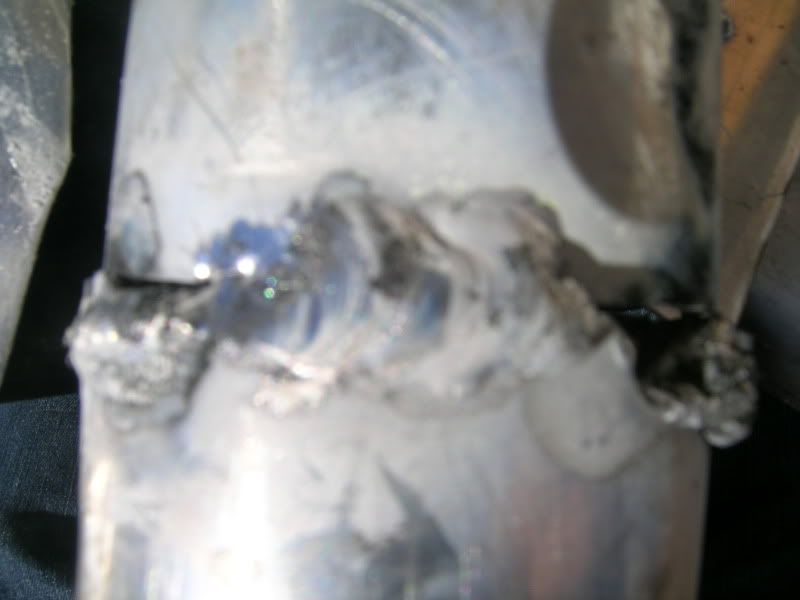

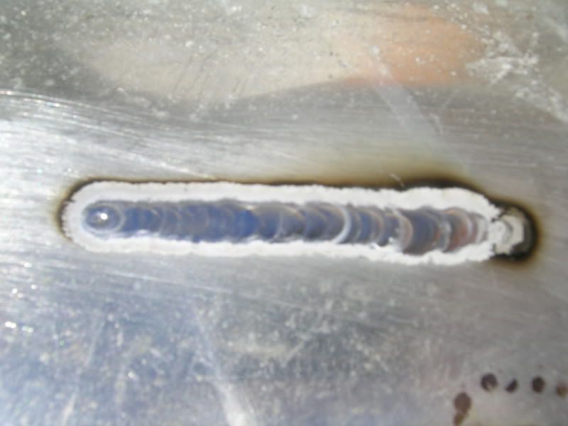

welp had a little time today and it was nice out so i decided to give another go at it.
did a couple butt welds. still needs some practice.
then tried ONE thats 1 pass on some flat thin aluminum sheet.
heres the outcome. first and last try on flat aluminum sheet.
jetjock-thanks for the positivity throughout this whole thread. and the added vote of confidence there at the end.
---------- Post added at 04:07 PM ---------- Previous post was at 04:05 PM ----------
oh yeah this is the 2nd day of trying this welder out on aluminum and the 3rd try with any welder plugged into electricity.

jetjock;1677364 said:
OP: You'll have to get up early than that to fool some of us...
what????!!!!! hahahah i guess i should be flattered by that statement. both of these pics were taken by me today in the same 1 minute block. you can check up on my photobucket where i uploaded both pics. from the same camera. hahahahahaaha. wow!!!
---------- Post added at 05:36 PM ---------- Previous post was at 05:35 PM ----------
and i even have an eye witness. my next door neighbor was there watching me and trying it out for himself. cause he didnt believe me either.

Crack me up. I'm not saying you didn't do it. What I was referring to was none of it is welding. All we've seen so far is a couple of horrific butts (why would anyone even post those?) that are the result of either bad gear/parameters or someone who can't manipulate a tig torch. Since you claim to be so good at gas it can't be torch manipulation right?
And what's with the little bit of melt along the plate which, as I said, can be done with a car battery? I hope you're not planning on folks hitting you up for work after this fine display of arcin' and sparkin'.
None of it is welding Sparky. How's about showing us a fillet that looks anything like the melt? Even a butt would do. Not that pretty is important, something you should already know. They gotta be better than those sorry lookin' butts though.
Post up either of those coupons along with the model machine, how the surface was prepped, torch size, cup size, gas flow, polarity, and diameter/type of tungsten used. Or post a pic of the gear. And just for grins write your user name on the coupon because, you know, this is getting old...
