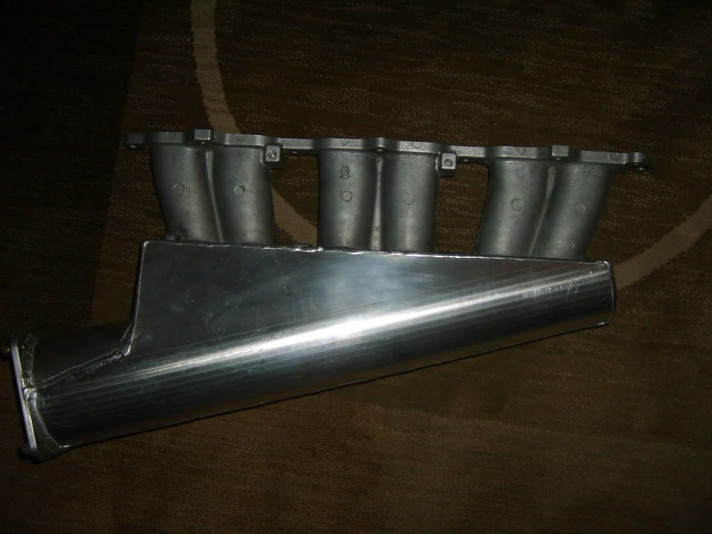

92nsx
Sep 30, 2005
2,957
Clearwater, MN
GrimJack;1035730 said:
Yes, this is required.
OOOOOO.... I see Ummmmmmmmmmm.... The FFIM I bought from tubbie only has the one hole for it (stamped out of it on the bottom) and no funnel like shape to it like the OEM on has. I can not find a pic of the bottom but here is a pic from the top to give you a idea what i am talking about.
Any Ideas on how to fix this??? cut the old upper intake manifold apart and some how get it welded to the now one.
