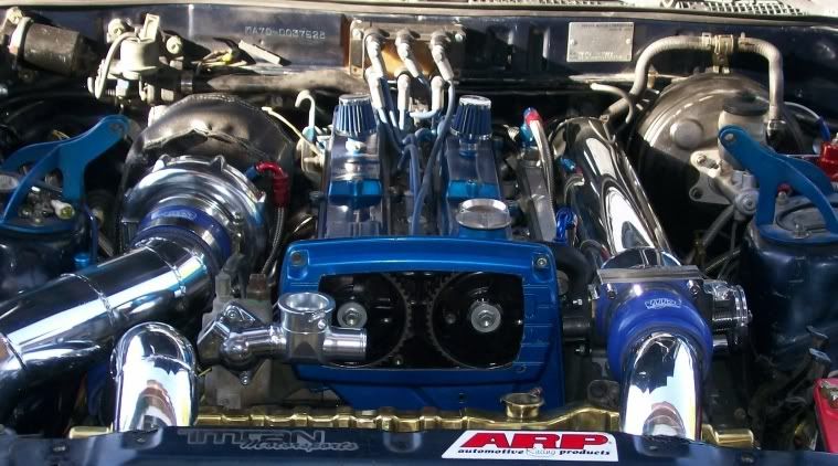

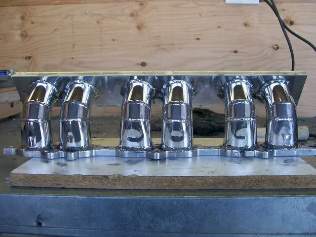

Not sure how far you guys have made it with the actual prototyping but from my experience you will not be able to fit the alternator above the A/C with the runners coming straight off the head. And when I say that, I mean not angled towards the center of the manifold like the stock runners currently do. Here is the one I built almost 2 years ago:
and
Here you can see with the alternator lowered to the max, actually sitting on the A/C it is still in the way of the #1 runner:
Just a heads up, I may be wrong and you may have already addressed this. But needless to say if looks like an extremely nice product. I will have my new style out the end of the month ;)
Seth

Kinda sorta like your pics ...We have a couple of options for the alternator, 1-relocate to where the A/C is and lose A/C or 2-damn close to what your doing, we have made a cast part that bolts to the engine and replaces the old bracket to drop the alt down.
The difference is or FFIM looks like it will sit slightly higher than yours, it has the same footprint as the stock or really close.
Because we are building it from flange out we are able to change the shape and direction of the runners.
I actually have not seen the pics of yours before and it looks like what we went after for fitment.
It's really tough to compare the parts from pics, once I can post up the new drawings of ours tommorrow I will put the fuel rail in there to show the placement, I think that will help show what I mean when I say kinda/sorta similar.

I actually designed an alternator drop bracket in SW that replaced the stock bracket and acheived the lowering but for me the cost vs over benefit just wasn't there. I have to have the shop next door CNC my parts that I want and it just isn't as economical as having inhouse CNC or casting abilities.
With the manifold being as long as it is with the runners coming straight out you really don't have much choice in fitment because you are really limited in the rear by the brake booster. My new design is going to be from the head flange up as well but the runners will be a good bit different then yours and obviously it will not be cast.
As you guys are working on I am also trying to get away from the whole core thing but also it is so tough to build them and make everyone happy!
But anyways you guys are doing a great job and building a great product. If you guys are interested in buying SW drawing for a short/meduim runner manifold with tapered design let me know ;) lol
