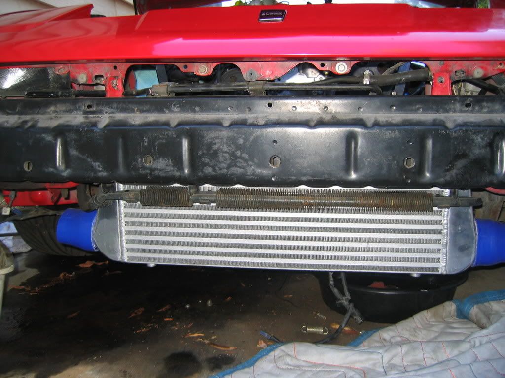

s383mmber1 said:
Its a universal kit, but is SO easy to install, and i think i only cut one MAYBE two pipes. VERY simple to do. If your doing a 1jz swap, making and intercooler fit should be like really simple. :)
Yeah, people really shouldn't be afraid of fitting an intercooler in. it's not that hard.
Mine was all custom work done by me. First time attempting something like this.
A little patience, and it worked out very well. Uses stock mounting locations, replaces the latch support, and PS cooler support. Doesn't have gay straps coming down from the top of the rad support like most installs I see. I've only welded a handful of times in my life too.
It's a 12x24x4" intercooler with HUGE end-tanks as you can see. Pretty much the most extreme size anyone would want to stick in this car.
Edit: one more picture of the support I made.

Tim said:
You can fit a custom intercooler no problem if you buy the right size. I bought mine from driftmotion and it fits great, and I was still able to keep the core support and hydrofan cooler. I am also using the 2.5" piping kit from Driftmotion that works great with the IC. I only had to remove my tow hooks so that my IC pipes wouldn't rub.
Mine was 4" WITH tow hooks AND hydro fan cooler ;)
I'm just messing with you, nice install. Except I see gay straps coming from the top of your rad support :)
