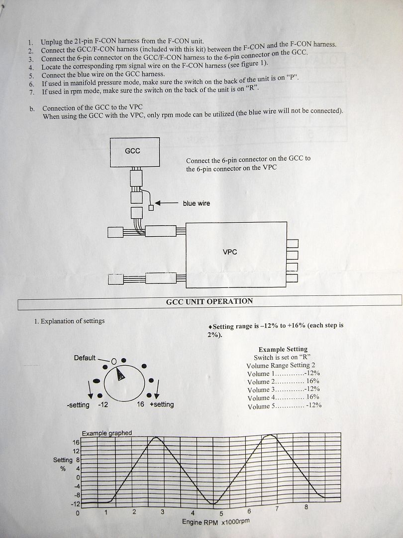

super51fan;1909663 said:

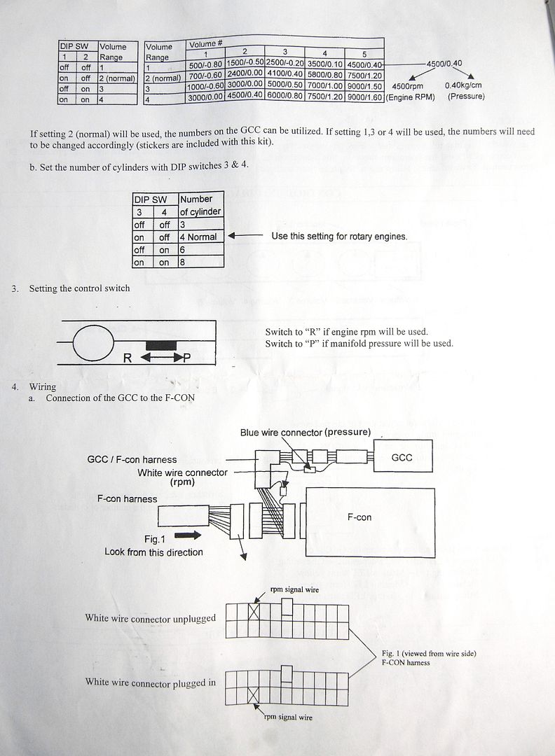

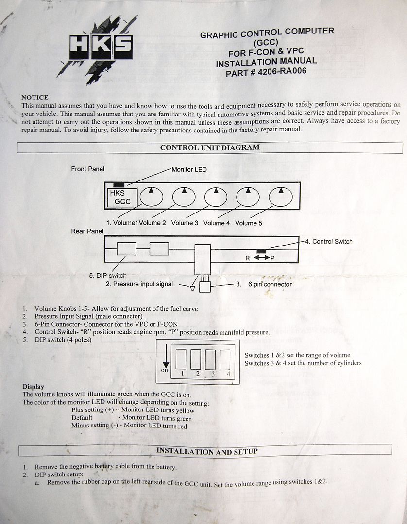

Hi thanks for the info. I missed how do you switch the GCC to boost reference instead of rpm. If you help i would really appreciate it.

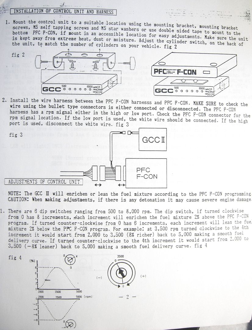

^^^ You need THIS UNIT to have the option for EITHER RPM -OR- BOOST trim points...

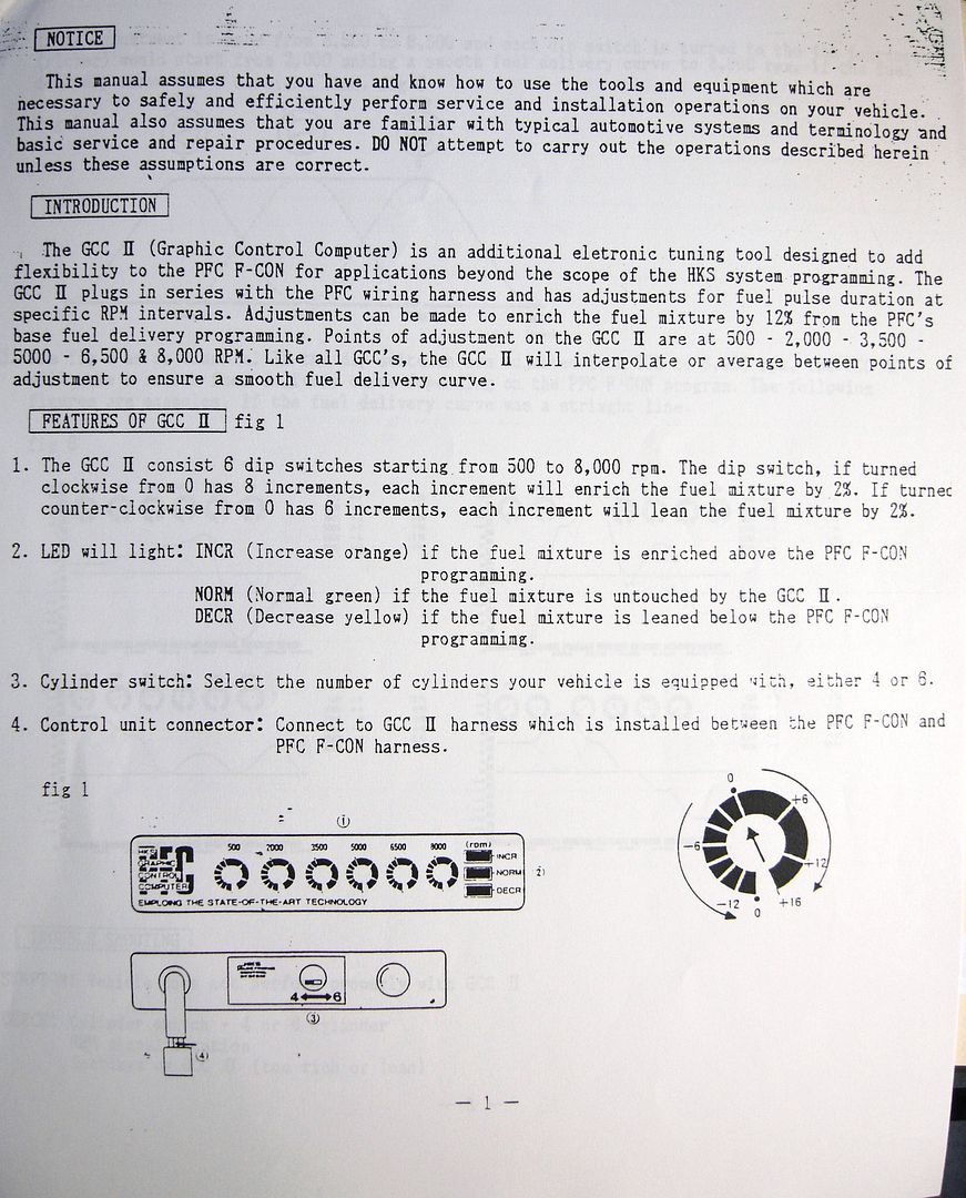

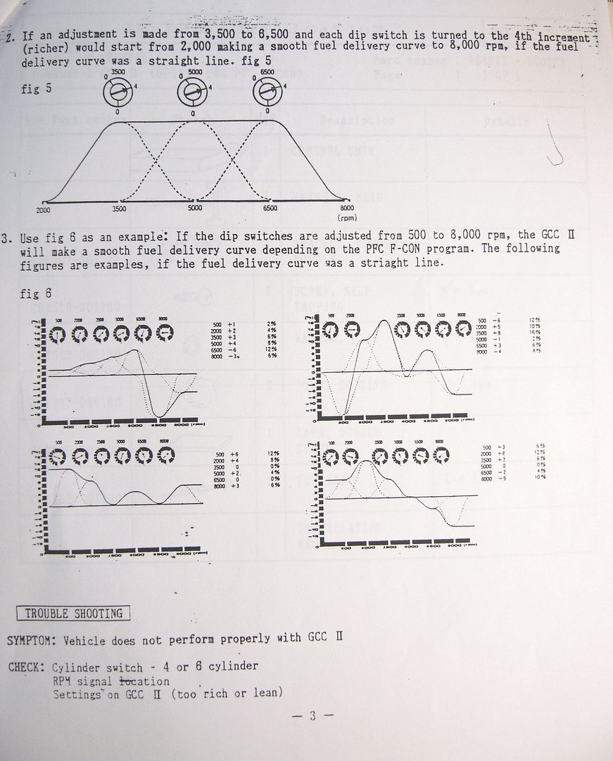

VVV ...on the other hand, THIS UNIT (Below) only has trim points for RPM adjust points.
I think you can see the details in the diagrams and the instructions to help you out IF you have the GCC unit on top. IF you have the GCCII below, you cannot make that adjustment. (To my knowledge.)
