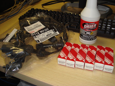

Picked these up today from Toyota:
- New Plugs
- New Wires
- BG Fuel System Dryer
My buddy at the parts dept. told to try the fuel dryer to lean out my gas to help with the NOx. Think I'll try half the bottel with a half tank of gas....not sure I want to run it all. Thoughts?

dude you went to toyota and bought plugs?!?!?!
we told you go to an auto parts store and get NGK or Denso Plats! (you bought the same thing in a fancy Toyota box)
you shouldn't keep trying Additives bud. :(

Depending on if he has a nice hookup at the dealer, the OEM plugs may have been cheaper than the parts store (mine where).

I'll bet (since it's "Dryer") that it contains alcohol...that will not help with NOx. Alcohol does burn hotter, exactly what you don't want to do where NOx is a problem. Besides, HC is what you failed on the 3rd test not NOx...so why are you worried about it?
You can use it...it will get your CAT nice and hot ;)
Make sure the plugs are gapped at 0.031" before you install them.
- New Plugs
- New Wires
http://lh4.ggpht.com/ForumAdminTalk/SO-GKF5kBMI/AAAAAAAAAS0/lcUzQoJxjCo/s400/DSC00831.JPG[IMG][/QUOTE]
You made the right choices. Autozone and Advance here both charge the same price on the NGK and Nippondenso plugs as the dealer.

Yeah, people yelled at me for buying plugs and wires from the dealer too...
Stock wires come with the looms while aftermarket is the same price and doesn't come with the looms and haven't been proven to be any better. Same with the plugs.
Now if you have a dealership with the 300% markup I've seen...
