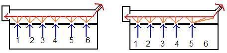

Quick drawing because i cant describe it good enough. i figure the coolant in the block is cooler then the coolant in the head because its further away from combustion and its iron so it doesn't conduct heat as fast either. If thats true then it would allow that cooler coolant in the block to rise into the head from the bottom of cylinder six to the top of cylinder six as it does for all the other cylinders.
Unless thats not how it would work or it already has been heated in the block to the point where it doesnt matter much.....

There's only a single hole being drilled for #6 right at the back the 2 ports on either side of #6 are already open.
Sorry I just can't see how drilling that hole will be of any benefit at all.
If someone can provide solid proof/evidence ie: 6 x egt probes or even a run on a dyno shooting the head with a laser temp gun I'll do it until then it's just another Supra Myth.. :nono: (nice drawing even if it's inaccurate)

Um yup, i just looked back at the post made by zooloo and now i see that i was thinking of it wrong. Its the smaller hole in the back not the holes on the side.
For some reason i was thinking about the holes on the sides of each cylinder being the ones that were drilled out.
for some reason this:
Looked like it was this:
I had a spell of confusion and made several posts in this thread completely about the wrong thing. Whoops. :3d_frown:
