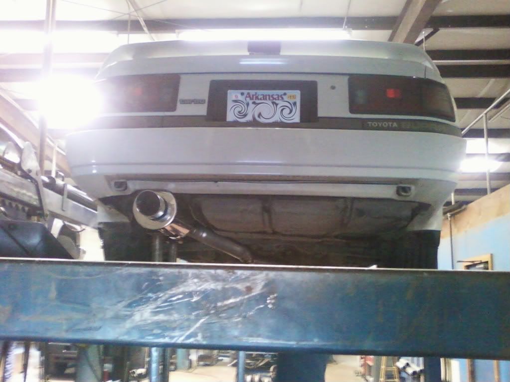

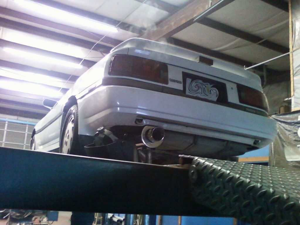

Heres how the new exhaust on my car looks.... Wish i had a camera or something to record video. all i have is phone so i dont even try since im going to get much b.s. of quality & idk if the sound will get the sound problem through.

It's probably the stock elbow doing it; in your sytem, exhaust gasses are expanding in two places now...once at the turbine (manifold -> 2.25) and again inside the downpipe (2.25 -> 3). Close proximity of the two is going to cause a sonic issue called a harmonic, where two sound waves of different frequencies combine, and where they both peak and trough at the same time, will cause the frequency of that condition (it will sound like a low octave of the exhaust note) to be pretty loud, causing your drone, not to mention turbulence from the second expansion.
The resonator will be a bandaid for now...any increase in boost pressure and even different flow levels in the exhaust will change the frequency of that harmonic, and possibly put it outside the range of what the resonator can eliminate. Going to a 3" elbow and downpipe (better: both in one) will fix it, as you're moving all of the gaseous expansion to the turbine; it'll also spool the turbo faster, as the gasses will escape the exhaust side of the turbo much faster.
