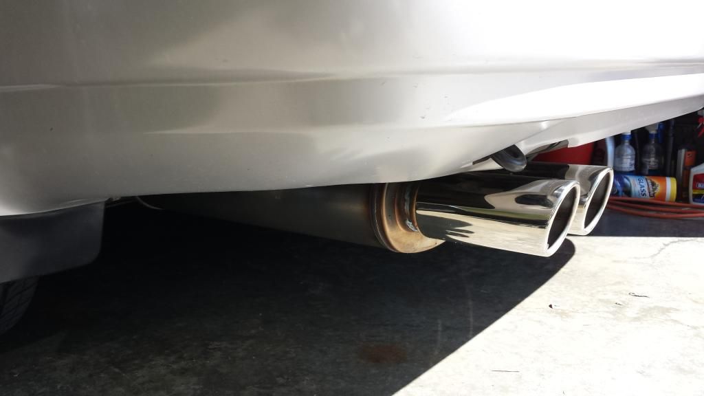

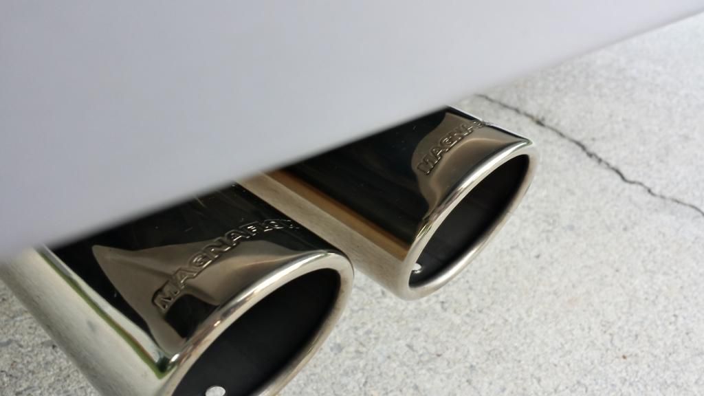

Sorry I never updated this to anyone that was following, and thanks to those that helped me with suggestions along the way. Here's a few videos and pictures of the finished system. I got this all put together in April, I just didn't have time to upload anything about it until now. Here's a few pictures of the exhaust.

It's not loud at all at idle, sounds basically stock. When revving it has a little more sound than stock, but not a whole lot, which is exactly what I wanted. It's a FlowMaster Hushpower II #12412400 as a resonator, Magnaflow single in/dual out #12251, and the tips are Magnaflow #35131. Everything is 2.25". I think it came out pretty good, especially considering I pieced everything together based off of hours of reading and watching videos of Supras and other cars with the same mufflers.
The guy who welded everything together wasn't too thrilled when I brought him a box of parts, but when I came to pick it up he said I did a great job selecting everything and it all fit in perfectly. I guess he has had issues with people just bringing him stuff assuming it will fit on their cars... It sounds so much better than the 27 year old rusting stuff that was in there. I was amazed it wasn't loud before with all the holes that were rusted through the top of the mufflers. I took the OEM parts home with me and it was like carrying two maracas they were so full of rust haha.
Thanks again for the help, and sorry it took so long. If anyone has any questions or whatever feel free to ask!

Thanks! I'm really happy with the way it came out. I was worried that it's be too loud, but I think it's perfect, just slightly louder than stock. I think the hushpower resonator makes a good bit of difference in the sound level along with the fact that I got the longest magnaflow that would fit on the car. I'm glad that someone wants their car to sound like mine haha. If you can do the bending and welding, or know a guy who can for cheap I believe the muffler and resonator were like $200 total so that's not too bad. But when you add $60 for the chrome tips and like $120 for the guy to weld it all up it gets kinda pricey.
The only issue I have with it is it kinda drones around 2200-2800rpm. It isn't really noticeable outside the car, mostly inside. It isn't really that bad, but I'd like to find a way to eventually reduce this. I've been thinking maybe some sound deadener would help, but I don't know that it would. I also thought about a branch resonator, but the guy who welded everything up for me didn't seem to knowledgeable about these when I stopped by and asked him about it.
