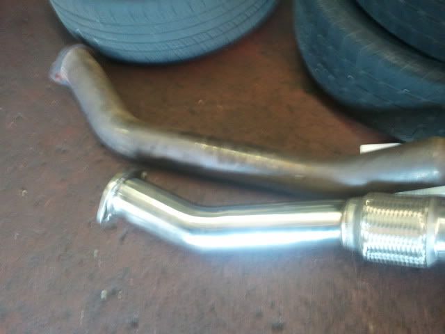

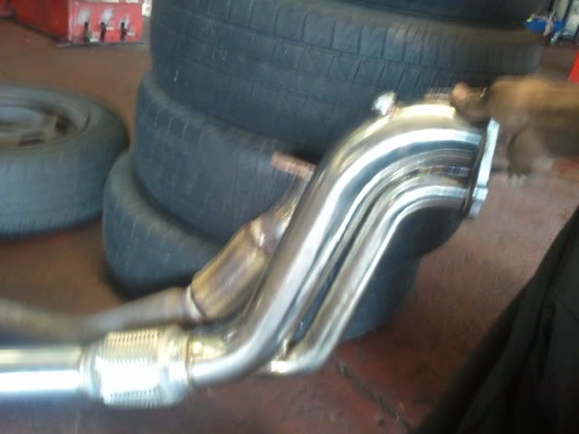

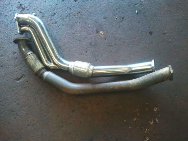

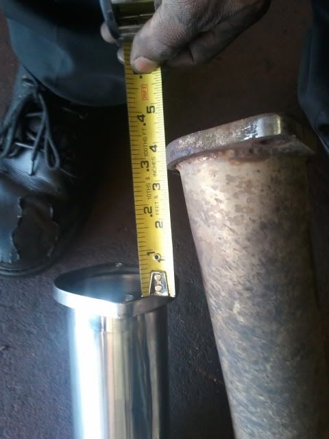

Long story short got a ebay down pipe and it didnt fit like the bends were wrong and it was too short Ill post up pics later but. The company said that it was for a rhd car. Im like wtf no? so now I gotta send it back and pay postage and time lost. Lets see if the zankou one fits well.

Chop it and extend it like 4-5 inches. After that looks like it fit a lot better.
Most of those Chinese cheap dp hang way to low. My 1j one is like 2inches of the ground. Super annoying on speed bumps.

Thanks for curing my ignorance in the matter sir, hadn't thought of that... was thinking more of the catback being the same. After seeing the pictures, that doesn't look like it's meant for a Mk3 at all... Mk2 maybe, like Poodles said, but I can't see that fitting a Mk3 without a bit of chopping and welding.
