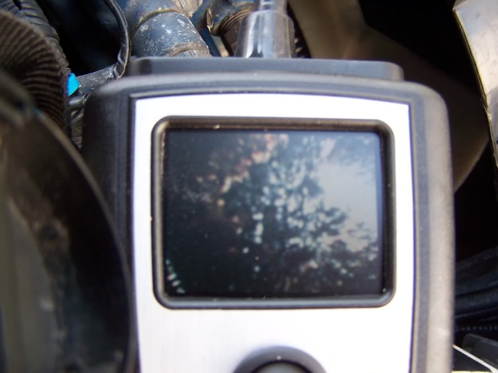

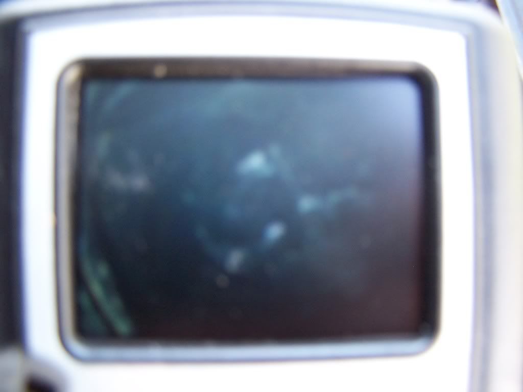

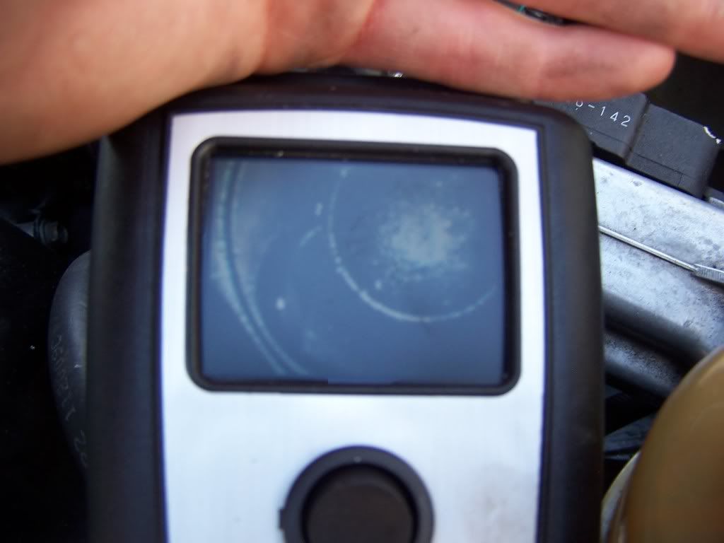

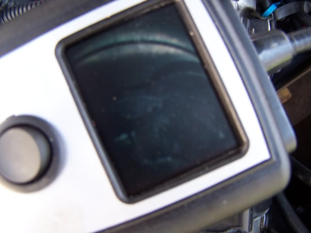

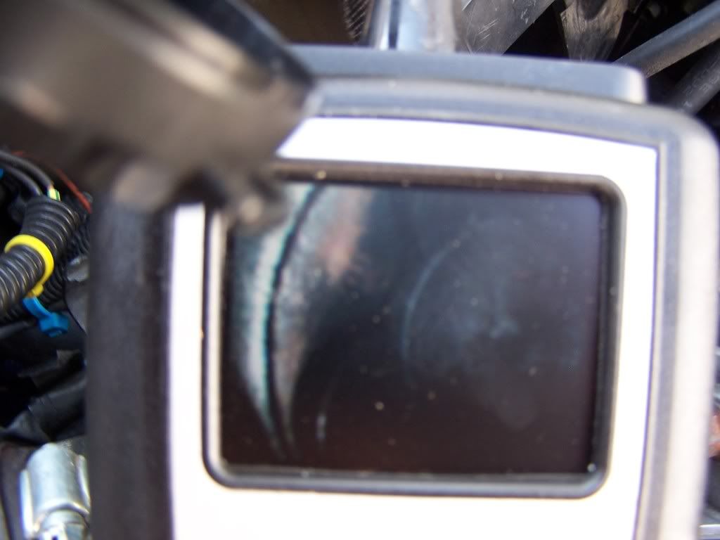

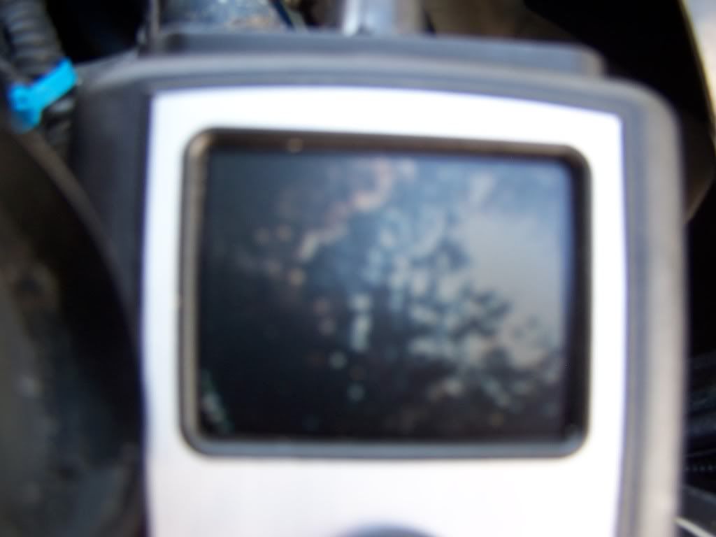

I also scoped the cylinders which i will upload pictures of shortly. my observations from the scope were as follows. cylinders 1,2,5,6 all looked similar. I could see the different heights on the pistons, there was dry carbon on the pistons with areas where the piston was clean. piston 2 had the most carbon. Cylinders 3 and 4 were both wet and appeared to have a thicker layer of carbon. This looked more like wet sludge than actually hardened carbon. Cylinder 3 especially looked bad. I have just put in the cylinder cleaner and will let it sit for a little bit. ill upload the bore scopes after my meeting with my professor about a school project.
edit: Just to point out I am not really looking for a solution, just kinda of documenting where the engine is and just getting opinions on anything that looks abnormal. At the end of the season, if the engine lasts that long, i will tear it down and inspect everything and update this thread again.
Borescope pictures
cylinder 1
cylinder 3
cylinder 3
cylinder 2
cylinder 5
cylinder6
Yes i realize they are terrible and just about useless but until i get a rca video card on my computer that is the best I can get.
