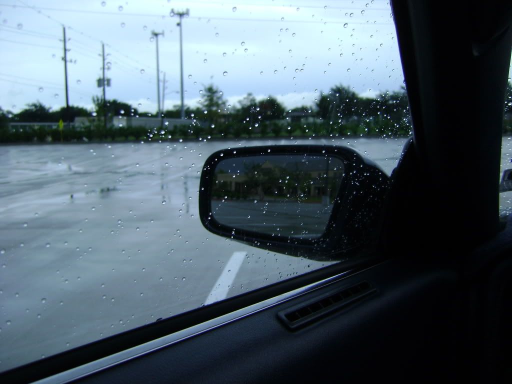

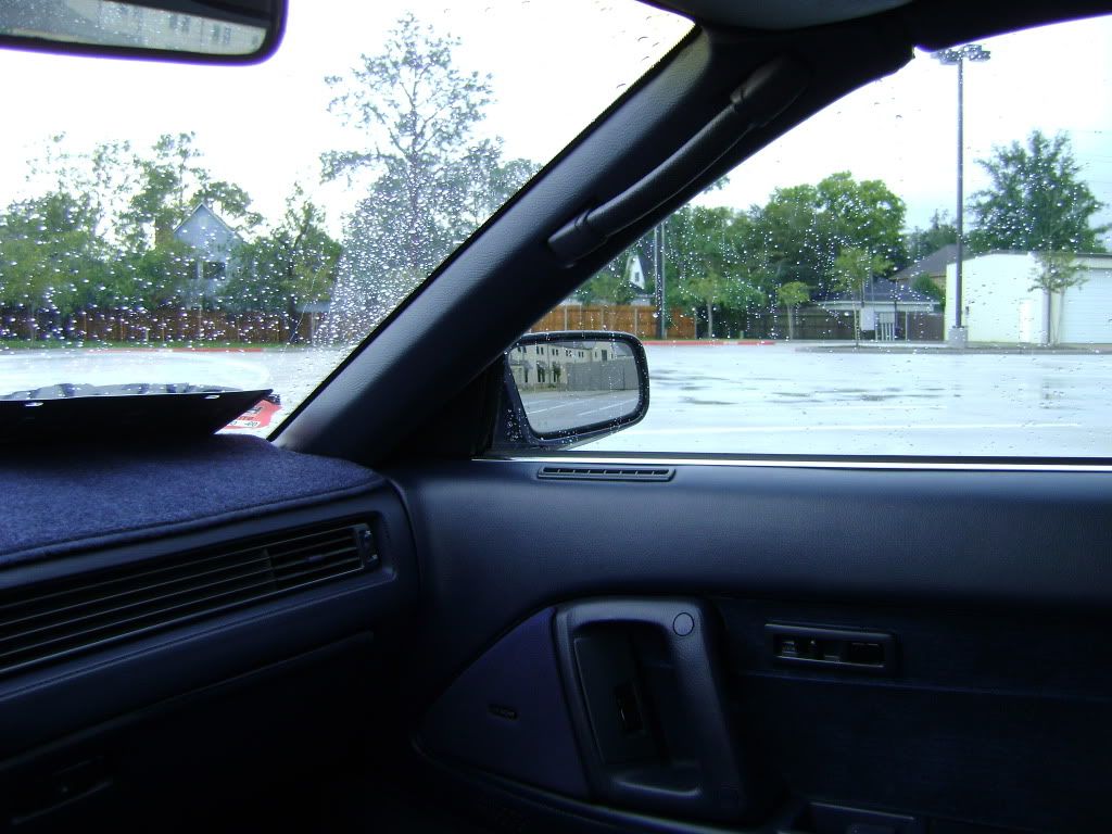

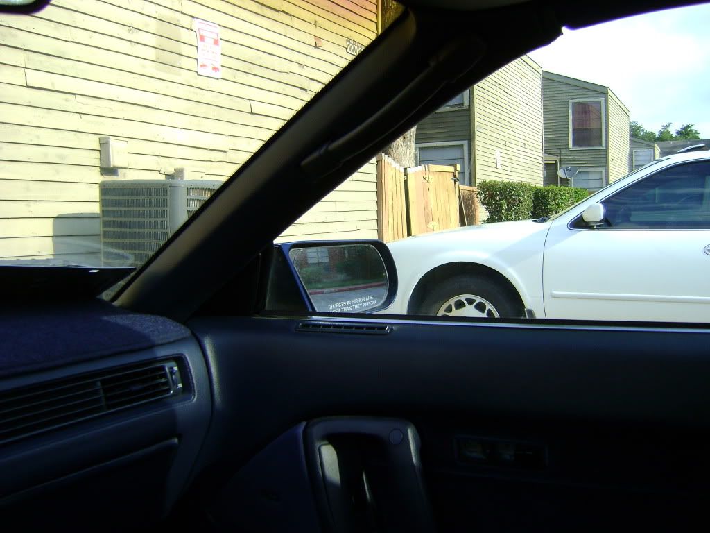

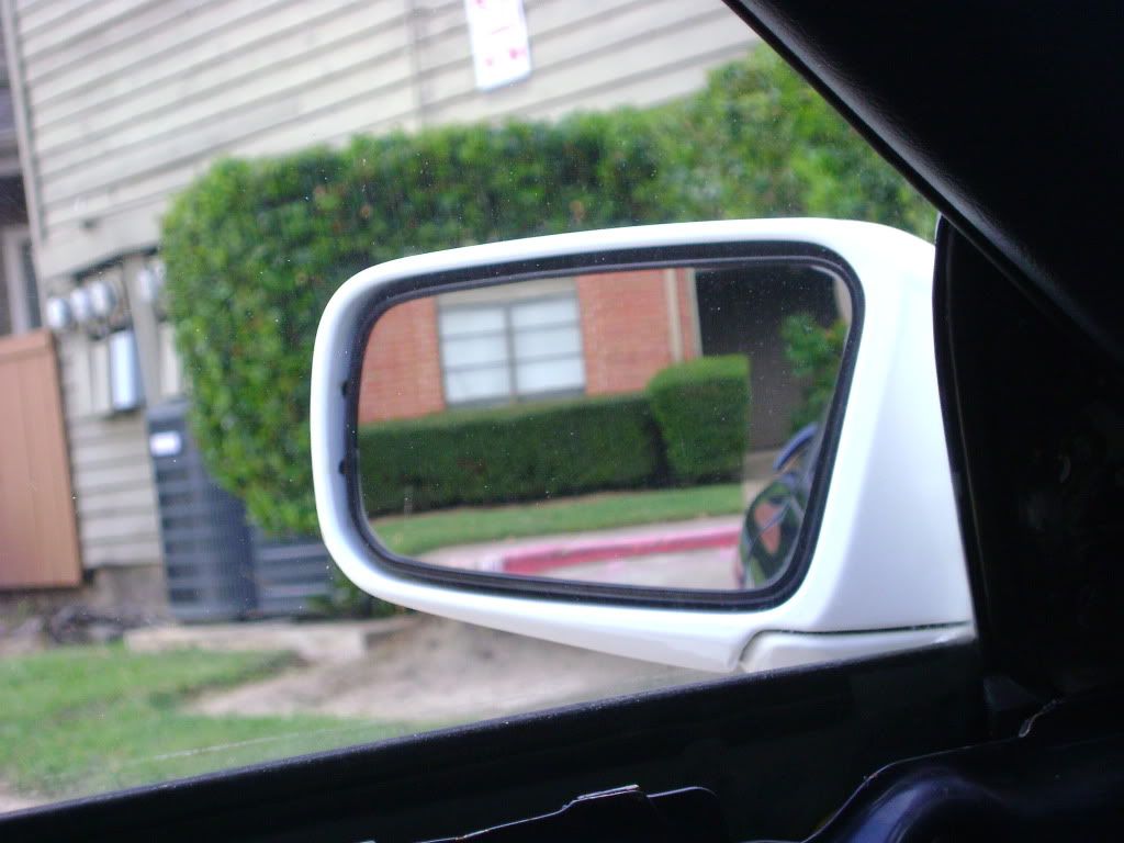

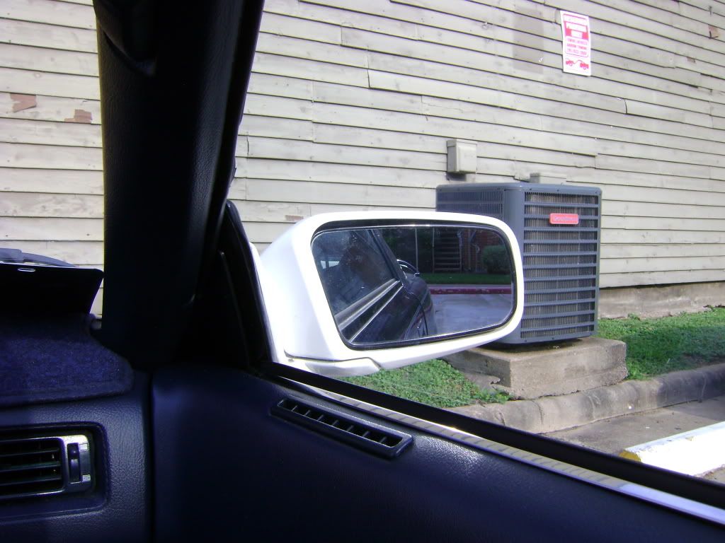

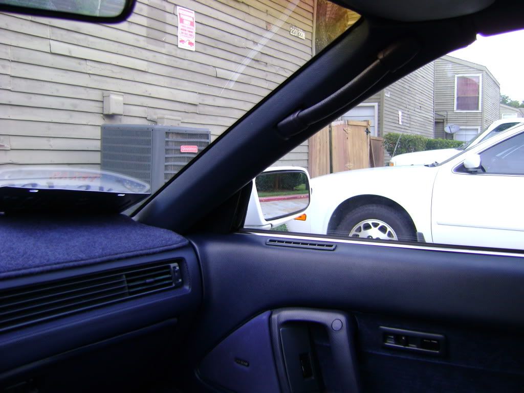

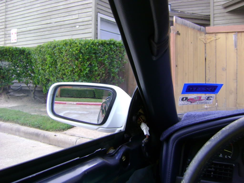

For future refrence Martin, before i start looking to see how i can change the angle. Heres what it looks like .
From the Passenger seat angled for RHD
From passenger seat looking at driver mirror
Leaning over from the passenger side
From the drivers seat angles for LHD
From Driver seat looking over at passenger side mirror
Leaning over from Driver seat looking at passenger mirror
So yeah im going to get cracking before i attempt driving around with my mirrors like this haha.

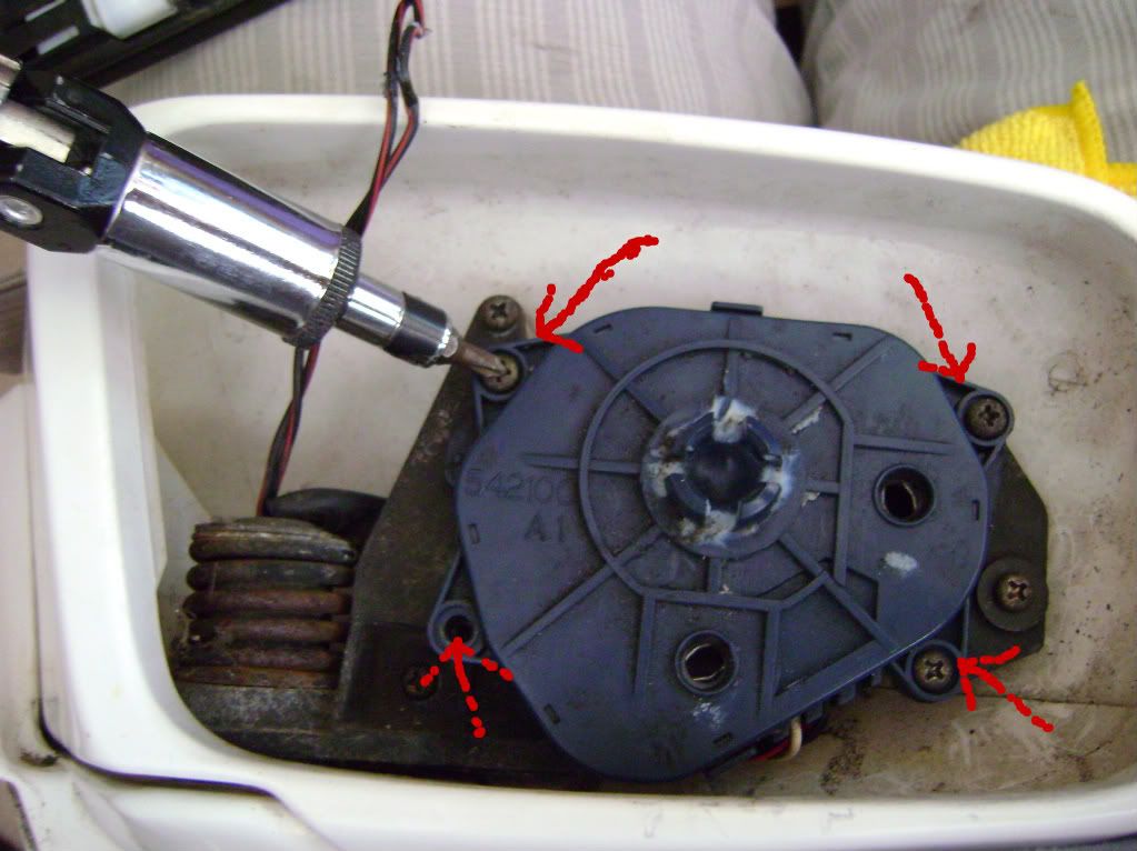

JDMMA70
Dec 4, 2006
2,550
Houston
staticpage;1391866 said:
I want to know how you shimmed it, I cant see any thing out my pass side. I thought about doing that on my 4hr drive home today but if you did it already and you can explain then you'll save me some investigating time.
Pop out the mirrors, all you need is a flat blade screw (wrapped in electrical tape) stick it underneath the mirror and pop it out. There are four screws holding the mirror motor onto the Pivot arm. I added washers underneath the mirror motor to angle it towards me more. Four total, two on each hole. I wouldnt do more than three washers each as the mirror will be sticking WAY out of the housing itself thus making it look really stupid. On the driver side i added 6 washers total 3 for each hole to angle them for my liking.

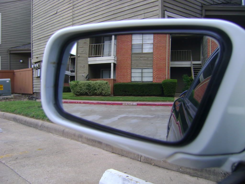

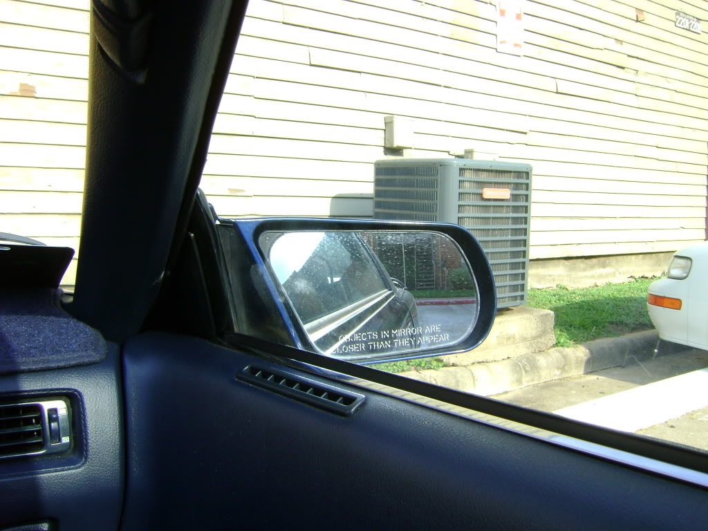

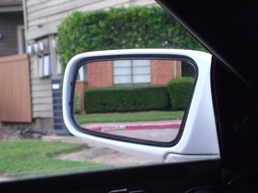

New pics from Shimming, only the passenger side for now. Im going to try reshimming the inside on the mirror instead of the outside. The goal is to get the mirror further from the car.
Before:
After:
Comparing to the stock mirror you can see there is a difference. However i do have the mirror in the same general area. SO far its something i can live with but of course i want to try and make it better.
but im making progress. Oh and you put the washers here. I put washers on the right side to raise it up so it would point more towards the car however im going to try putting them on the left as the goal to correct the angle is to move the mirror outward from the car and not inward.

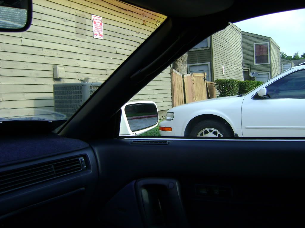

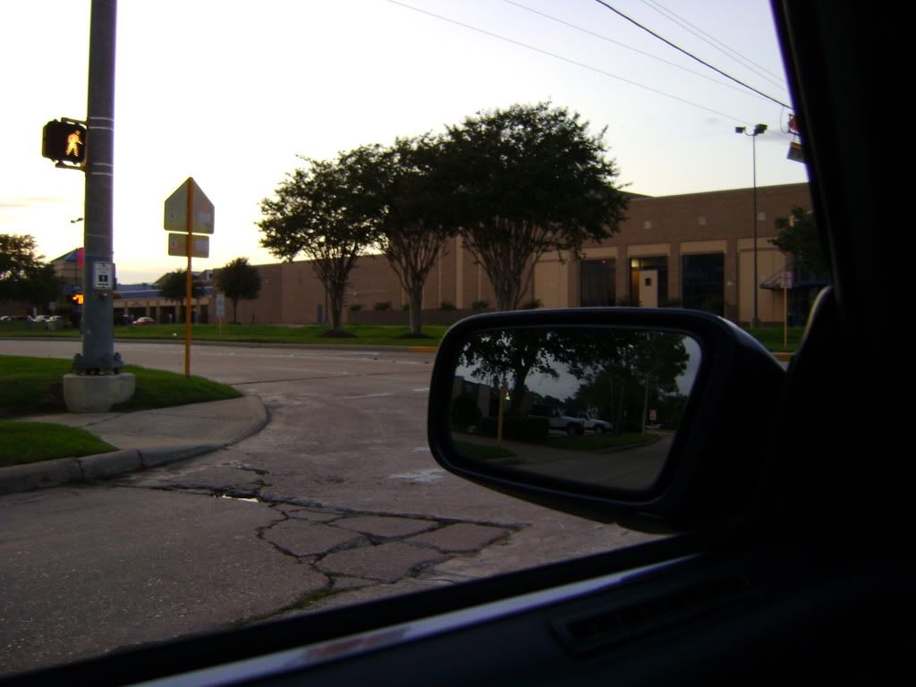

Ok i know its been a while but i just wanted to update. I have since given up on trying to make the RHD mirrors work for me, some people got used to them i was one of the few that just couldnt. I ended up getting a LHD Set. Here are comparison pictures and in my opinion much much better.
and another driver side shot.
