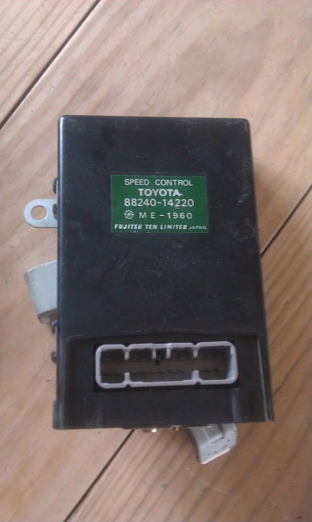

You talking about one of these ;) Toyota only wants $432 for a new one , ROFL. It is barred up under the dash drivers side. Looks like they show 4 different part numbers on EPC.

That's not *quite* what I need. The computer I have should be fine, but there's a separate relay under the dash that's also for cruise control. I'll have to hunt for a picture/diagram...

Umm.... I might have that, I would have to take another look. Only reason I feel I would have it is I removed "everything" from the left side of the car. I just left some of the "stuff" in it on the right side (a/c stuff IIRC). Looks to be small box, 1/4 the size of what I had a pic of. umm...............

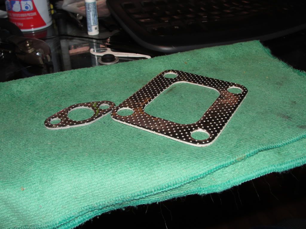

So the school year is over, and I have some free time to work on the car for once. So just as luck would have it, I'm sick. All my things are completely moved down to Stillwater however, so I can get to work making BOTH cars work correctly. My attention is currently on the White Car and its exhaust leak.
These are all brand-new gaskets from Champion Toyota, but it seems that the Exhaust Manifold gasket is the not-so-nice style that Steve warned me about. The one that was on there isn't in good shape at all, but I'm not sure if I want to take the gamble with this gasket or try to find a better one, if a better one even exsists. One thing I can say though, is that the Toyota Manifold/Turbo and Turbo/Exhaust gaskets are WAY better than the SupraSport ones - they're a joke!

Emilio! That exhaust gasket is the kind you want!
I stand corrected! Bolting on in 3...2...1...
My exhaust manifold situation was a little sad too - about 4 of them are bolts since the studs stripped out, and two of the studs came out with their respective nuts when I removed them. Such is the life of a 7M I guess.
