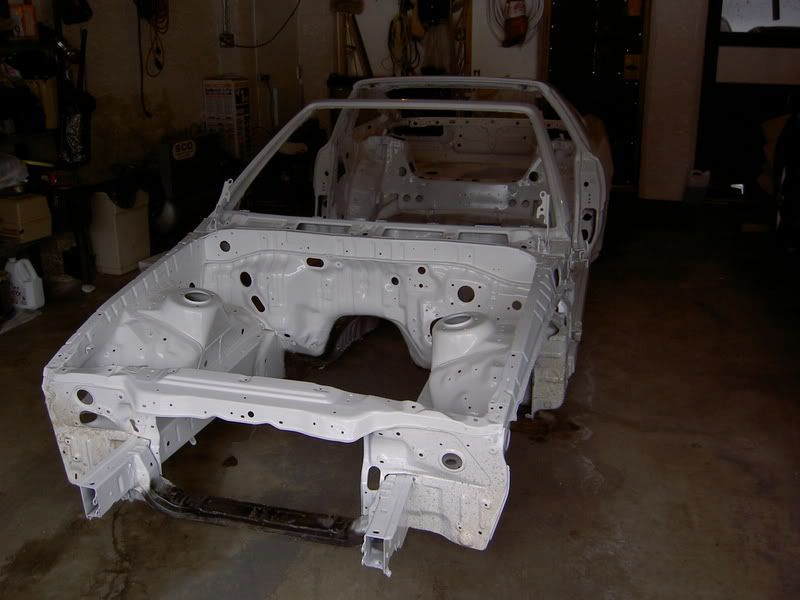

A clean motor/engine bay is a happy one
how is this to start from?
